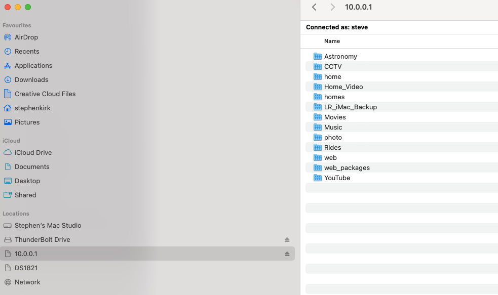

I have my MAC studio connected to the general home network and Internet with wifi 6E. I also connect a 10G point to point link with static IP address to my NAS. This works OK. However, sometimes I find the MAC uses the 1G link and not the 10G link.
MAC 10.0.0.1 -------- 10.0.0.2 NAS [shared volumes]
So finder can "see" these drives via two ways - via a network search on the wifi (which shows up at DS1821 in the image below) and also on the 10G interface. The NAS also has a 1G interface connected to my general network for other reasons. I only need the 10G link for high speed file access from the MAC studio for editing directly on the NAS. I still want to be able to access the files from other computers on the NAS' 1G link.
How can I configure the MAC studio to only access the NAS volumes over the 10G link please? How would I turn off thew MAC studio from finding (and showing) the DS1821 as an option in finder?

To be honest, I'm a little confused by the screenshot. 10.0.0.1 seems to be the 10G NAS ip address. But, just above the screenshot you are saying that 10.0.0.1 is the Mac's address. Sorry if I'm being dense.
Hi, thanks for your thoughts. Sorry - I've edited the post above to (hopefully) make more sense.
10.0.0.1 is the NAS over the 10G link and the NAS IP address is reported as the drive (10.0.0.1) in finder.

Why NAS need to be discoverable on 1G network if using static IP? Other clients could connect to shares using 1G static IP address without need mDNS enabled on NAS. Then Studio connect to two different IP addresses (1G address and 10G address) for shares. To Studio it would be like connecting to two different file share servers. Just thinking…
My understanding is the NAS has two network interfaces. The one configured with the address 10.0.0.1 is connected directly to your Studio. The other interface is connected to some router or switch which your studio (via WiFi) and other devices have access to.
Unless you've taken steps to configure bonjour specially on your NAS, I suspect it's advertising the DS1821 name on both interfaces. It could be that the DS1821 name is actually resolving to 10.0.0.1 on the Studio machine. You can tell if you ping "DS1821.local". If that is the case, maybe your use of that name on the Studio is giving you the bandwidth you want already.

I'd like to confirm that. @kirkster501, did you configure the NAS to only broadcast the DS1821 name on one of its two interfaces?
Run
dns-sd -G v4 DS1821.local
If you see both ip addresses of the NAS, then the NAS is broadcasting the DS1821.local name on both interfaces.
Run
ping DS1821.local
If the result shows you are hitting 10.0.0.1, then the whole problem disappears.
