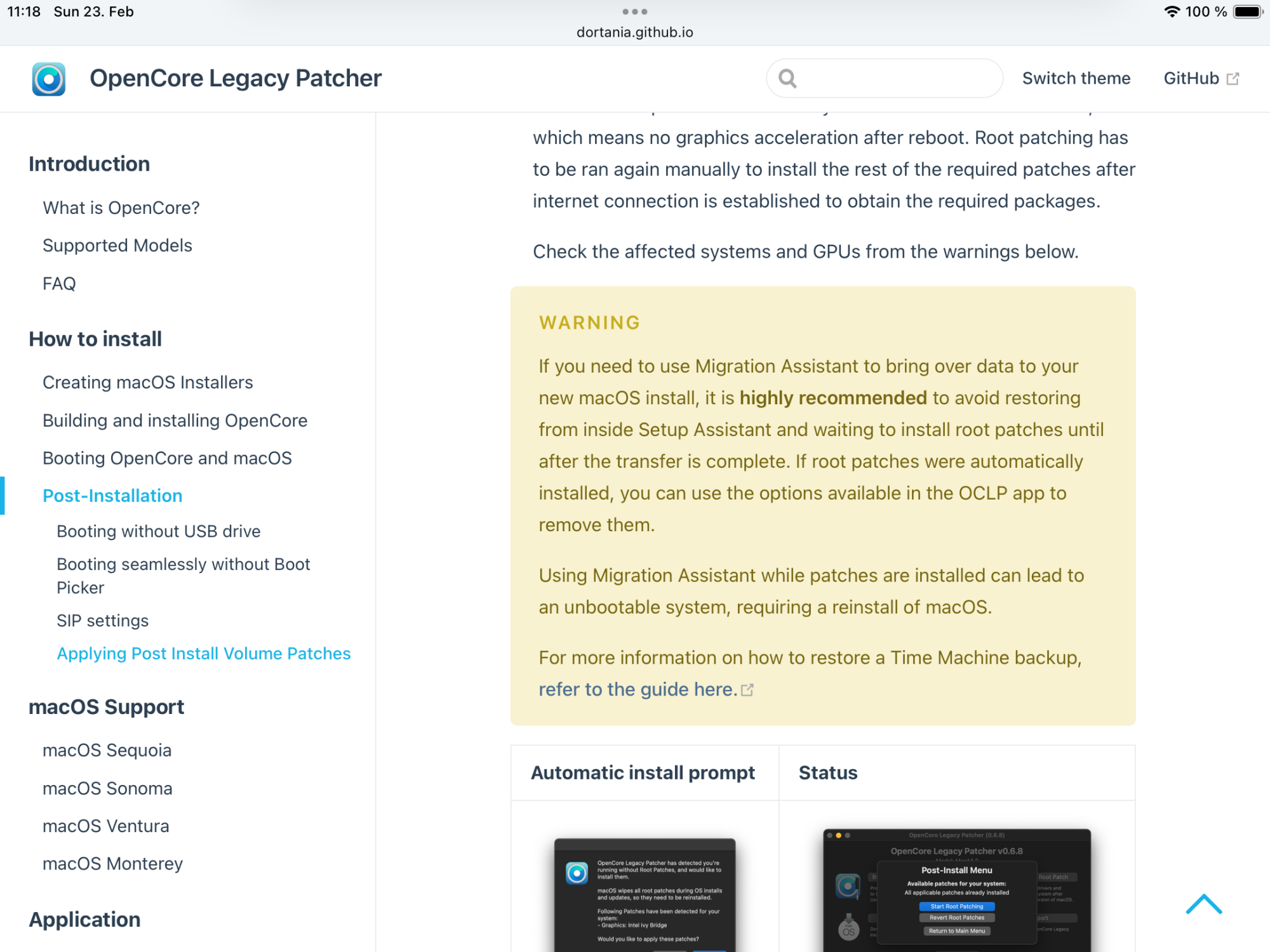

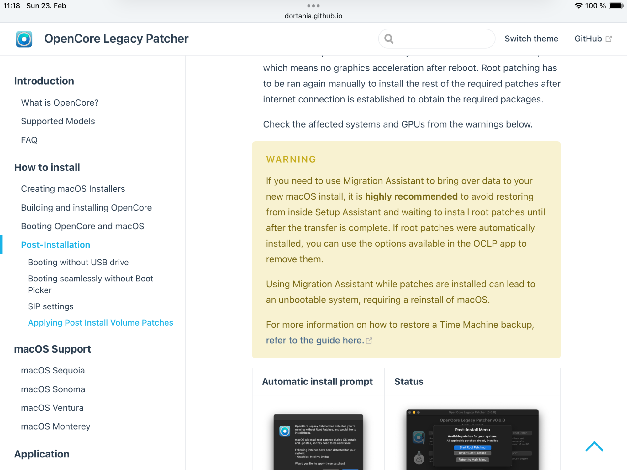

You're overthinking this - it's going to work fine. Just expect a half dozen reboots or so during the installation.
If Migration Assistant gives you trouble, erase the new SSD and clone your HD across. Then install Sequoia again on top of the clone.
Does "cloning" require a special process? Can it be done by simply copying everything from the HDD running Catalina over to the erased SSD?
If Migration fails, revert the root patches.
And also, rtf… ;-)
Thanks for that. I did read the OCLP docs when installing Monterey, and that note would have saved me two days of headaches. Pretty sure it wasn't there at the time. I even searched the bug reports - mentions of Migration Assistant problems, but no good answers. Cloning in advance avoided the problem, so I never returned to it. Figured it would be fixed by now.
I use SuperDuper, but there are other clone apps, like CarbonCopyCloner. Even Disk Utility can do it with the Restore command - sometimes. I've had erratic results using DU for cloning.
