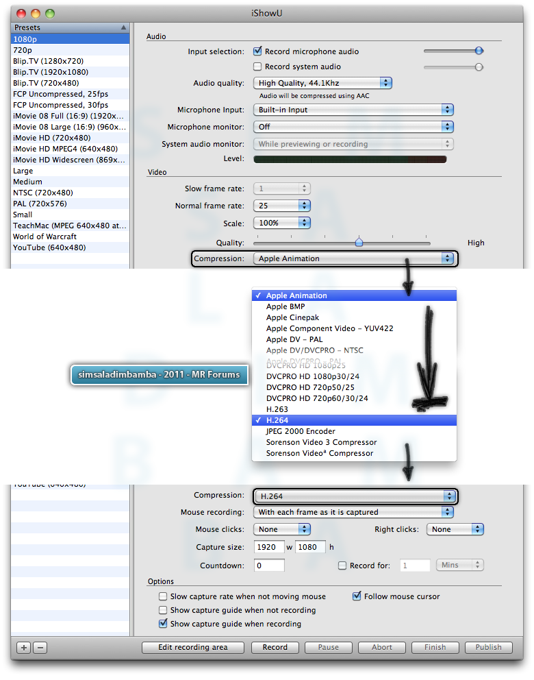

I don't know iShowU, but if you get a .mov file using the Animation codec out of it, you can use HandBrake to open that .mov file and use the Apple TV preset in HandBrake and create a new .mp4 file.
The same applies to MPEG Streamclip, but as it has no presets, you have to manually set some parameters, thus HandBrake might be the better option for you.
PS: I just tried iShowU and you can select H.264 as "Compression".
thanks so much, this is very helpful ! so for capturing web tutorials via iShowU, where quality doesn't have to be perfect, H.264 would make more sense than Apple Animation, and would result in much smaller files - correct?
and I'd be able to watch the H.264 videos on my mac without further processing - correct?
if I wanted to edit the video using FCPexpress to clip out some lessons I don't need out of the middle of the capture, I would need to convert the H.264 file to some other format - correct?
Yes.
Yes, via QuickTime Player.

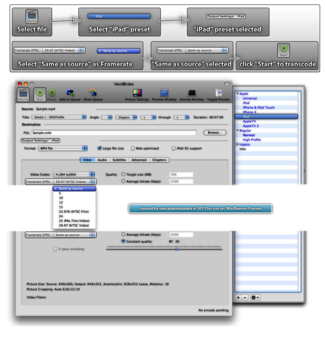

One more question... I'd like to transfer some of these tutorial videos to an iphone or ipad. I suppose I can figure out how to use Dropbox to transfer them.
What format should the video be so that I can watch it on a iphone or ipad?
Here is where HandBrake comes in handy:
Click the graphic to see, what settings you have to use.
Btw, you can use iTunes to add media to the iPad, maybe have a look at the iPad User Guide (p. 24 Syncing with iTunes): http://manuals.info.apple.com/en_US/ipad_2_user_guide.pdf
