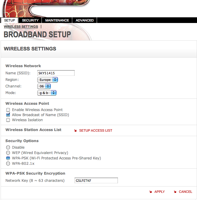

Hi again!
I see what you are saying (although i was actually able to access both routers whilst they were on the Lan at the same time...)
So next stage is to flash the firmware of the router, so I really need to find out the model (as it gave me a sky page it only seemed to have MAC address etc. (I have attached screen grab of what it had)).
By the way my main router is a DIR-615 funning firmware 1.00VG Wirless N.
Hey thanks again for your time:)

Doesn't look too hopeful for WDS.
The D-Link DI-615 doesn't appear to support WDS.
And the Netgear seems to be a Netgear DG934G which is like a DG834G, which also seems not to support WDS.
Though for reflashing this site may help, though you would need to check it's the router you have.
Might want to look into purchasing a Wireless Repeater instead,
or even a cheap wireless router with an ethernet WAN port and a long ethernet cable.
