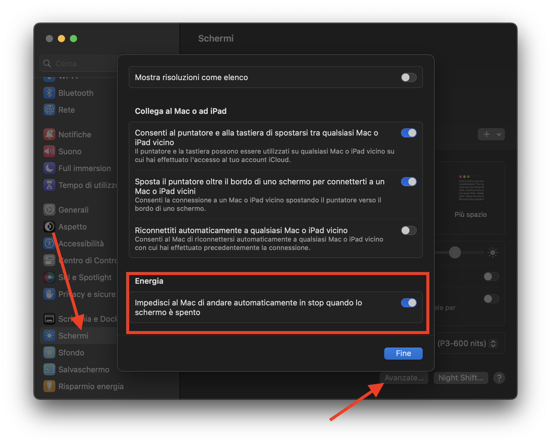

Looking at my trashcan mac pro running Catalina, the energy saver screen clearly gives the option of preventing the computer from sleeping when the display is off, but this option does not appear on my Mac Studio with Ventura... Why did they remove this option or am I just looking in the wrong place?
on MacOS Ventura is in another place:
