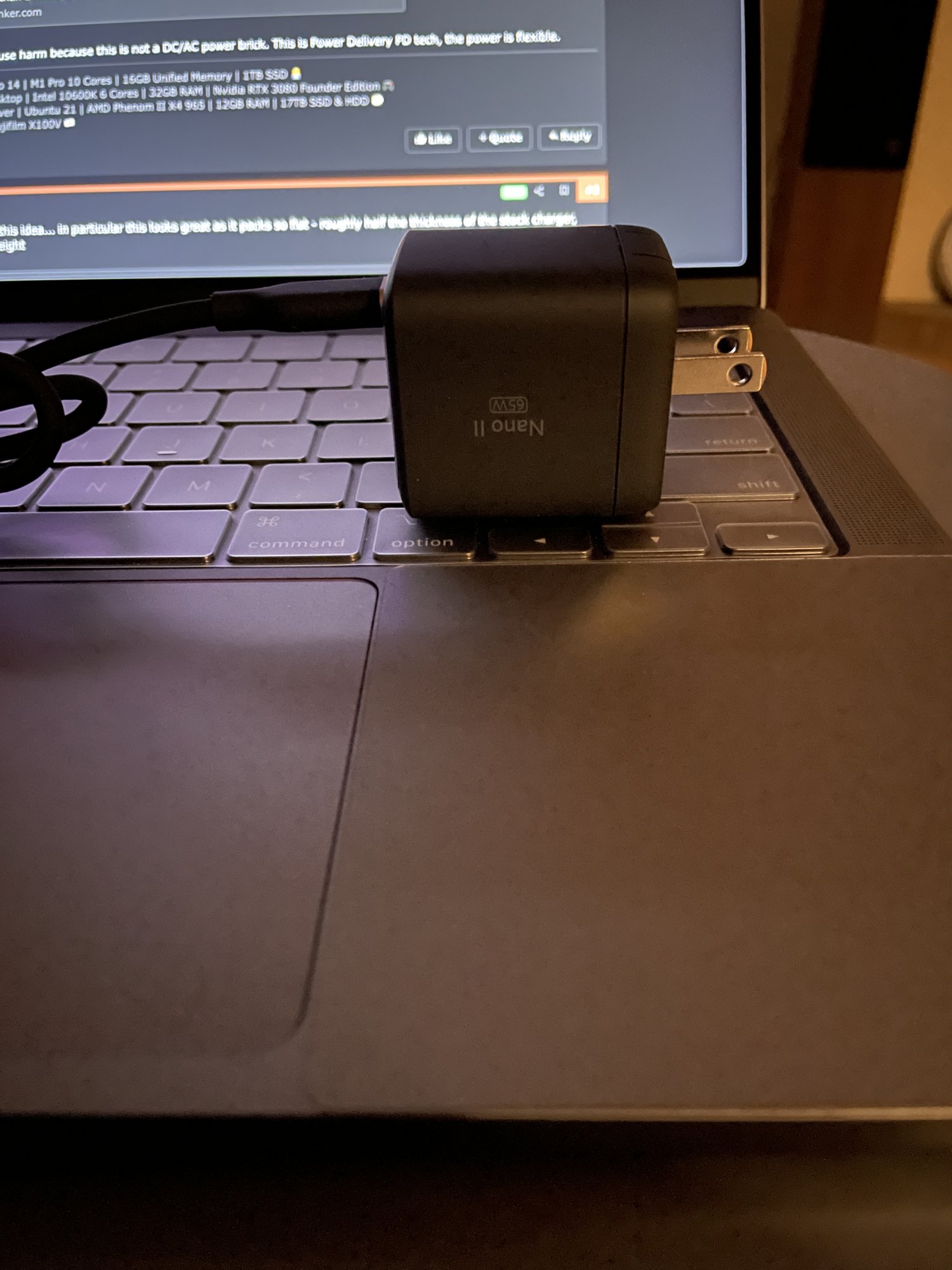

The Nano II only gets slightly warm charging the 14" MBP, same charging speed as the stock brick, and a lot smaller, it's a superb charger, and it's not white!

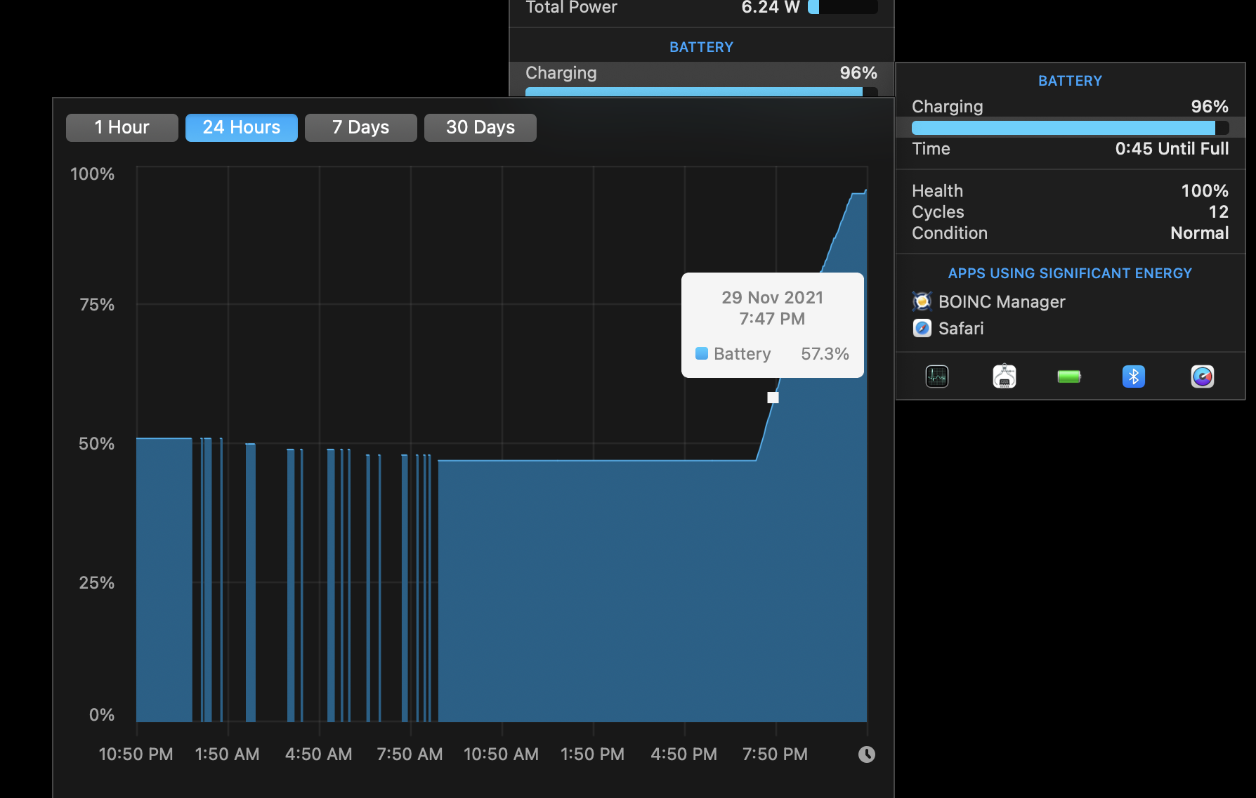

Tried using the iPad Pro 20W charger with the 14" M1 Max. Actually it works fine under light load. It charges at a rate of 10% every 30 minutes when I locked the Mac and with the battery level around 50%. It still charged the Mac when I was doing light work (email, YouTube, reading ebooks etc.). (BOINC was not running.)
