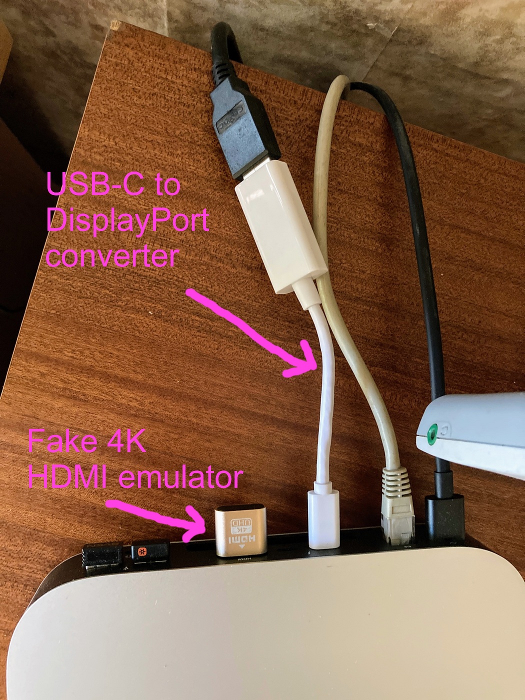

1. You need to buy any 4K HDMI EDID emulator on Amazon. It's a small device (like flash drive) which costs about 8..10 USD. This device should emulate 4K at 60p, check that a description contains word "EDID".
2. If your QuadHD monitor (2560 x 1440) has DisplayPort buy USB-C > DisplayPort converter.
Or if your monitor has HDMI buy USB-C > HDMI converter. I purchased VCOM CU422 USB-C to DisplayPort converter. It costs about 8 USD.
3. Connect your QuadHD monitor to USB-C > DisplayPort converter connected to your Mac. Make sure that it works as earlier (with non Retina resolutions).
4. Now connect dummy 4K HDMI EDID emulator to HDMI port of your Mac Mini.

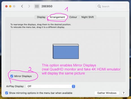

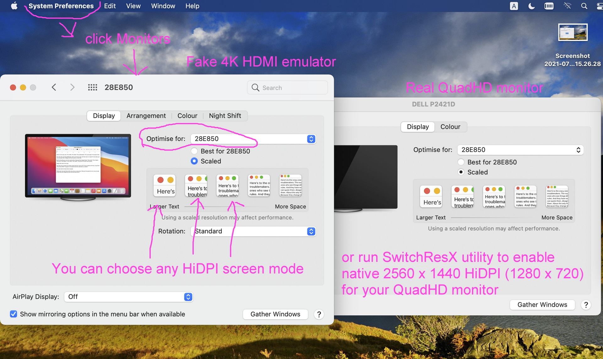

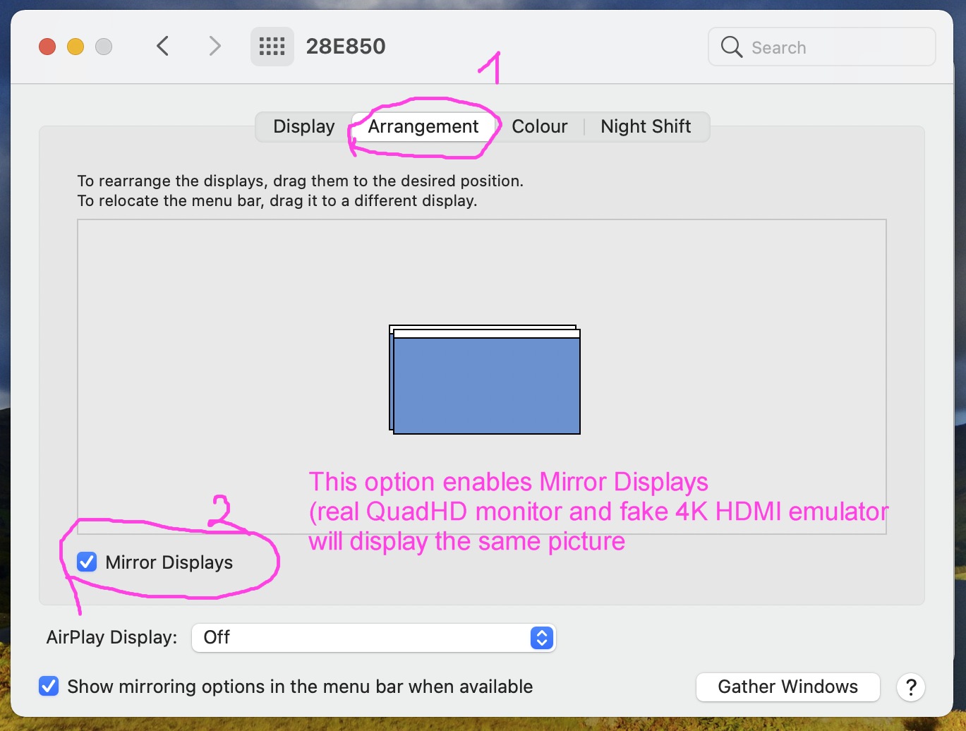

5. Open System Preferneces > Monitors. You'll see two pages for real QuadHD monitor and for dummy 4K monitor.
Click Arrangement tab. Then select Mirror Displays.
6. In Display tab choose Optimize for your dummy 4K monitor. In my case I see "82E850". It means that dummy 4K monitor will be primary and will mirror screen for your real QuadHD monitor.
7. Now for this dummy 4K monitor enable any scaled HiDPI resolution. I could enable
1152 x 648 (it means 2304 x 1296 in HiDPI),
1504 x 846 (3008 x 1692 in HiDPI)
1920 x 1080 (it's 4K)
Picture already looks much better than earlier.
8. Howerver we need to enable 1280 x 720 (2560 x 1440 in HiDPI) which looks native for this QuadHD monitor.
In System Preferences > Displays > Display tab. Switch "Resolution" to "Default for display". Now hold Option key and click "Scaled" option. You'll see a lot of scaled resolutions. Choose the best option for you.
Setting "1280 x 720" means HiDPI mode which is rendered at 2560 x 1440. Large fonts and sharp picture. It's native mode for your QuadHD display.

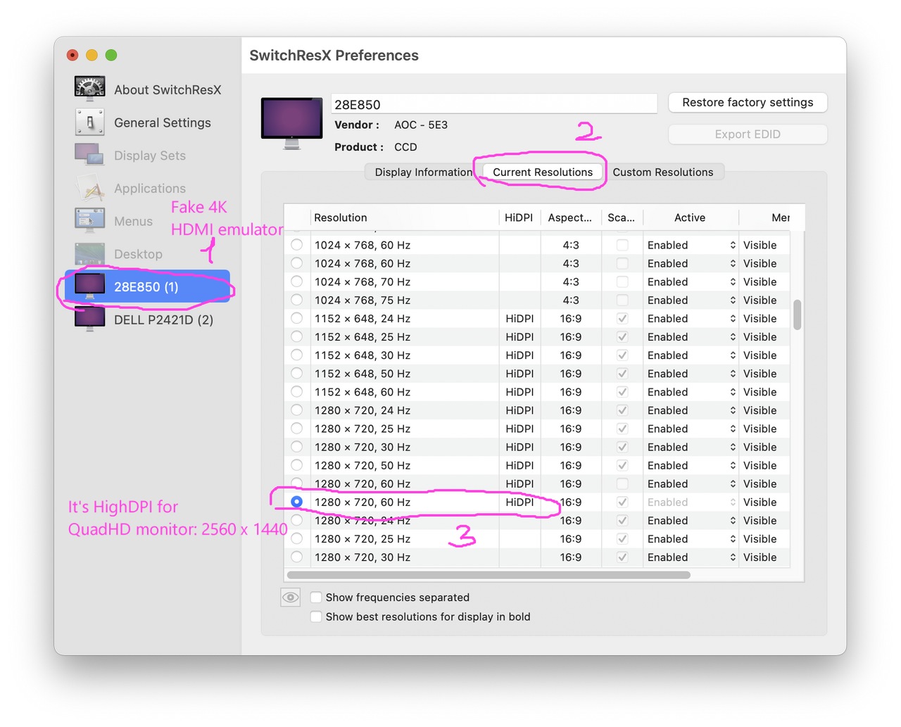

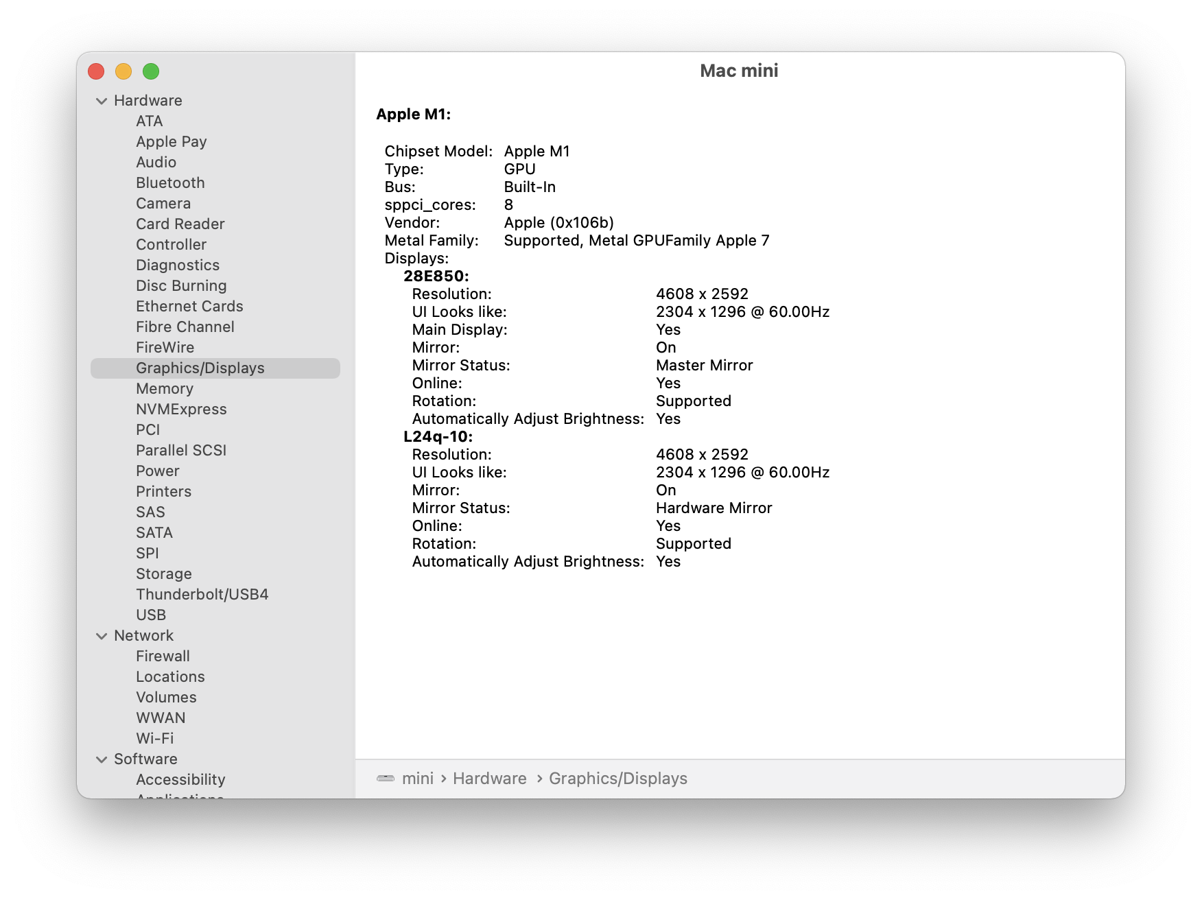

I am using this fix on my M1 Mac mini with a QHD display and HDMI dummy. I am running at For whatever reason the mouse pointer in the mirrored screen becomes glitchy sometimes - instead of moving smoothly it is vibrating slightly and is jerky. Does anybody else notice this behavior?
My setup is this (the 28E850 is the fake display):

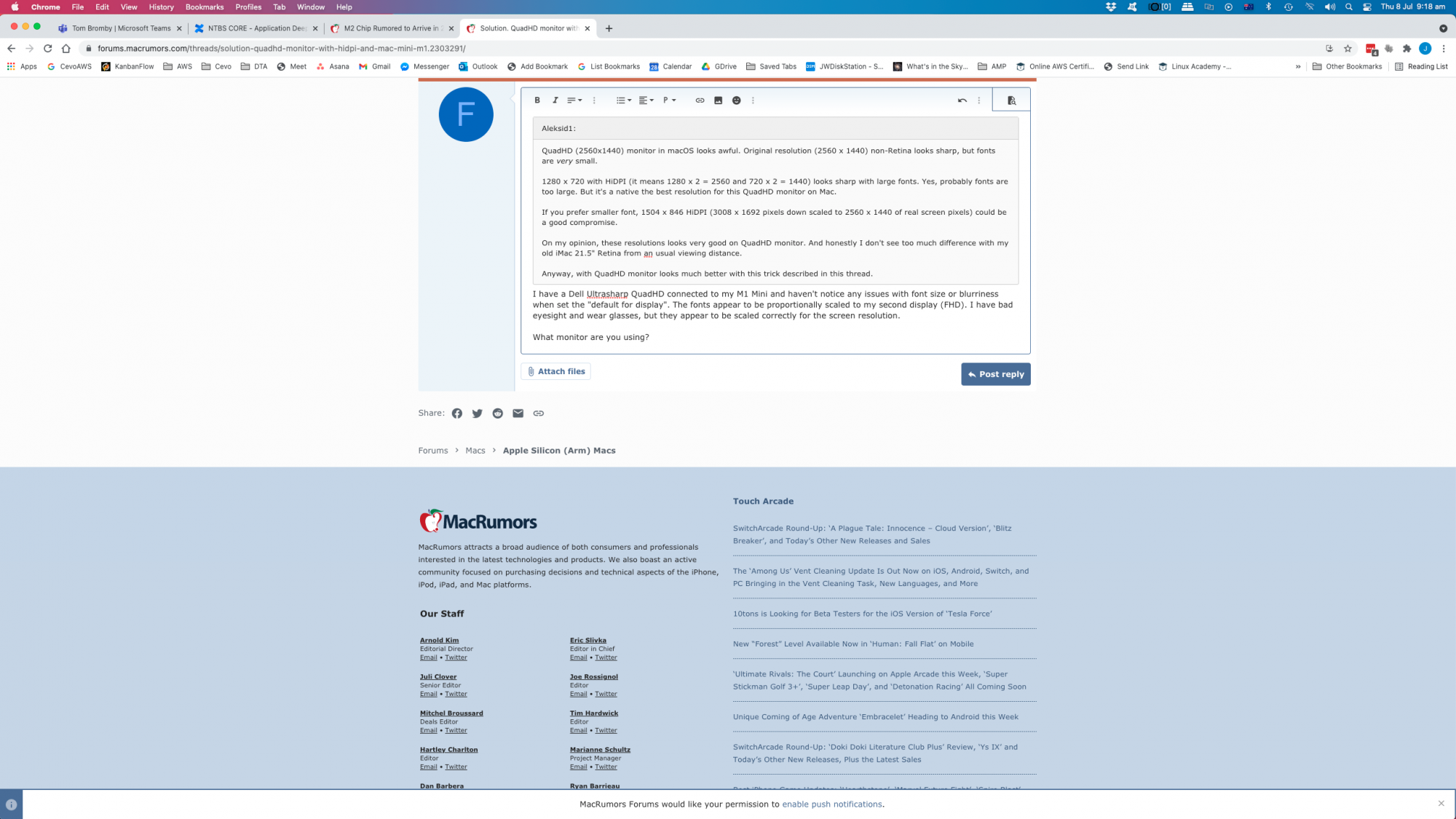

I have a Dell Ultrasharp QuadHD connected to my M1 Mini and haven't notice any issues with font size or blurriness when set the "default for display". The fonts appear to be proportionally scaled to my second display (FHD). I have bad eyesight and wear glasses, but they appear to be scaled correctly for the screen resolution.
What monitor are you using?
Here's a screen shot of this message so you can see the relative sizes of windows and text:

Looking at your screenshots, I guess that you set 2560 x 1440 non-Retina resolution. Picture is sharp, but fonts are very small.
My solution allows to set more large fonts in HiDPI modes, keeping relatively sharp picture.

I have a Samung 34" ultrawide monitor. I have the dummy and displayport adapter, but I can´t configure it for view entire screen... Someone knows how I could?
1. Choose dummy adapter as primary monitor.
2. Enable "Mirror Displays" mode
See screenshots above.
Reactions: azpirito
What native screen resolution of your Samsung 34" display? Probably this trick doesn't work for ultrawide displays.
