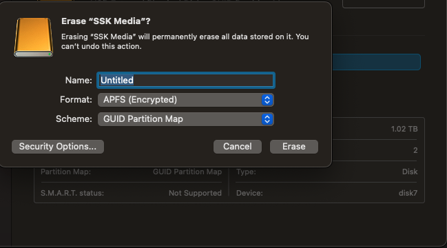

You can skip the disk image aspect and format the drive(s) in encrypted APFS.
(When APFS (Encrypted) is selected, Disk Utility will prompt you to choose a password and optional password hint.)
