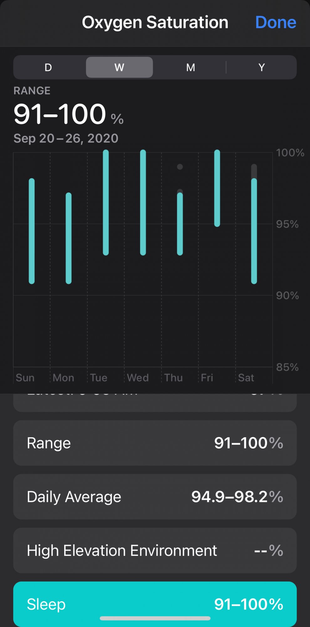

Is the AW 6's SpO2 sensor used at all to measure sleep tracking? I've been switching between an aluminum S4 and a stainless S6 but I'm not sure I'm seeing any difference in how sleep is measured.
If not, I'd likely opt for the S4 for sleep tracking since it's a bit lighter and less useful during the day without AOD. If there's some benefit to having SpO2 measured during sleep, then I'd drop back to the S4 during the day whenever the S6 needs charging.

SPO2 results won’t be found in the stock Sleep app. However, the separate SPO2 results can be used in conjunction with one’s sleep app results to give a better overall view of lung function during sleep and possibly help a doctor better diagnose one with possible sleep apnea or the early onset of COPD etc.

I think it is fairly accurate.
I use a CPAP, so my AHI** (apnea/hypopnea index) when using it is low. Like golf, lower is better. That means my airway is not restricted.
So w/CPAP usage my spO2 (according to AW6) is 95%-97%
This morning I woke up around 530 and went to the living room to watch early morning news and fell asleep w/o CPAP and for that hour it measured 92%
Which I think makes sense. Over the years I've lost weight and stopped snoring w/o CPAP so I don't think my AHI is super high w/o CPAP, but enough that there is some restriction...certainly not enough to drop my spO2 to moderate or severe sleep apnea levels like it was 10 years ago (Where my AHI was 80-90
