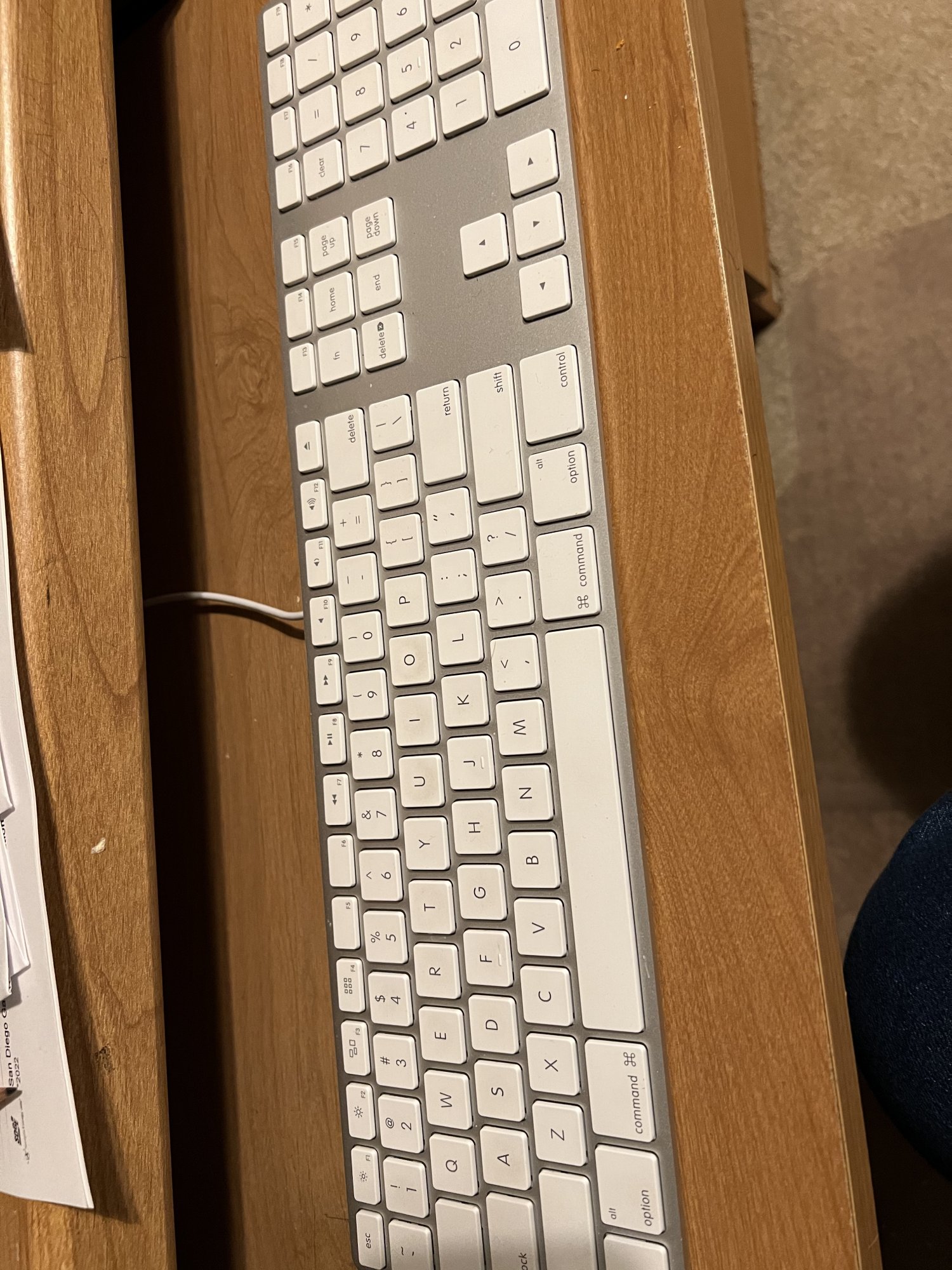

I have a Power Mac dual G5 (June 2004) running OS 10.5.8. I cut a new partition and installed Tiger 10.4.6 for a dual boot via firewire, since I could not boot into the install CD on the G5. The DVD player works fine. My plan is to run classic mode for some old games. The issue I am having is I cannot get any startup keys to work except for Target Disk Mode. The Option key just boots to the primary OS with no boot manager screen. I cannot reset pram, no response. I cannot boot into open firmware to reset nv-ram. I tried several good Apple keyboards. Startup Disk under 10.5 preferences shows the Tiger partition and the installation CD as bootable, but I'm afraid to try that because i haven't tested the Tiger OS and if it fails I may not be able to get back to 10.5? I checked the CMOS Battery and it's good at 3.65v. I pulled it and forced the power button to try and clear it. There is no firmware password set. Im at a loss. Any ideas out there?
What keyboard models are you trying? I've had the aluminum keyboards that came out in 2007+ not work on certain older Macs for startup keys.

The aluminum and the older plastic

I don't know about A1243 (aluminium?) but A1048 is compatible with G5 AFAIK?
