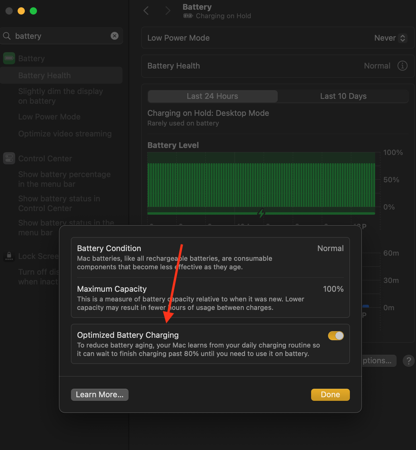

you have this option in system settings>battery>battery health...

That still wont stop charging. With the 3rd party apps you can set a specific limit. Apple’s optimized charging is fairly random but will eventually charge up the Mac fully.
of course, but the OP did worry about this (which is what i was addressing) -
"The Display permanently charges the MBPro up to 100%, which in my understanding is not very healthy for the battery."
