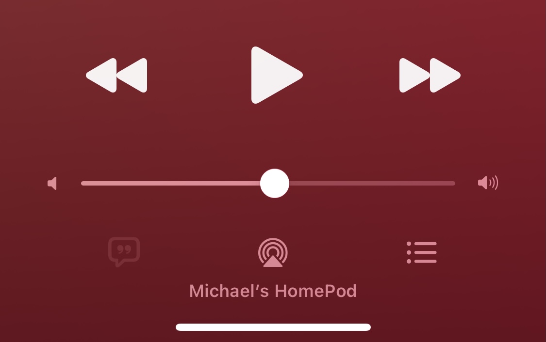

When I'm in Music on my iPhone, I tap the AirPlay icon and it beings up my various speakers (HomePod, Apple TV, etc). When I select the HomePod, I find that more often than not it just gives HomePod complete control of the music, as opposed to showing that I'm speaking FROM my iPhone TO the HomePod (illustrated by the "iPhone -> HomePod" AirPlay text as well as the HomePod symbol on my iPhone volume controls.

It’s the difference between these two options:
OPTION A: Ask Siri to play music via HomePod
OPTION B: Use my iPhone to stream to HomePod and simply use the HomePod as a “dumb speaker.”
The problem is that half the time I try to go for Option B, it ends up giving control to the HomePod and it becomes Option A.

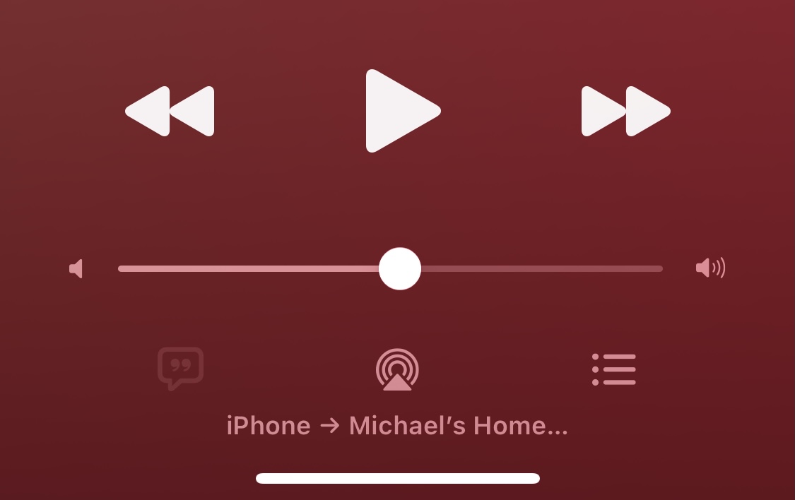

• Now you can press the AirPlay icon, select HomePod as the output, and you’ll be streaming from your iPhone to the HomePod as a “dumb speaker” (pictured in Option B, with the iPhone -> HomePod” text to confirm.

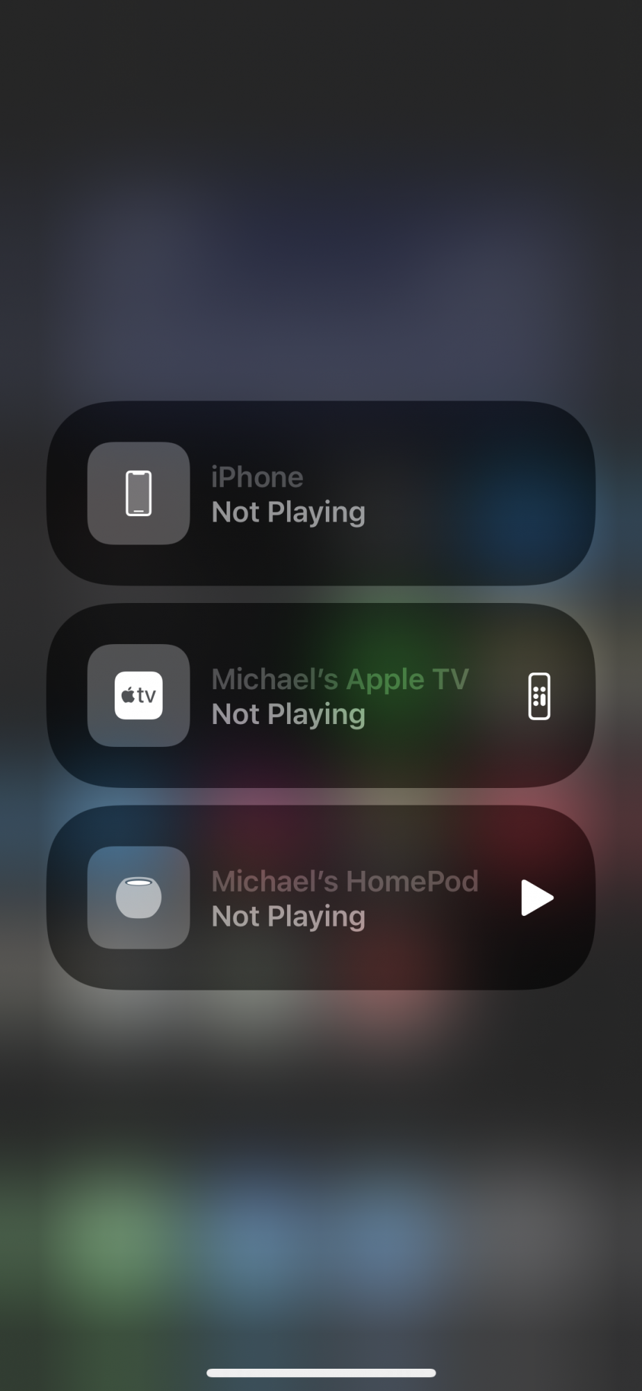

I currently have 3 devices that can play Music: my iPhone, my Apple TV, and my HomePod. I only have one Music account, so audio can only come from one source at a time. When long pressing the “Now Playing / Not Playing” Control Center platter, it presents my audio output options:

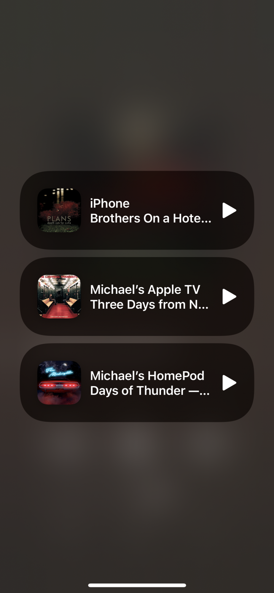

However, it *IS* possible to end up with music that is queued on all three devices at once. Mind you, audio can only come from *ONE* device at a time, but depending on when I was streaming from each device, it’s very possible to have three different Music albums/songs/playlists all queued up and paused on each device:
So, whichever device I select, it will have its own “Now Playing” banner at the bottom of the Music app. If I select “iPhone,” the music app will show that audio is coming from iPhone. If I select “HomePod,” the music app shows that audio is coming from HomePod.

I have to select HomePod via Control Center (Days of Thunder), then open the Music app and force quit, then go back to Control Center and select iPhone (Brothers on a Hotel Bed), and then reopen the Music app before it will let me stream from my iPhone -> HomePod.
In short, the Music app is capable of having music already “playing” (albeit paused) on each device, and I have to force quit whatever is queued before I can use the iPhone to stream to that specific device. Think of it as if each device has its own individual Music app, so you have to force quit the Music app for each specific device before it’ll allow you to stream from iPhone to that particular device.
This will rarely be an issue for me, but I’m glad that I figured out what I need to do in order to directly stream audio from my iPhone to the HomePod without the queued audio from the HomePod preventing me from using it as an AirPlay output “dumb speaker.”
