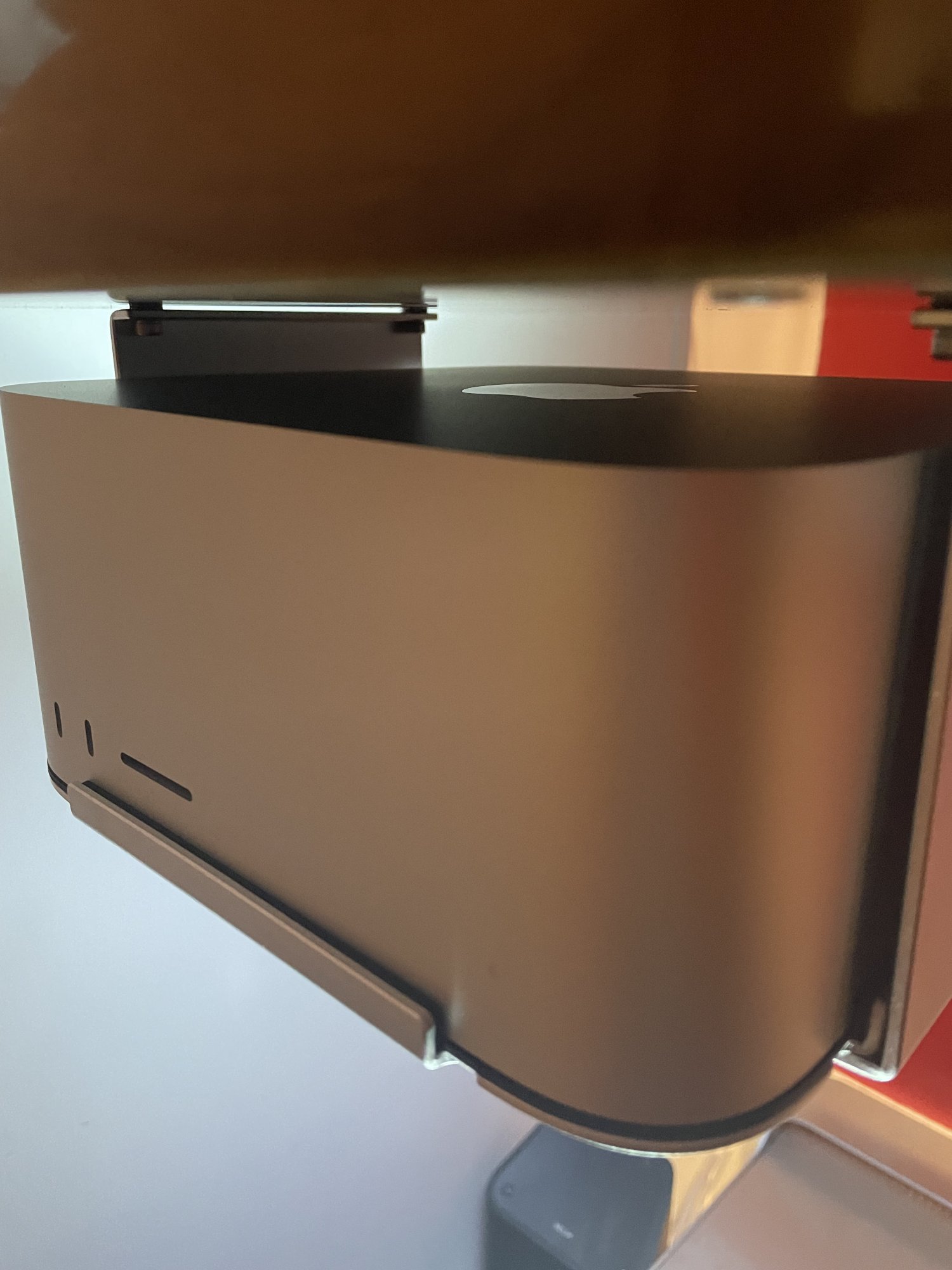

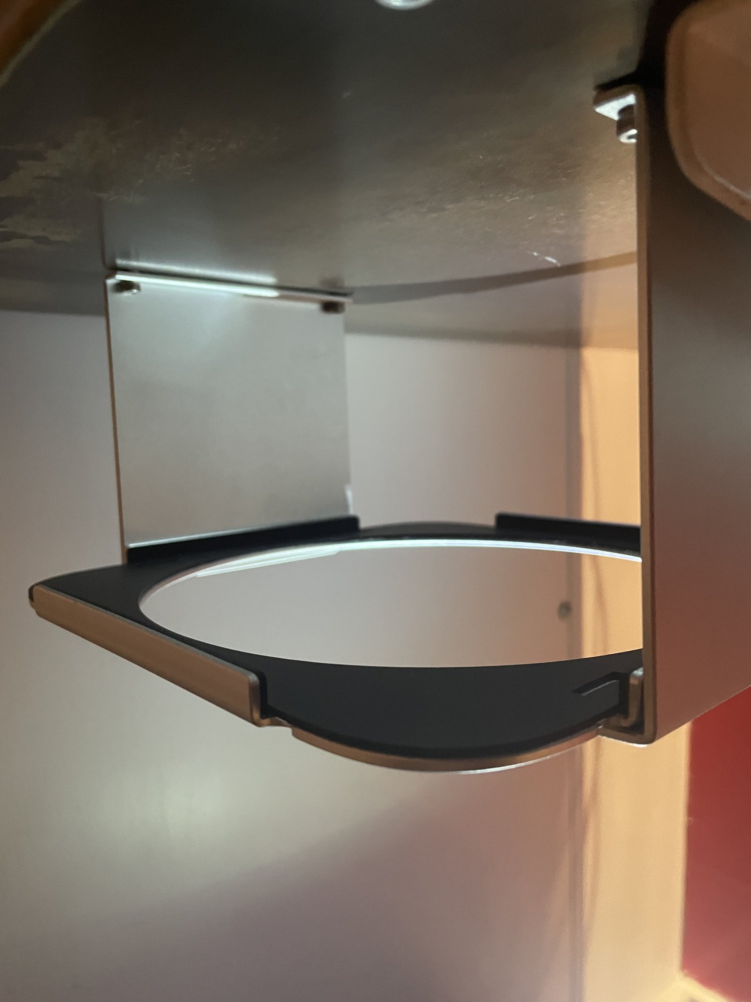

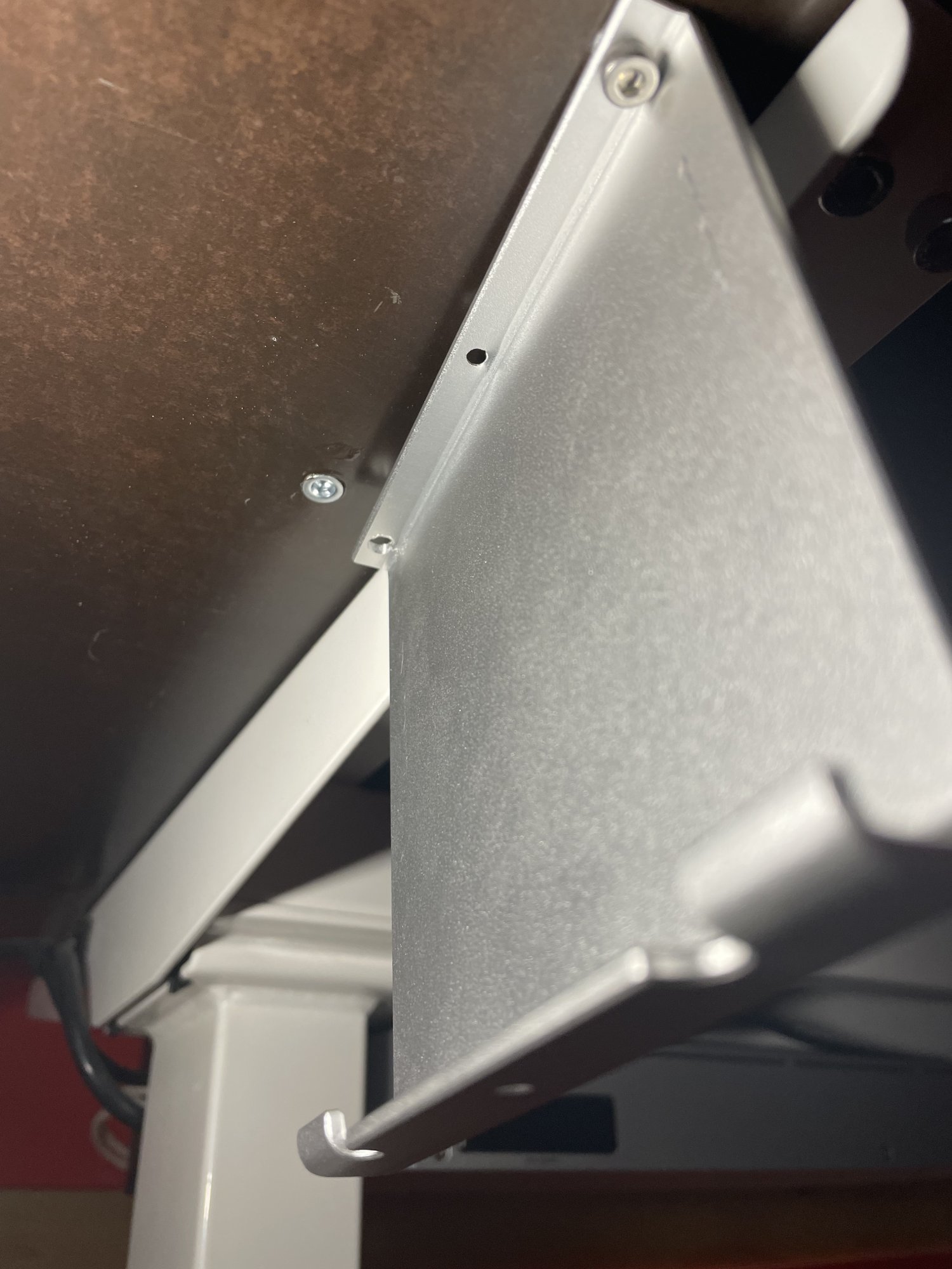

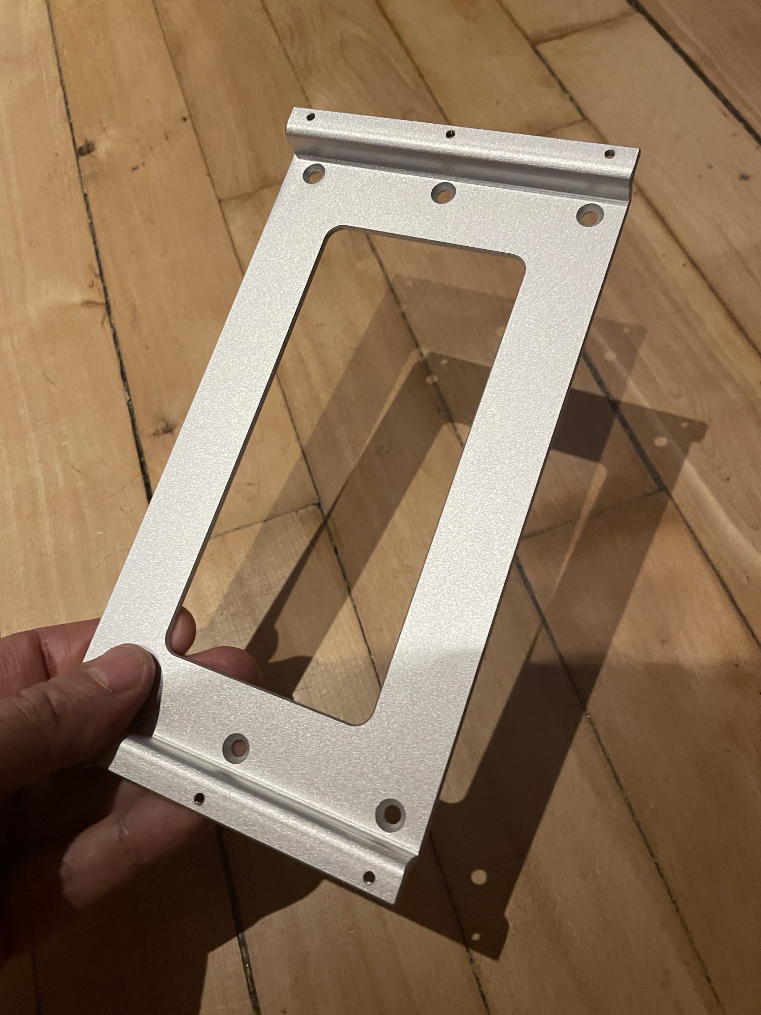

I finished the mount install for my new M2 Ultra. I ditched the additional bracket and used only the two side brackets for a cleaner install, fixed with wood inserts, I did not trust the provided screws. There is plenty of space for additional drives or wires to pass, very happy with the end-result. I'll update my home office pictures soon.
