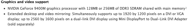

Mac mini (Early 2009) has a Mini DisplayPort output so you can connect any modern display to it. The resolution will be limited to 2560x1600 60Hz (I don't know if 4K 30Hz is possible, maybe with a pixel clock patch).
24" 1080p or 1200p or 30" 1440p or 1600p (non retina) displays would be the best options if you like larger text.
https://support.apple.com/kb/sp505?locale=en_NZ
