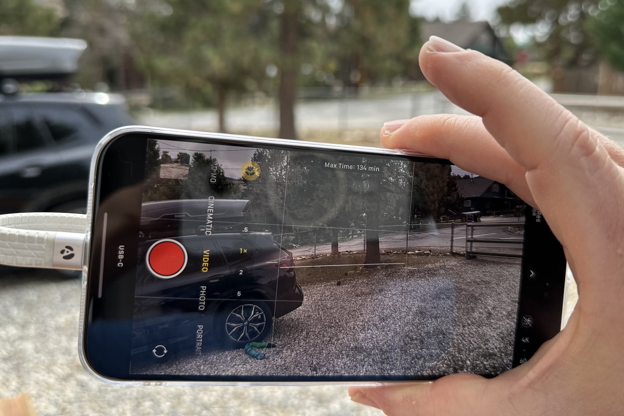

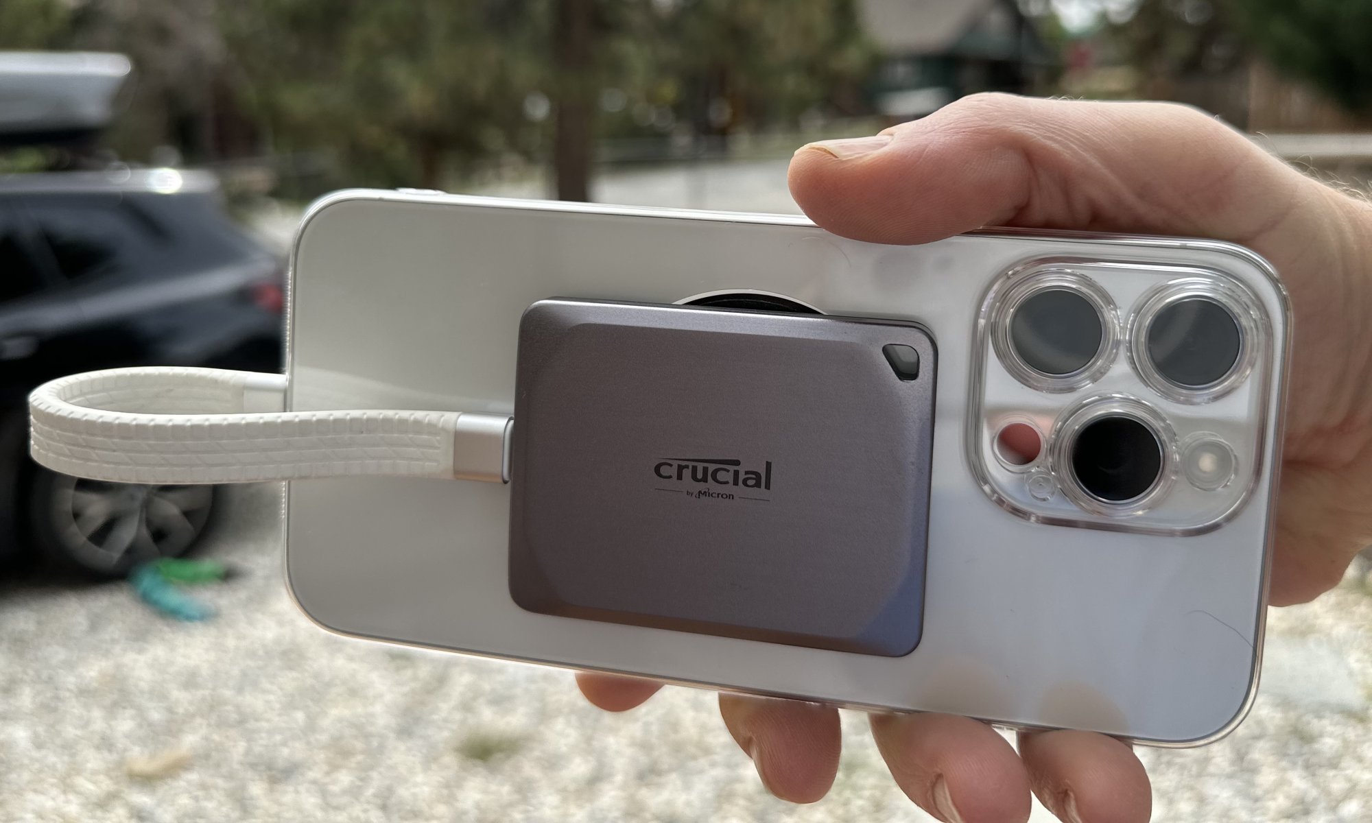

A super minimal 4K 60 rig. I’m using a Crucial X9 2TB, mounted via MagSafe. Can get 144min for 2TB. The X9 really good bang for buck. $70 for 1TB.

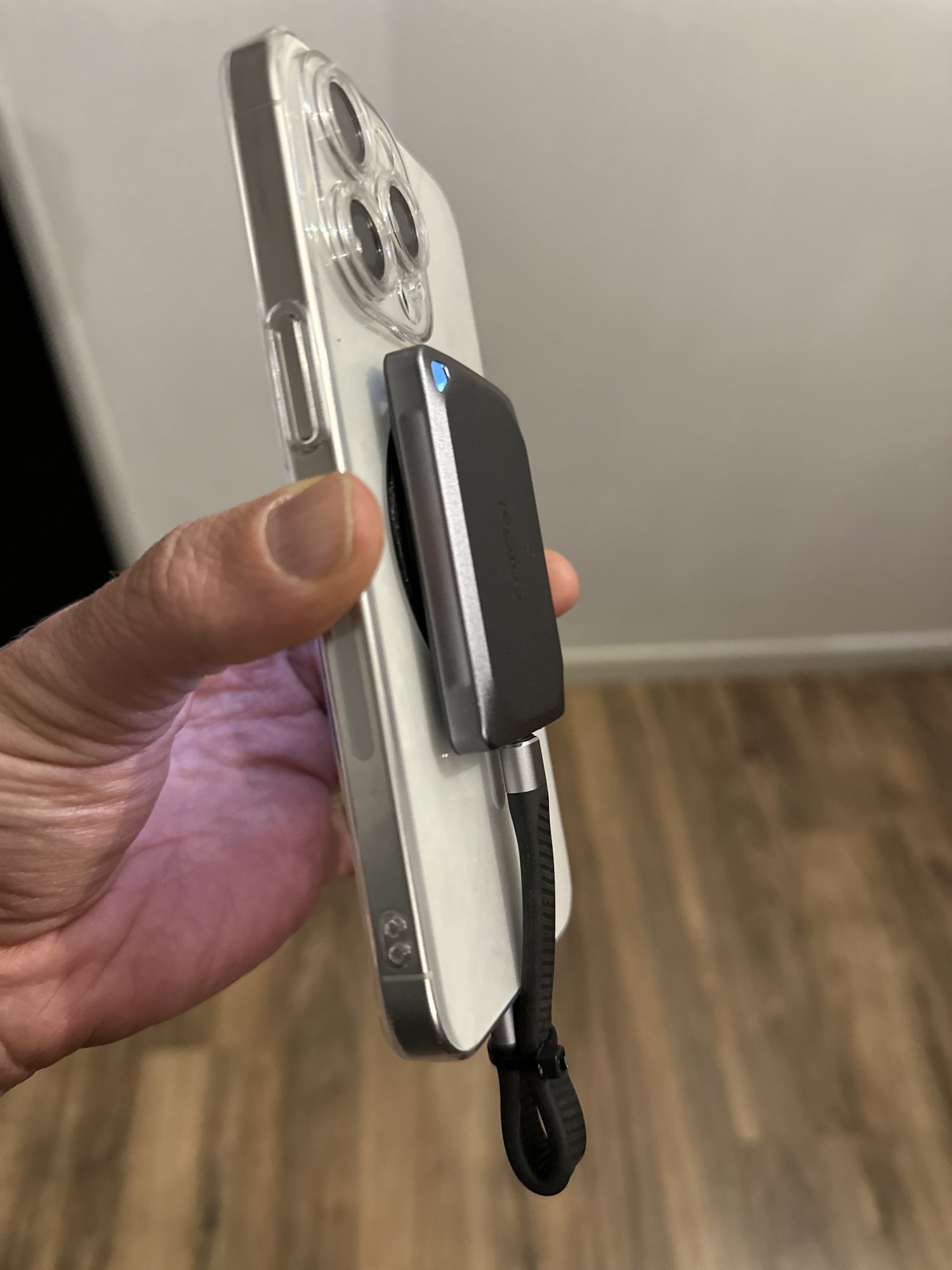

The mount comes with 2 options. A thick really strong MagSafe and a paper thin, probably strong enough MagSafe. Digging the ultra thin case as well.
If someone finds a 3.5” super flexible USB-C cable, let me know! It has to be flexible or it will pull the drive off the MagSafe.

The good/bad thing is if any excessive pressure is applied it will just pull off the MagSafe. Virtually no pressure as set up though. The bigger surface mount, increases the profile, but makes the MagSafe much stronger. With the slim one I am using, it is strong enough to handle moderate shacking of camera, but sometimes comes off in my pocket.

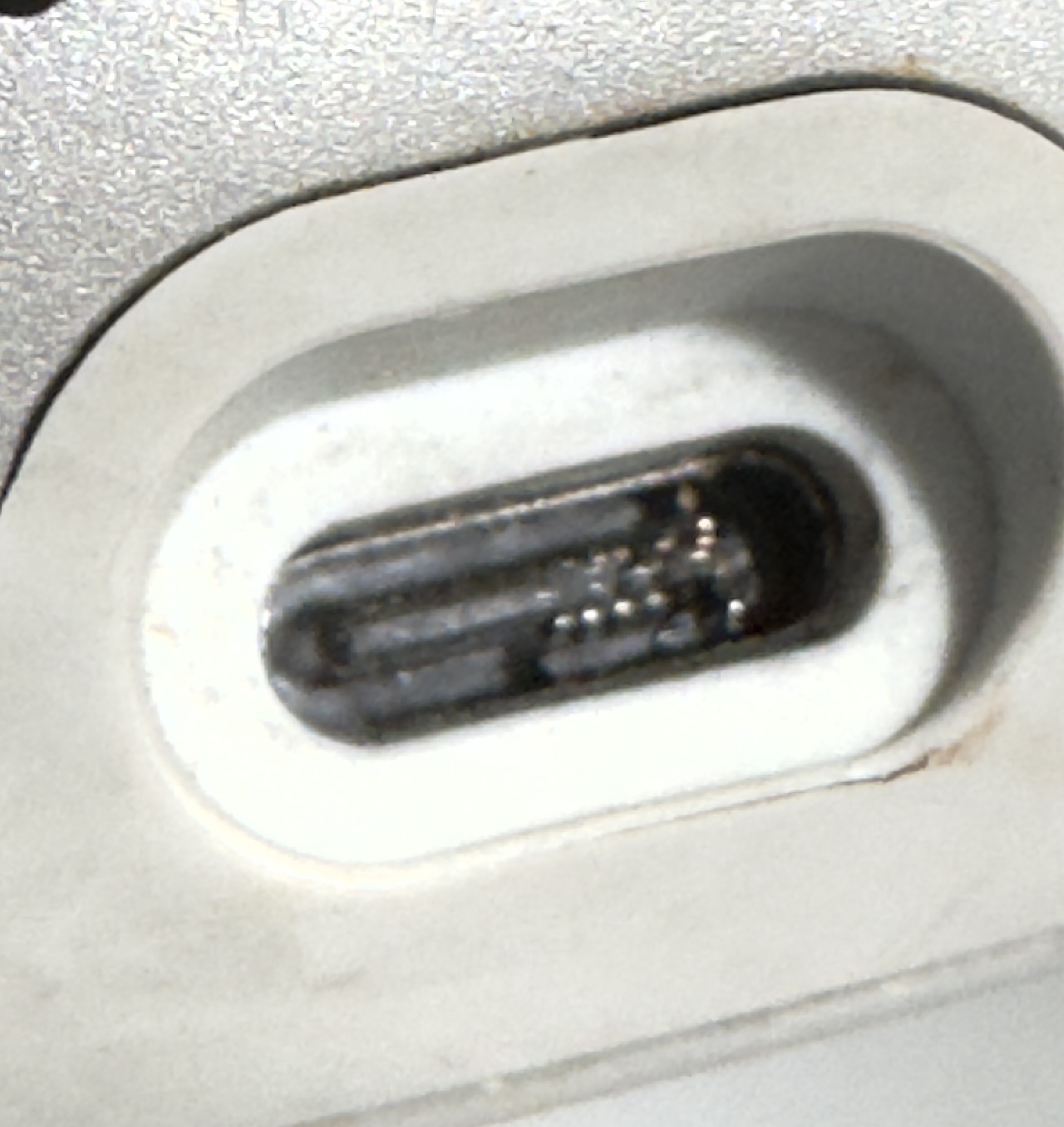

This is a USB-C port on a Bose portable speaker I destroyed. Doesn't take too much, so want to go with a solution that minimizes chance of doing it to iPhone port.

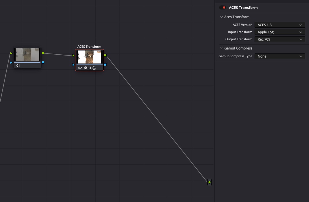

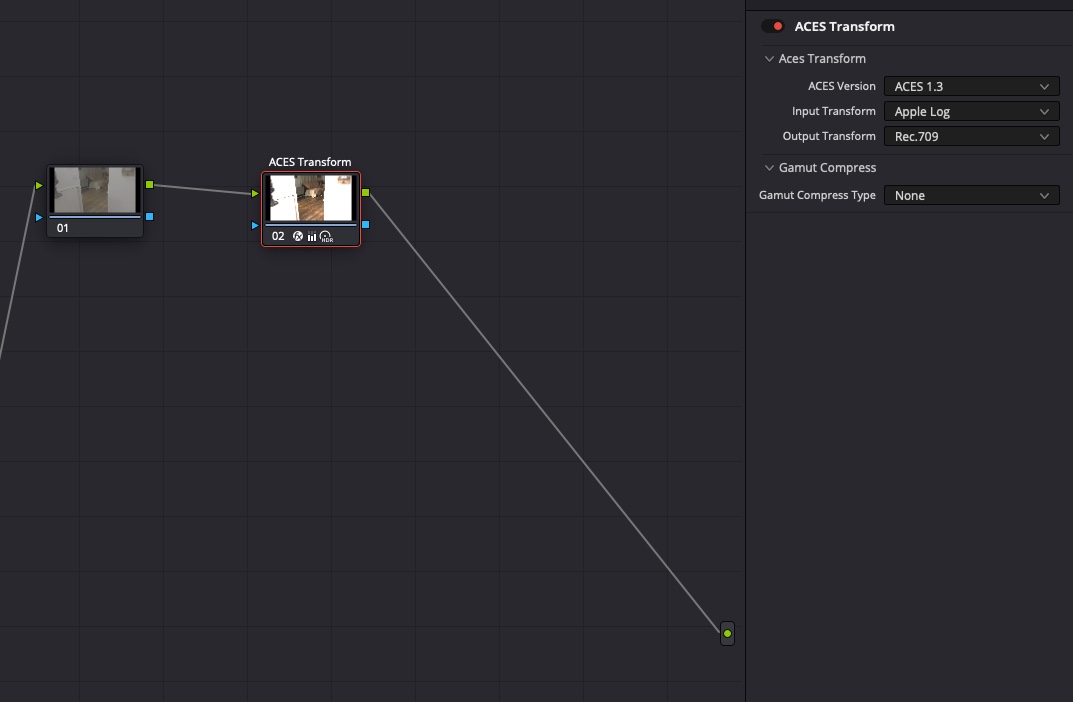

I managed to get the Apple ProRes Log footage into Davinci Resolve 18.6 on OS X. The needed preset are not currently on the iPad version. I kinda managed to get it looking good, but would be wonderful if someone who knows wtf they are doing did a tutorial on it. :)
Previewing on a 32" 4K monitor, the quality seems quite high, not quite at the level of my Sony FF with big glass, but it is not bad. Not very noisy in moderate lighting. Also, all the over sharpening seems gone.

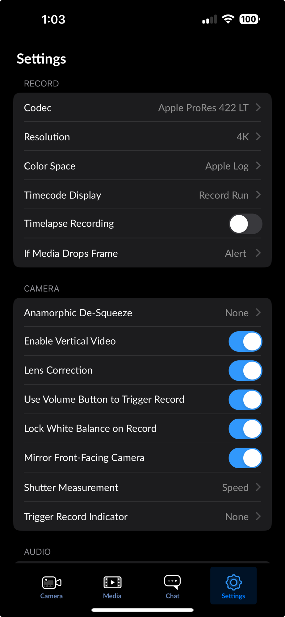

Testing both with the Apple Camera app and the Black Magic app. Both seem to work well, but you have far more control with the Black Magic app, and you can apply LUTS in Phone.
Slight modification. The black USB-C cable I linked is actually slightly shorter than the same cable I already had in white. Good as it is sleeker, but I needed to put a little ziptie to reduce the pressure when bent. I also added a couple drops of super glue to the adhesive on the MagSafe ring, as it gets pretty warm right there, and it was causing the stick on adhesive to come off.

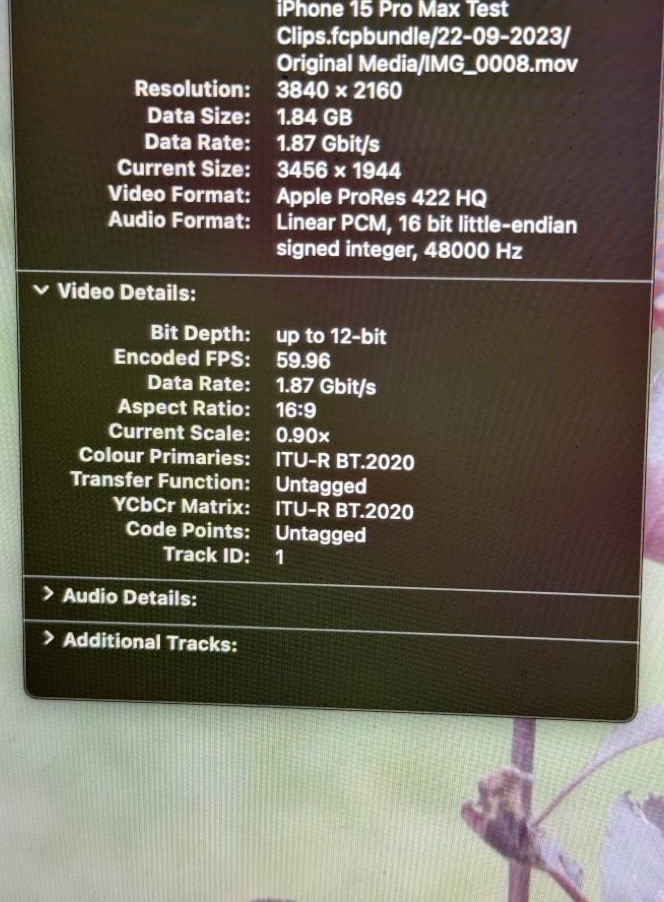

Also I figured how to correct the ProRes log in Davinci. Can do it either in the timeline settings, or as color node "Aces Transform"

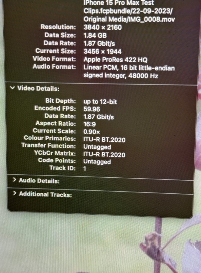

From the testing done so far, the log mode yields much less processed results than the HDR or SDR ProRes modes. The results look more like a professional camera than an iPhone.

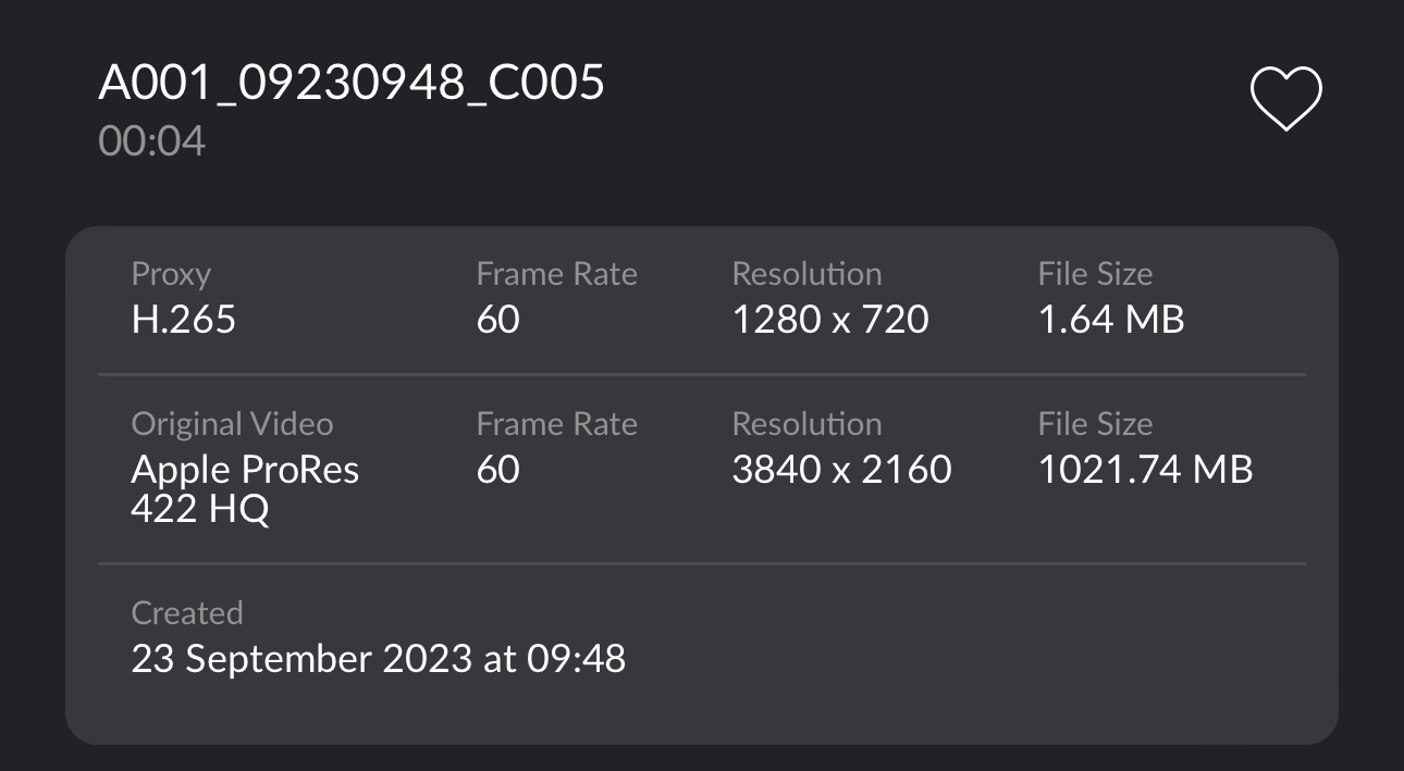

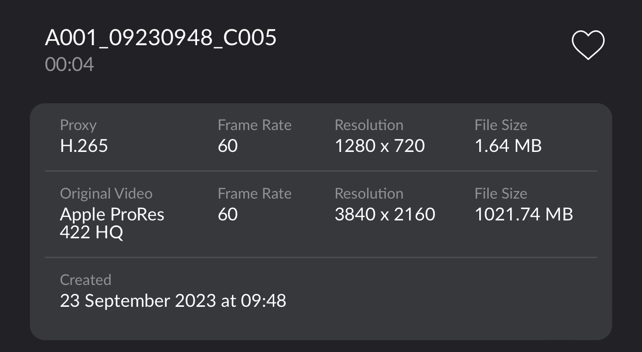

I also tested vs the Blackmagic app, and it is pretty awesome, as long as you are going to lock the white balance and exposure down for each shot. If you want to let those adjust dynamically, then the Camera app does a much much better job of it.
Blackmagic does let you choose which ProRes codec you want to use, so you can save some space and use 422 LQ. It also let's you apply a LUT in phone so you can see something closer to the final result.

4K 60 bitrate is nice

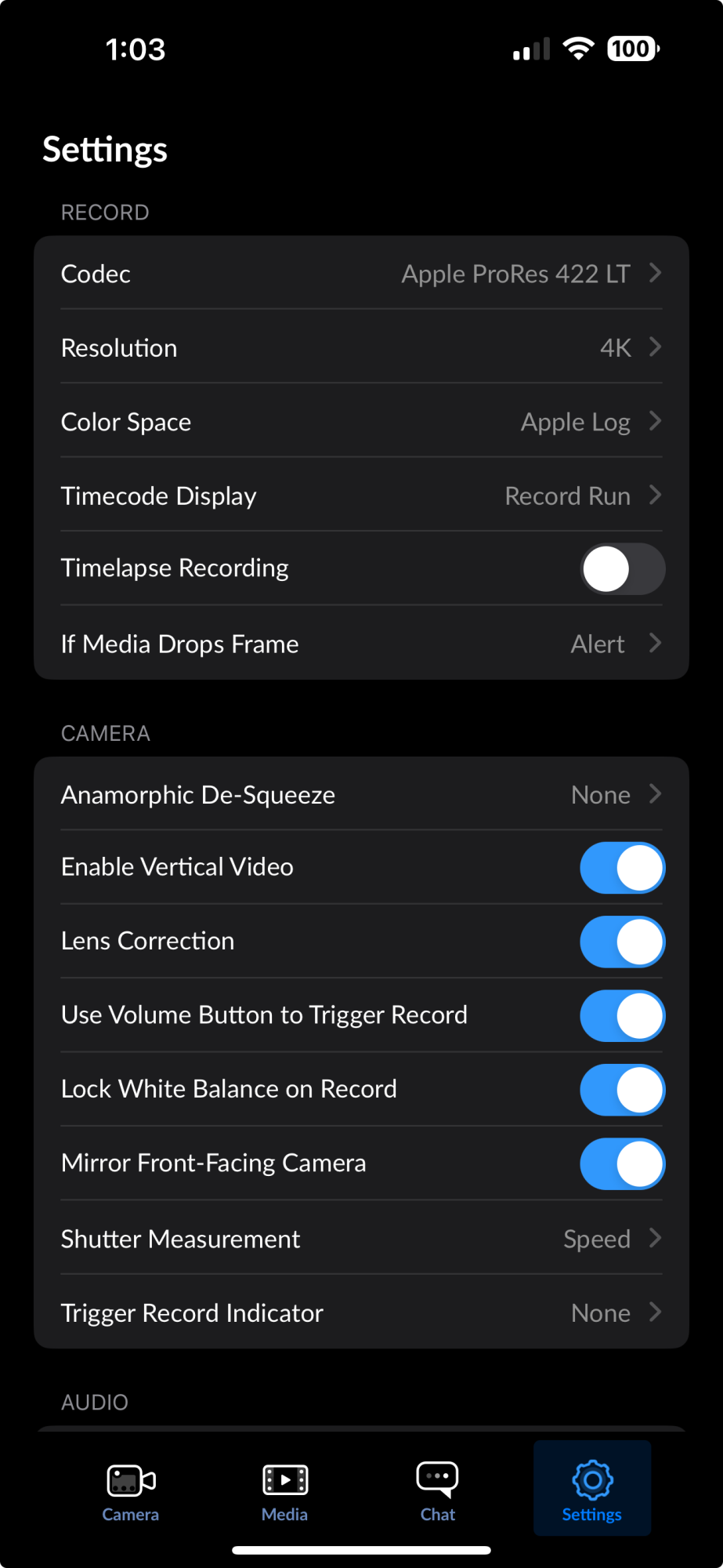

Seems I can actually record in 4K60 LOG direct onto the phone in Blackmagic App.
I thought external SSD was required for this.
I thought external SSD was required for this.View attachment 2277725
I saw that, didn't test it. Probably is a viable option, if you go with a lower bitrate codec or have a high storage iPhone. They support a lot that Apple isn't... I think their app is doing way less computational photography, likely freeing up the resources.
If you are doing a film, their app makes a ton of sense. If you are walking around your house taking videos...the ability of the Camera app to seamlessly adjust the exposure and white balance is nice. You can't even tell when the Camera app adjusts, but is very obvious if you let the Blackmagic app adjust those.
