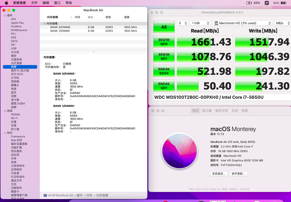

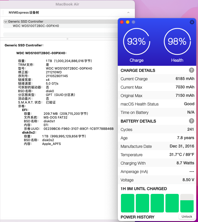

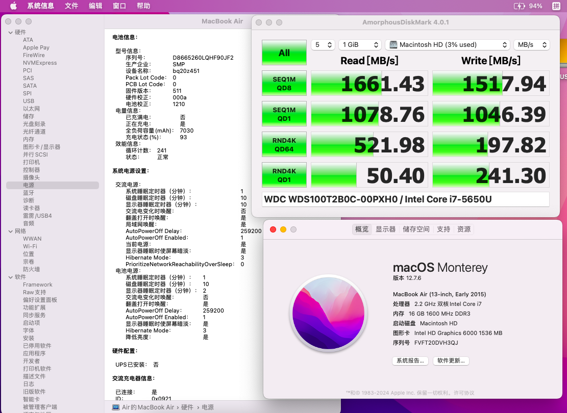

Modified and upgraded 16G RAM, NVME 1TB SSD

Ooh that looks great, did you have to find a 16GB logic board to do this upgrade or did you modify it? The speeds for the SSD are pretty astounding, I clocked the stock Apple SSD 250GB that I swapped into my MBA at 300MB ish read and write in BlackMagic, so tossing a Sintech adapter and a 1TB SSD in here would be a substantial input/output speed boost.
