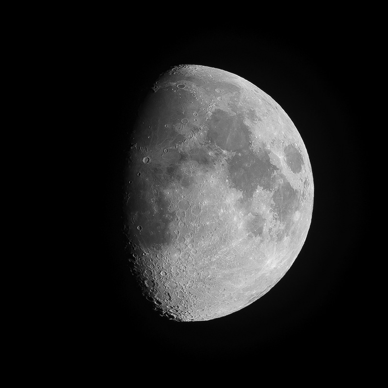

Originally posted this in the August POTD thread, but then realized it's the end of the month and peeps may not see it. Also thought it might deserve its own thread as the info I posted kind of goes beyond a POTD post and might be useful more generally.
I took this tonight with the following gear and exposure settings:
Sony A7R2, 100-400mm zoom @ 400mm, f/8, ISO 100, 1/80 sec. Tripod (obviously).
Some tips for taking shots of the moon:
400mm on full frame is about the minimum you need to capture surface details. Even then, surface details aren't perfectly sharp. @400mm you are going to have to crop *heavily* to fill the frame. Really need a telescope, but I've been impressed with the above gear combo. I've gotten *close* to the same results (but not quite as sharp) with a Nikon D810 and 80-400 zoom. Worse results with a D810 and 200-500. Also worse results with a D500 and either of the above lenses.
Because you are going to have to crop so heavily, it's pretty important to really nail the exposure. Use the lowest ISO (i.e. 100) to minimize noise, maximize dynamic range, maximize sharpness.
Use manual exposure as the majority of the frame is going to be black and any automatic exposure setting is going to horribly overexpose the moon. The above settings are a decent starting point. Using Live View is wonderful as it is easy to see what the sensor is seeing when you click the shutter. I varied the shutter speed in this series and found that 1/100 sec was also acceptable. 1/125 sec required upping the exposure in post which introduced noise that affected the final image. 1/60 sec was overexposed but not blown-out. But none of the pics at 1/60 sec were as sharp. Because of the heavy crop, manipulations you make in post to the image are going to be more obvious compared to standard pics. Try to get it right at the time of capture.
A tripod is mandatory as is some form of remote release or delay to prevent any motion. A remote release is optimal, but for this I used a 5 sec timer delay. Even tiny motion from moving the camera on the tripod at all will introduce blur. If you make an adjustment, wait a few seconds to let things settle down. Then trip the shutter remotely or on a timer. Possibly this image would have been even sharper had I used a remote release rather than the timer release.
Because of the massive cropping, even with a large megapixel body the final file is going to be small. I increased the file size on export from LR, but not sure if what I did is the optimal way to attempt to preserve detail while upscaling an image.

Thanks for all the replies!
I agree that the full moon is often the least interesting phase photographically--partial phases create shadows on the moon surface that result in texture in the image.
I actually have had better luck with AF as opposed to manual focus. Because of the extreme cropping, nailing focus is critical and both my Sony and Nikon do a better job than my aging eyes. Attention to good technique is also critical to prevent *any* blur from camera/lens motion. Even tiny amounts of movement that wouldn't normally be evident get magnified and result in loss of surface detail. You are really pushing your lens and camera to the limits of their ability to resolve detail. It's a good exercise to force yourself to learn and practice good tripod technique.
I've been thinking about getting a telescope, but I'm in the suburbs with light pollution and have too many trees that limit my view. May do it someday....
Also keep meaning to research how best to preserve detail when upsampling heavily cropped images. The above crop is 1126 pixels on each side. This is about the equivalent of the output of a 1.3 MP camera sensor (perhaps a bit bigger since this is a square crop--maybe an ~2 MP sensor?). The original image is ~42 MP (this is one case where a high MP body actually does matter, assuming the lens is capable of resolving close to the sensor limit). Using 180 dpi as the minimum for a decent quality print, this means 6 1/4" is the largest one could print this. I know it's not possible to create detail in either LR or PS, but keep meaning to explore any output tricks to be able to print an acceptable image from a relatively small file. Anyone have any experience with this?

Thanks AFB, I'll check it out though it looks to be Windows only which would complicate my workflow. I did a Google and ended up moving the file to PS and upsampling there which worked really well--only a minor loss in detail which could be fixed with bumping up the sharpening in LR slightly more compared to the original (I sent the pic to PS without any sharpening, upsampled the file size, and then applied sharpening in LR on the resultant file). Ended up with a usable file size that was close to identical to the original cropped version.
Forgot to mention in my other posts to turn off any image stabilization in either the lens or the body. Forgot to do that in my previous pics. Took another series last night with IS both on and off and the images with IS off were universally sharper. For most pics it may not matter, but because of the extreme crop needed for moon pics (again you will end up cropping close to pixel level), *anything* that introduces any element of blur will show up in the final pic. Lens or body IS usually introduces some blur--better than motion shake when hand-held, but when shooting on a tripod and pushing your gear to the limits, IS should be turned off (at least when using a Sony--the only examples I have).

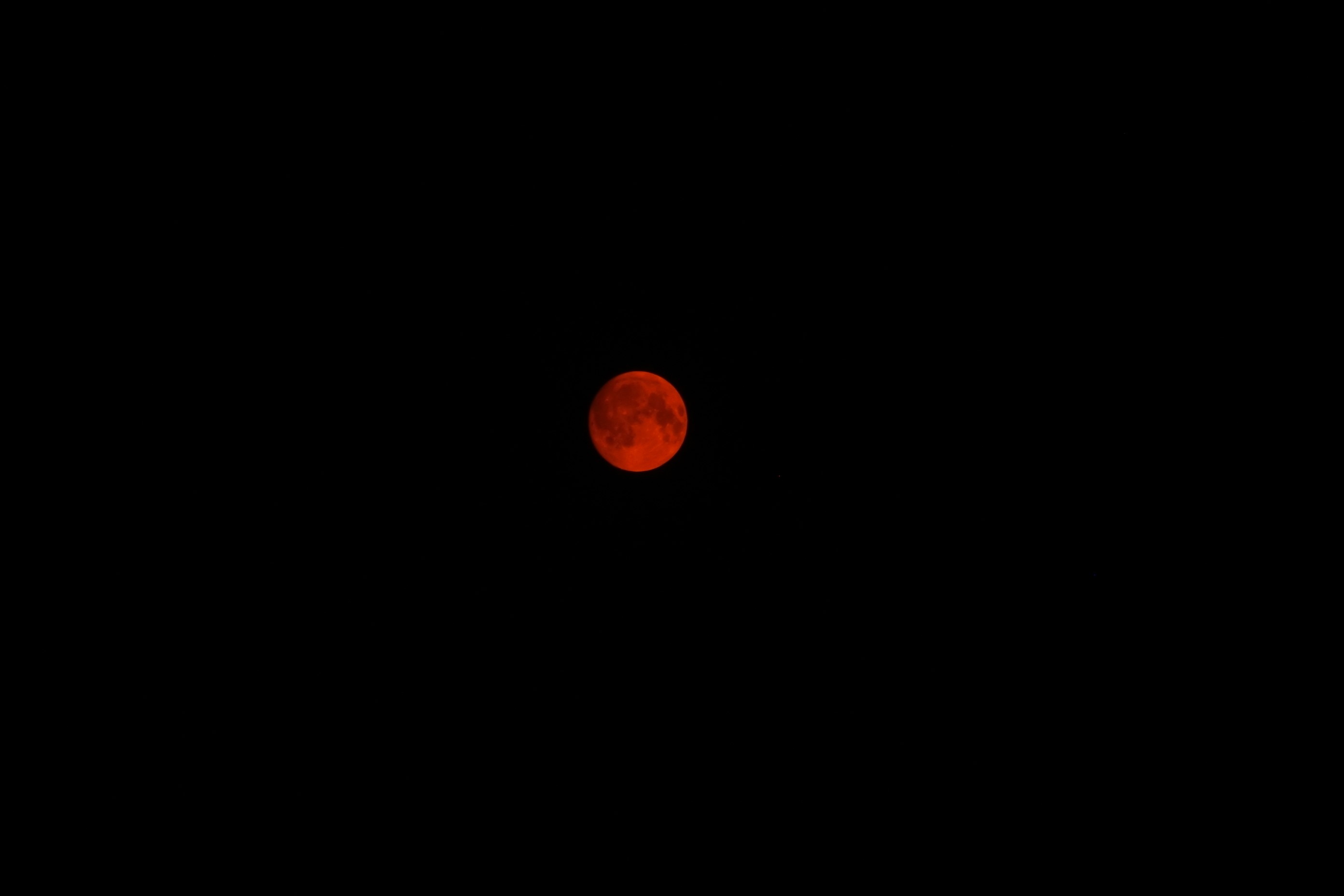

Like Photoshopper, I'm in the Northwest US, where forest fire smoke has tinted the moon recently. It's good tonight, but a few nights ago it was straight out of a horror movie!
Nikon 1 J5 with 30-110mm lens at 110mm (~300mm equivalent,) manual focus (just shy of "infinity" since mine is one that infinity is out of focus,) ISO 400, 1 second exposure, f/5.6. Also, the VR/stabilization in this camera+lens is amazing, this was hand-held.
I was an idiot and had left the camera in 5 MP mode after a recent trip, so not nearly as many pixels as it should have. I didn't notice until looking at the pictures the next day. So this is cropped in from a 5 MP image, rather than full 20 MP.
This had the levels slightly tweaked to bring out more detail, the original image (and naked eye) had it a little redder, and quite a bit darker. I've attached an unaltered version taken a couple pictures before.

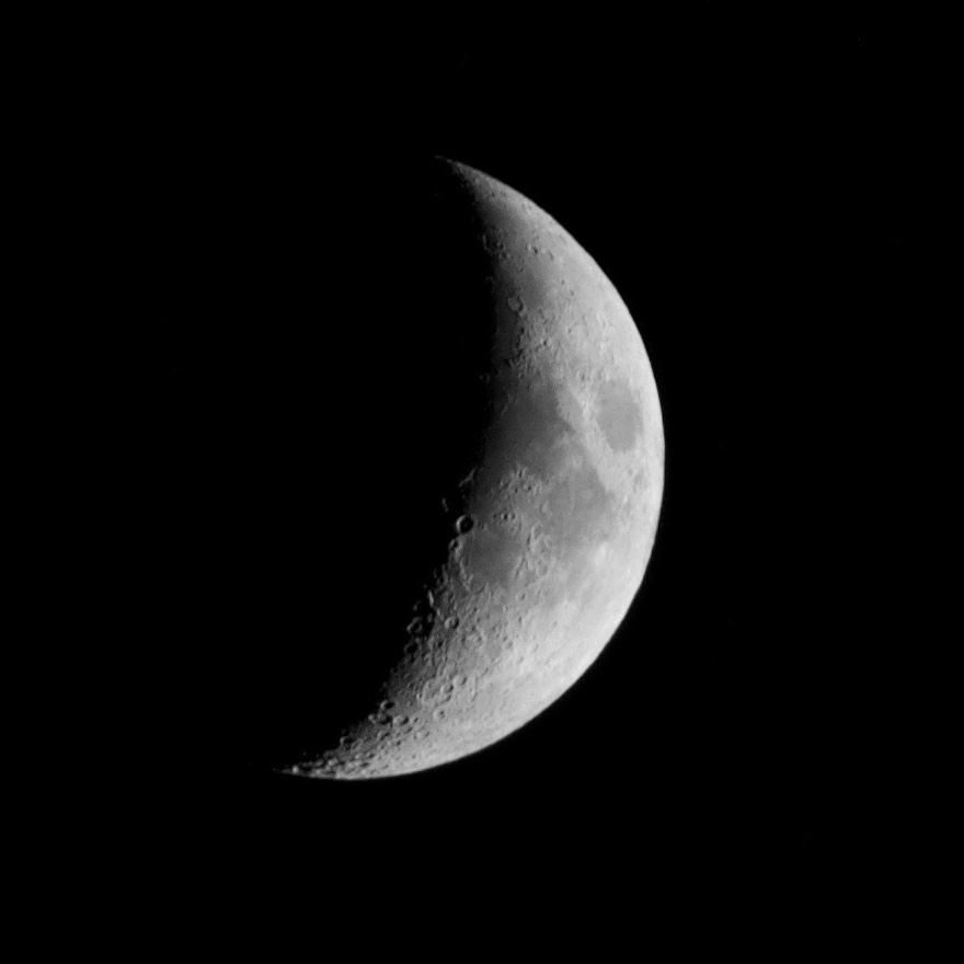

I’m going to try again tonight. I probably messed up a setting when I was trying to tweak everything. Here’s what I ended up with:
Good attempt! well done. maybe try to bring the zoom in a little bit as kit zooms are known for not being sharp at the far end. Put your aperture to F11 ish.... iso 100 (or lowest camera goes to) shutter maybe 1/125 as a start...
switch to manual focus, turn on LV and focus carefullly...
then use the timed exposure making sure any image stabilisation is turned off (if using a tripod)
Also remember that in order to get some detail, you need a less than full moon. The shadow then causes the detail to stand out better. A full moon has no shadow and just looks like a flat disk...
