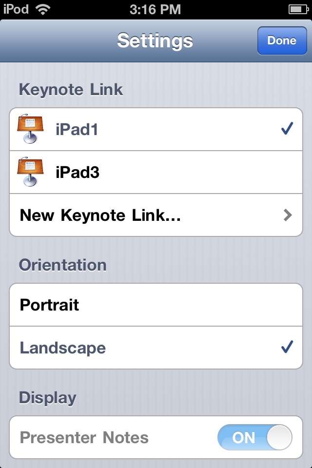

All these three tweaks (I've tested them all) work just fine with Apple's own Keynote Remote ($1; link; Universal) when Keynote is backgrounded on the linked and connected-to iDevice. The following screenshot shows it running on my iPt4G, linked to two iPads and being connected to the first:

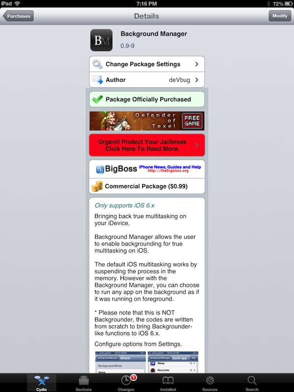

1.1.1 iOS 6: Background Manager ($1)
This brand new and absolutely excellent tweak allows for doing the same as the very similar “Backgrounder” did in iOS versions prior to iOS6: when pressing the “Home” button, the app will run as before. With apps with TV out support like Keynote, this means the title will continue outputting its content to the TV. Again, if you use Keynote Remote, you'll be able to control the slideshow even when it's in the background.
(Main Cydia page)

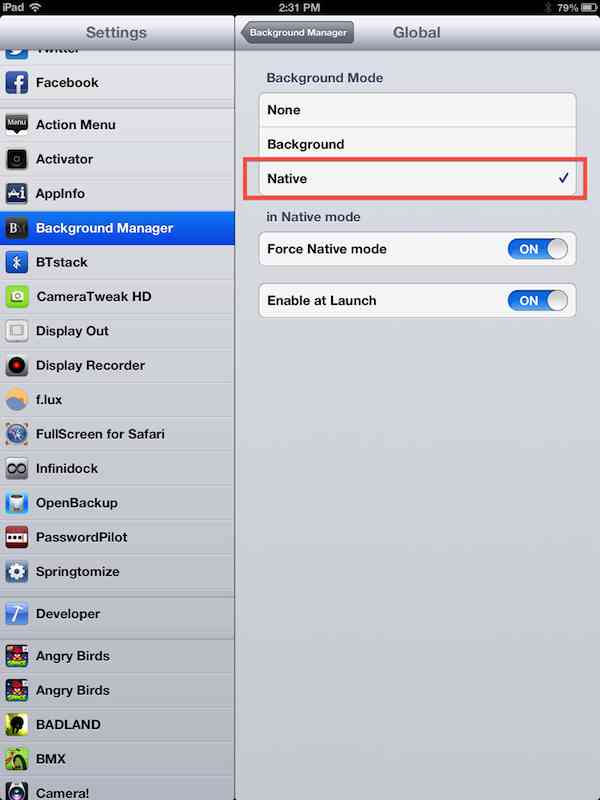

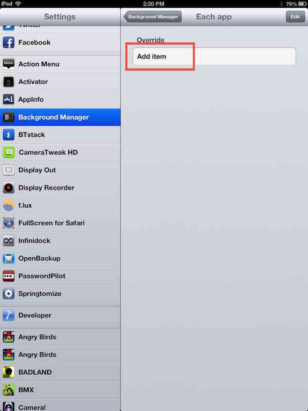

Configuring it is pretty simple:
1, go to Background Manager > Each App in Settings:
(as with all screenshots below, tap / click them for the large-sized original versons)

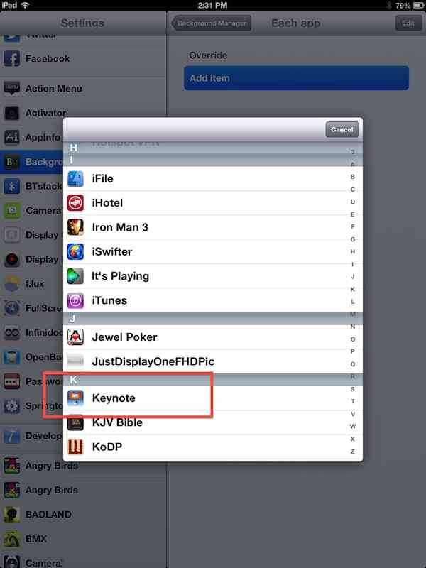

2, tap Add Item:
3, select Keynote:

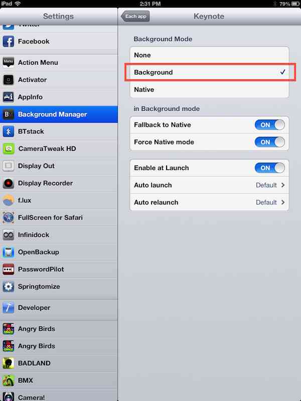

4, Keynote appears in the list below Each App, with an “N” suffix (annotated below):
“N” means it Background Manager uses the native backgrounding of Keynote when you press the Home button. This is the default for everything and, with Keynote, absolutely useless in our cases (as it doesn't support background running at all). Therefore, we'll need to force Keynote to "Background" (in pre-iOS6 parlance, “Forced”) mode. Tap Keynote in the above list and select “Background” in the uppermost “Background Mode” list:
(For (ex-)users of the pre-iOS6 Backgrounder, this “Background” mode is the same as “Forced” mode in Backgrounder, “Native” being the same in both tweaks.)

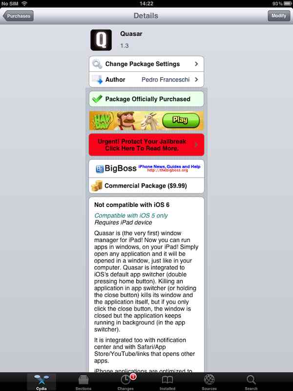

1.1.2.1 (iPad only!) Quasar
(the screenshot, in addition to showing I've purchased this tweak, also shows the developer explains everything is run in the background)
No special settings need to be done with Quasar – it'll keep everything running in the background, even if you tap the “Close” icon in the lower left corner of the window:

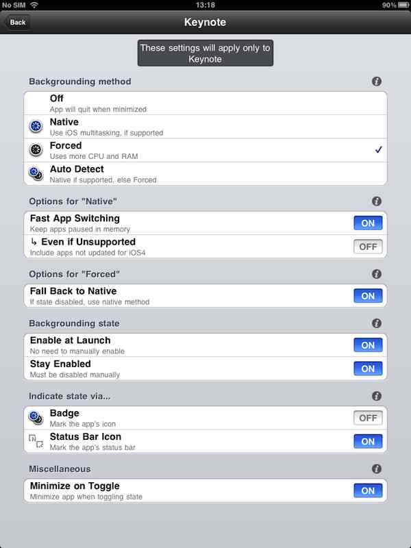

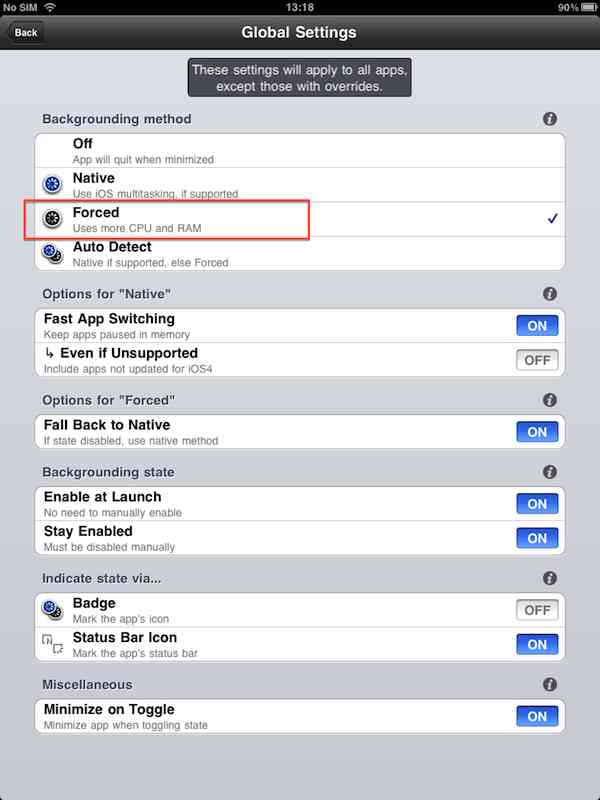

1.1.2.2 Backgrounder
This free and excellent tool, as has already been mentioned, runs on everything pre-iOS6, not only on iOS5 iPads. As opposed to Quasar, it doesn't support windowing.
Setting it up is done in exactly the same way as with the iOS6+-only Background Manager – basically, the entire menu structure is the same. There is only one major difference between the two tweaks (iOS compability and price aside): it, by default, defaults to “Forced” (in Background Manager's terminology, “Background”) backgrounding, unlike Background Manager. With the latter, the Background Manager > Global menu will show the following by default:
Also note that, unlike with Background Manager, Backgrounder isn't configured from the system-level Settings app but it has its own icon on the SpringBoard.
This is why you'll need to do a bit more to properly configure it.
It's configured for forced background mode, with two exceptions (Mail and Safari). The forced mode is shown in the following screenshot (in the Global main menu):
Basically, if it's only Keynote (and/or a handful of apps) that you want to run in the background while accessing the TV output, you'll want to change this to “Native”:

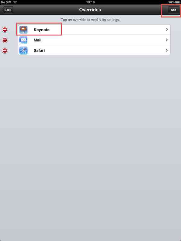

Also, after this, don't forget to add Keynote with Forced mode: Overrides > Add and select Keynote in the list.
Then, select Keynote from the Overrides main menu (below, I've also annotated the “Add” icon you need to tap in the previous step):
and tap Forced:
