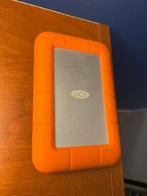

I have 2014 mac mini. 8gb 2.6ghz. Two thunder bolt 2 ports
I always wanted a thunderbolt drive but thunderbolt was always too expensive and still is. I found a used lacie rugged with thunderbolt and usb 3.0 for 60 bucks and free shipping with a thunderbolt cable. Thunderbolt cables are still expensive. Even third party. And others on ebay tb based are also 100+. Nothing less. So I jumped on it.
Anyhow thunderbolt 1 is enough for me. But just curious is this thunder bolt 1 or 2? And if it is a thunderbolt 2 drive does cable matter? The ports are the same size. But will a thunderbolt 1 cable give thunderbolt 2 speeds? Or do I need a special thunderbolt 2 cable?

I don't think you're going to find that a platter-based hard drive (which I believe is inside the LaCie drive you bought) is any faster over thunderbolt than it would be over USB3. That's because the drive itself "limits" the speed you can get out of it.
What you might do is buy a "bare" 2.5" SATA SSD.
Then open the Lacie enclosure (you have to take the rubber orange stuff off first), put the SSD into it, and try it that way.
THEN it will be quite fast...
I already have a bunch of ssds at home. Was thinking the same thing. There are no just plain thunderbolt enclosures available. And even used drives are not cheap. So this was the best option. Plus its tiny and slips under my monitor.
But I was wondering if anyone knows if the drive was thunderbolt 1 or 2? And a 1 drive will obviously work at 1 speed even in a 2 port.
But when thunderbolt 2 came out did they change the cable? The shape is the same. But does a cable that came with a 1 drive work for a 2 drive? Or do I need a 2 cable for 2 speeds?

The drive arrived today. My internal HD spinner not SSD was about 80mbps.
The link below is 2 screenshots. First is the thunderbolt speed. A little better but not much 109/108.
Then I opened her up and replaced the mechanical with a Sandisk 240gb plus SSD.
Their site says 550 read and 440 write. But I am only getting 324/329.
But thunderbolt 1 is 10gbps about 1250. So I should be able to max out the 550 should I not. Sata is 6gbps and thunderbolt is 10gbps. So that should be enough to max her out. Even same drive in a usb 3.0 enclosure was about 220. Not much faster.
Update:
Not sure if its thunderbolt 1 or 2. But 2014 mini is thunderbolt 2. Anyhow plugin my thunderbolt port only no usb. And it boots catalina 10.15.4 in 23 seconds.
Used to be almost 2 minutes from internal. And 50 seconds with a clean install of HS. But from external 23 seconds. Not bad for external.
Maybe with a faster ssd even better. My HP ssd only gets like 20mbps so drive matters too. But for now not bad.
I picked up a used MZ-76E250E 860 samsung evo 250gb from ebay for 35 dollars plus 4 dollars and 70 cents shipping plus tax. Not bad. Will see what the difference is when it arrives.
The Samsung SSD came in the mail today from ebay. And much faster. About 400 read ad 3 something write I forget. But much faster. Took out the sandsisk form my Lacie rugged and replaced it with the 860 evo. I got the boot to 20 seconds now from power button to login screen. Much better than my internal spinner which was 50 seconds. And my sandisk was about 30 seconds. But still every little bit helps. Boots super fast now and flys off the handle. No more colorful beachball.
[automerge]1589848995[/automerge]
Except still not sure I have the right cable. How do I know if its a thunderbolt 1 or 2 cable? Its black color and 1.5 feet. Not official apple.
