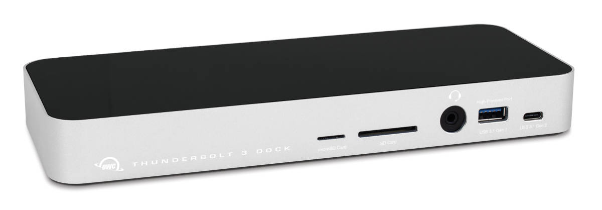

Hi
I have a Macbook Pro 2015 I7 with Thunderbolt 2 Port. Can I connect the docking station with Thunderbolt 3/4 in the link below to my Macbook ?
Can highly recommend the OWC Thunderbolt 3 dock. I am using it with the Apple Thunderbolt 3 to 2 adapter for my MBP 15" 2015 and MBA 13" 2017.
A Thunderbolt 3 dock can connect two displays. A Thunderbolt 2 dock cannot (excluding Thunderbolt displays which are there own Thunderbolt dock).
A Thunderbolt 3 dock can add 10 Gbps USB. A Thunderbolt 2 dock is usually limited to 5 Gbps.
