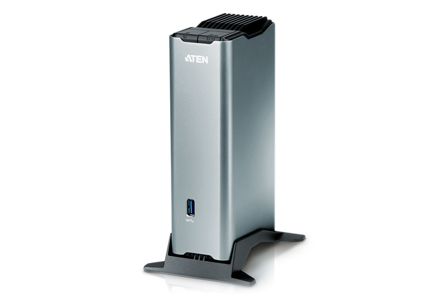

Every few months I check to make sure there hasn't been a Thunderbolt 3 or 4 switch, ideally with PD.. All I want is just two inputs and one output. That's it. It seems crazy nothing on the market exists. It needs to be Thunderbolt so I can with a single tap swap between my two displays, and keyboard and mouse.
Depending on your setup a DisplayPort 1.4 KVM + Thunderbolt 4 hub might be a workaround. What can devices are you looking to share between the Mini and MBPro?
Traditional KVMs won't work as it's a Thunderbolt 3 display which provides power and also has a USBc hub plugged into it which routes HDMI to a receiver (as I have floor standing speakers connected to my setup) and to second 4k display. Also connected to the USBc hub is a keyboard/mouse.
Instead I have a setup where I have to swap my inputs in my main display and switch my input on my receiver when I want to bounce between my MacBook Pro(s) and my Mac Pro 2019 and I lose out on the keyboard and mouse sharing. It'd also reduce two HDMI cables out from my Mac Pro to a singular thunderbolt 3 which is a bonus.
A thunderbolt 3 switch would let me leave the receiver / thunderbolt 3 display on the same inputs and just jump between my Mac Pro 2019 and either my M1 Max/MacBook Pro 2017.
