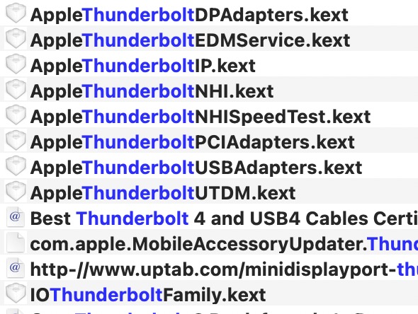

Could your problem be something "in software", perhaps a kext file getting "missed" during bootup? There seem to be quite a few Tbolt kext files:
