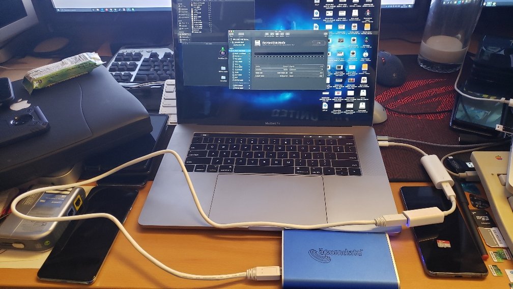

Using the Apple Thunderbolt to Firewire 800 adapter, I have been able to boot a 2015 Macbook Pro 15 off of several FW800 and also FW400 drives.
I have an old FW enclosure (with both 800 and 400) formatted with APM (Apple Partition Map) and many MacOS installers from 9 all the way to 10.14, bootable as far back to a Pismo. Even a 2018 Macbook Pro 15 has been able to boot from this FW drive, using an additional Apple Thunderbolt 3 to Thunderbolt 2 adapter.
