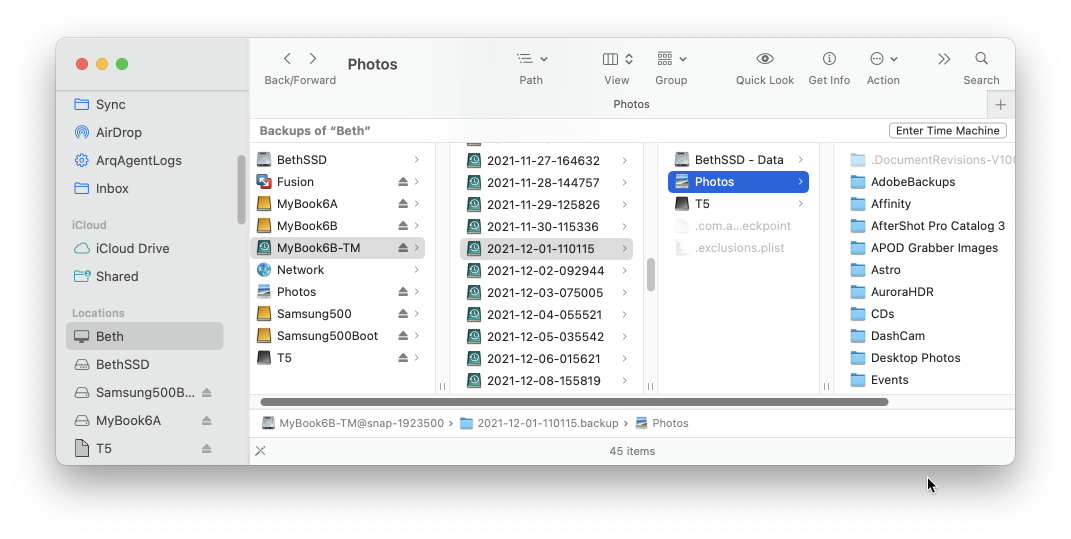

The cosmic delirium is pretty much unusable for me. But I never use it! Better to use Finder to explore your Time Machine disk. Like this where I have three disks backed up with TM:
Do you have something like that with your 'Extra Storage' below your macOS - Data disk.
Yes, but the difference is that my external drive (backuped, like bethSSD) is showed but empty (zero bytes).
