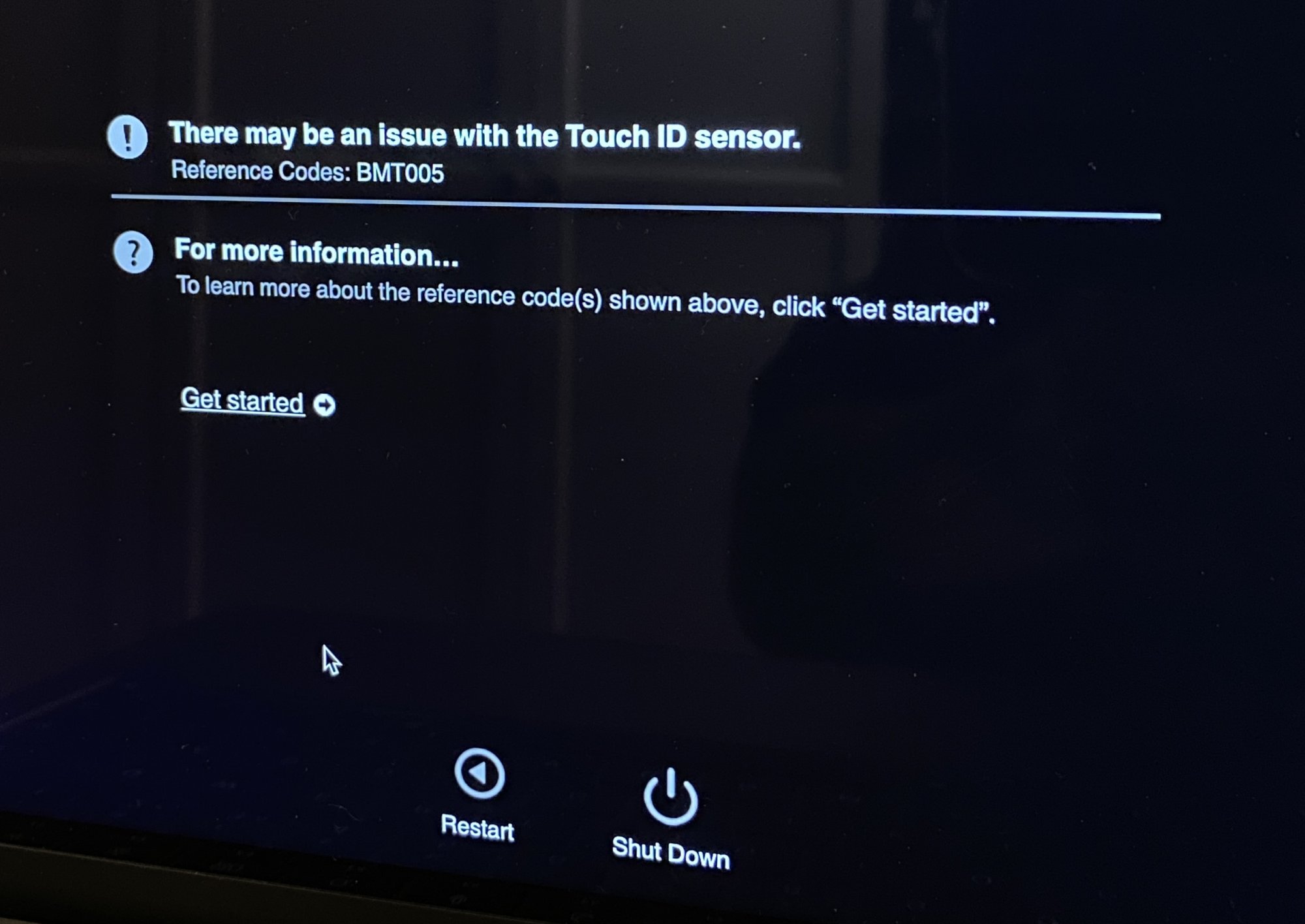

I realised it when I tuned it on, but just out of curiosity I guess, run an apple diagnostic to see what happens.
So of course as expected the Touch ID did not work nor the ambient sensor and True Tone.

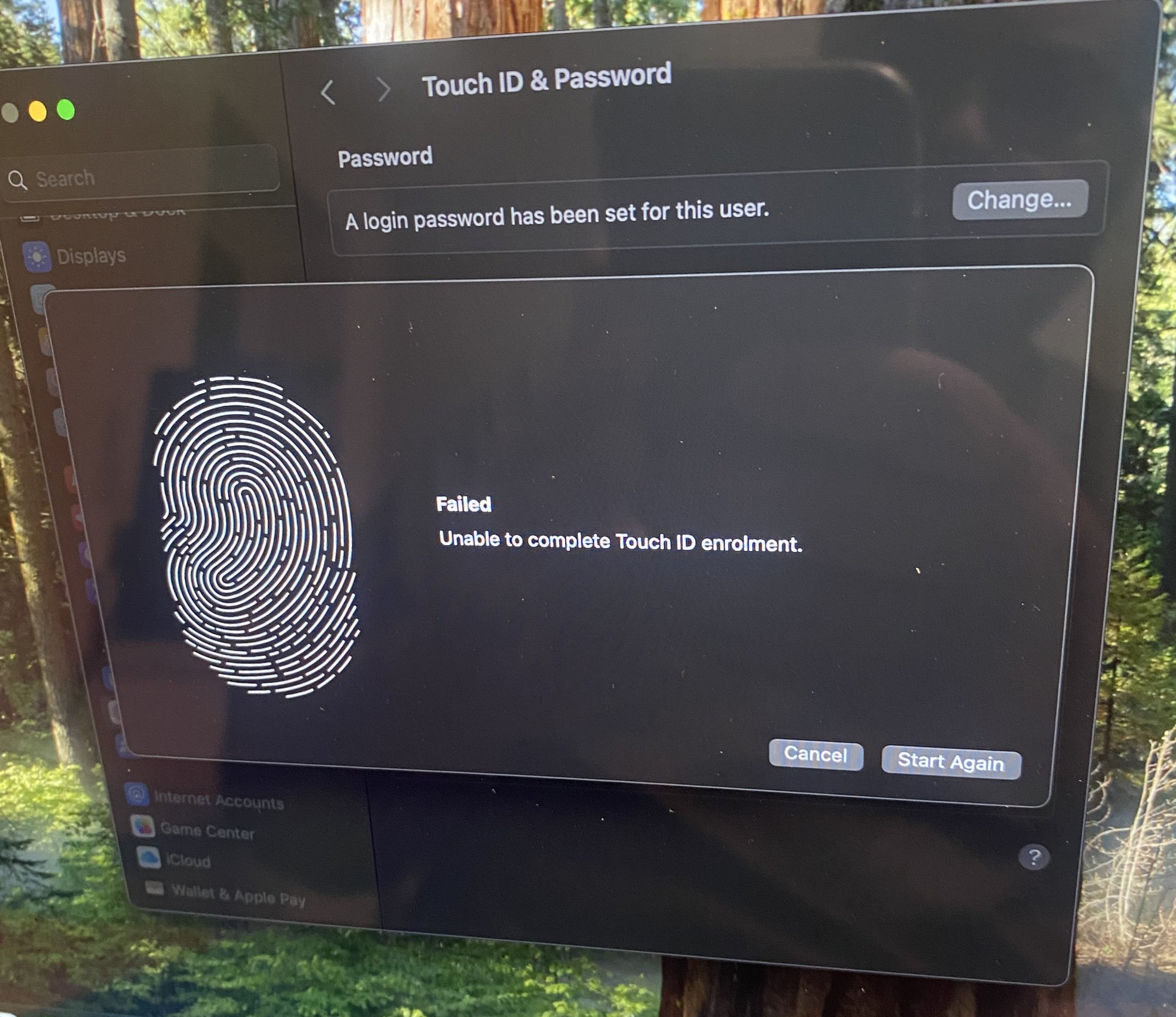

Reinstalled LAST logic board with LAST Touch ID and that one still works fine.
So it seems like by mixing up the logic board and Touch ID blocks the functionality even if you later reinstall the correct board with the correct button. Or may be running apple diagnostic caused this not just simply macOS.
I DFU restored the OLD board with OLD button. Touch ID still does not work.

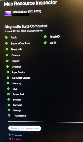

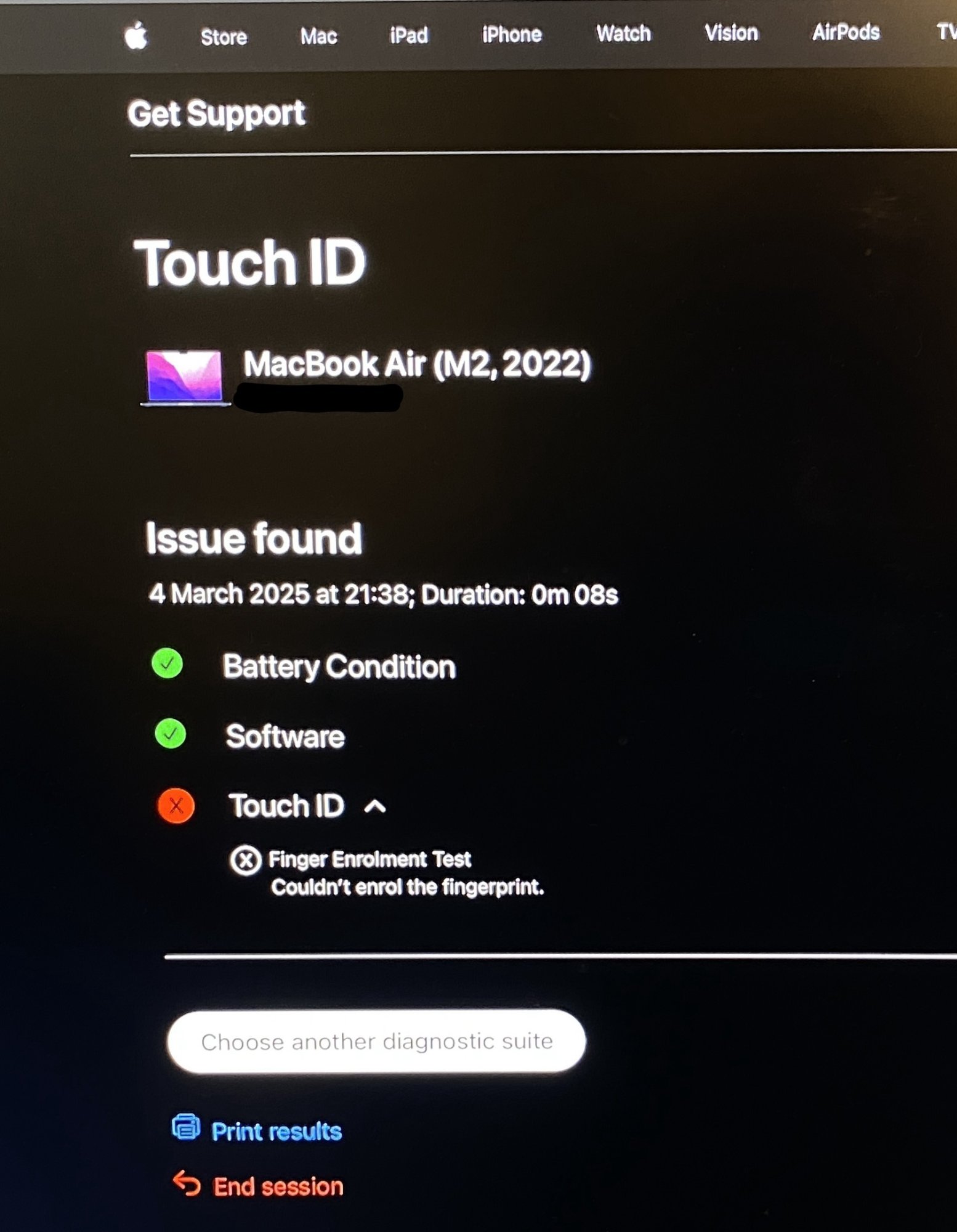

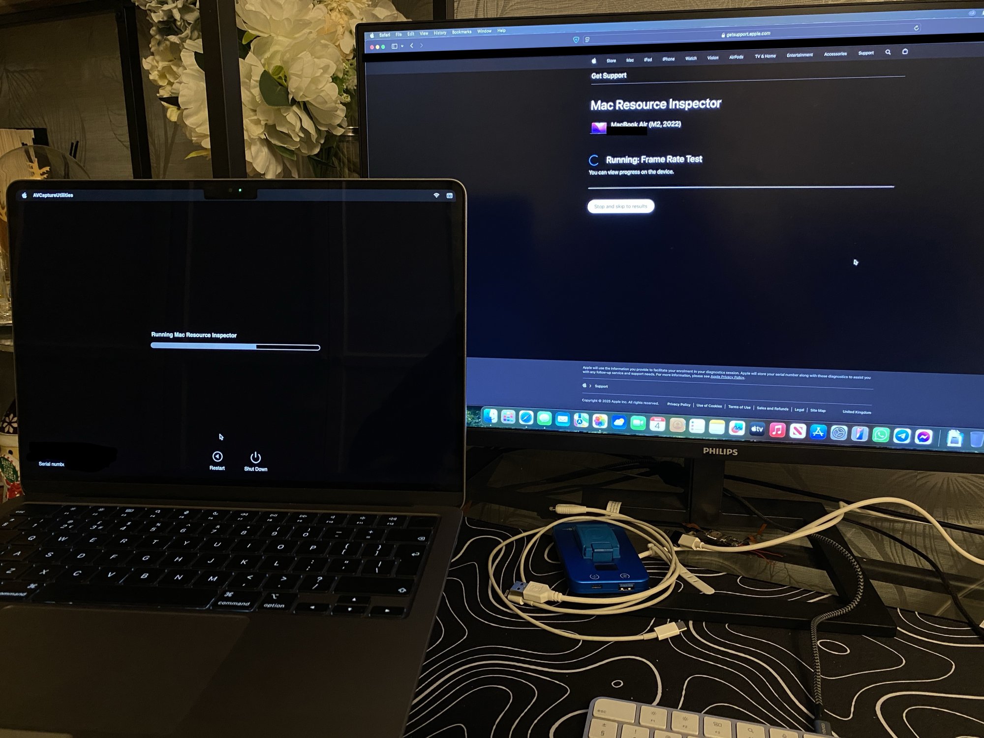

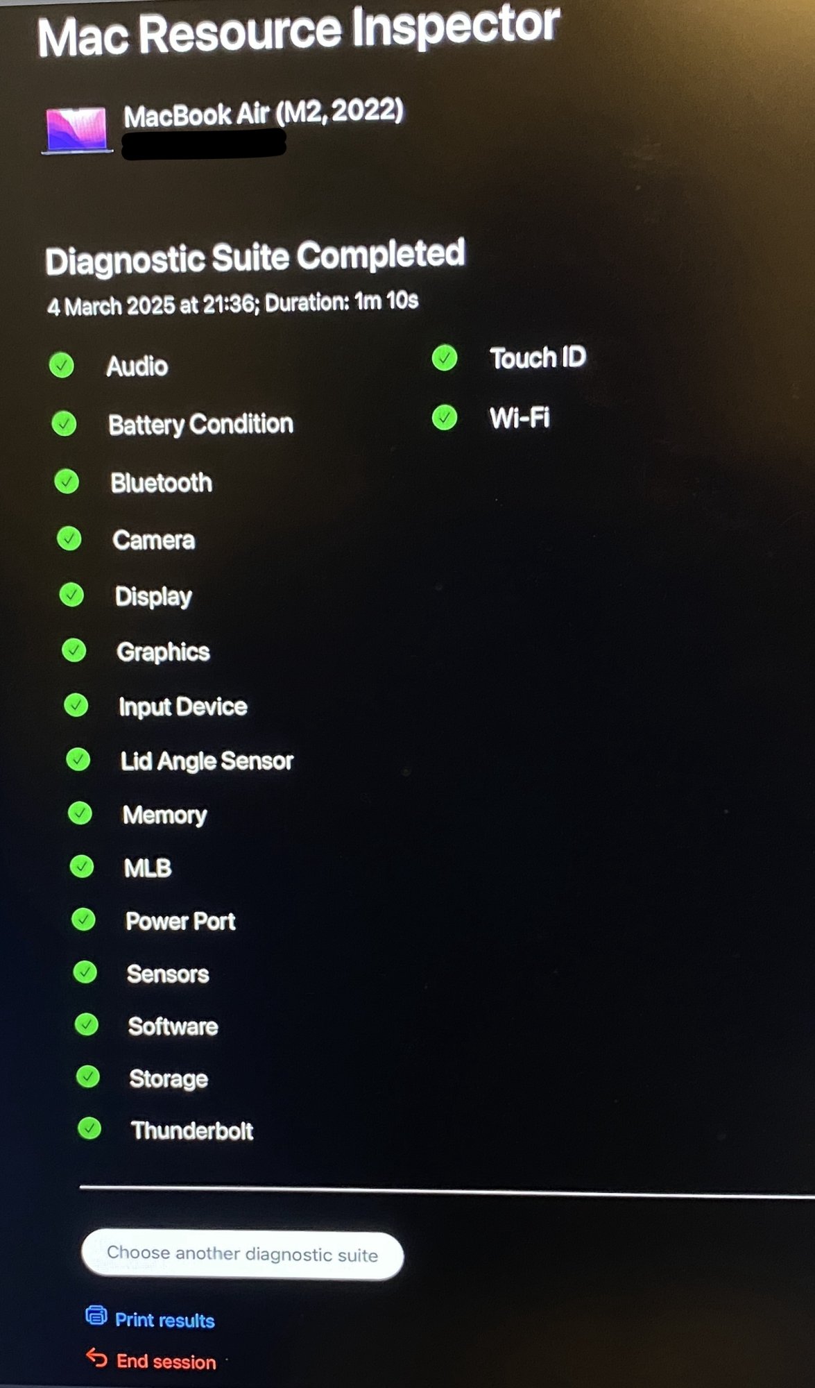

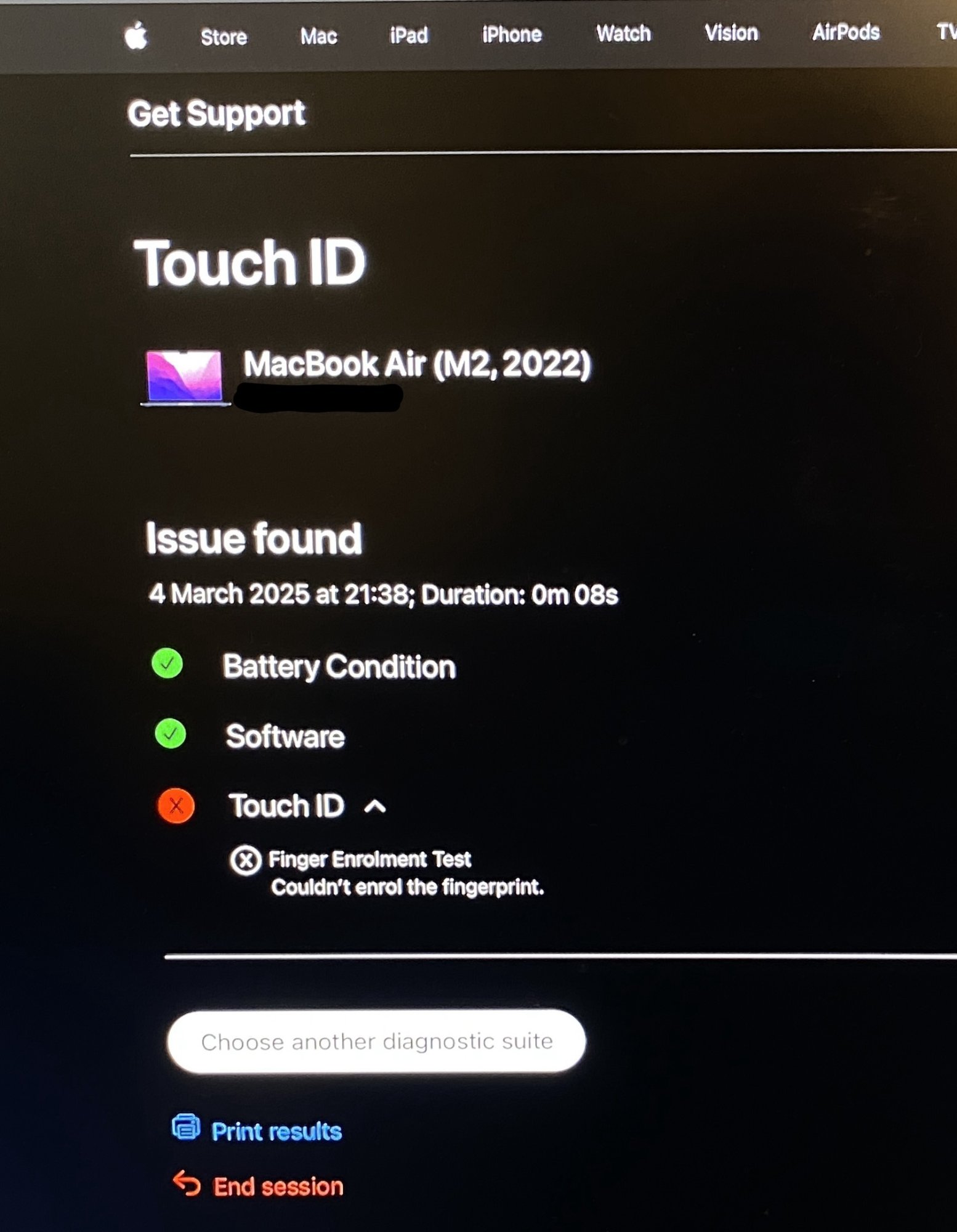

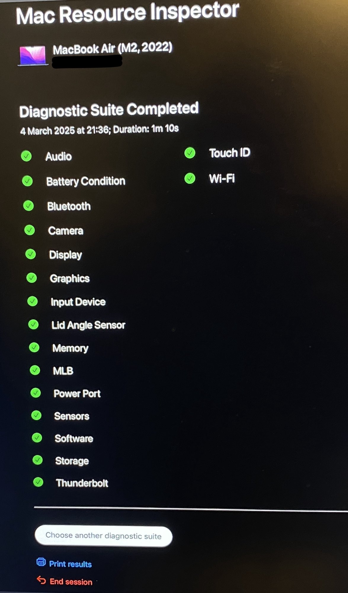

I also initiated a diagnostic suite session online on get support.apple.com to run an online diagnostic.

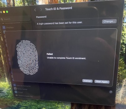

When I run the MRI interestingly the Touch ID was marked with a green tick.
But when I run the actual Touch ID test it came back with the error "Finger Enrolment Test Couldn't enrol the fingerprint."

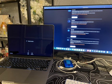

When I follow the link to System Configuration, it guides me through how to enter Apple Diagnostics—except we’re not running a diagnostics test.
Usually, to run diagnostics online, we have to request it through Apple Support and enter the machine’s serial number. This has to be initiated from another computer, which acts as a control interface for the diagnostic process.
Once requested, online diagnostics will start, and you navigate through the options on the other machine’s web browser.
Hope you’re following me! :)
Now, back to the repair manual...
It does NOT tell me to do anything online. Instead, it says:
When the Diagnostics & Repair screen appears, click “I agree“ to begin System Configuration.
It looks like Apple is going to open a session for my machine to configure it.

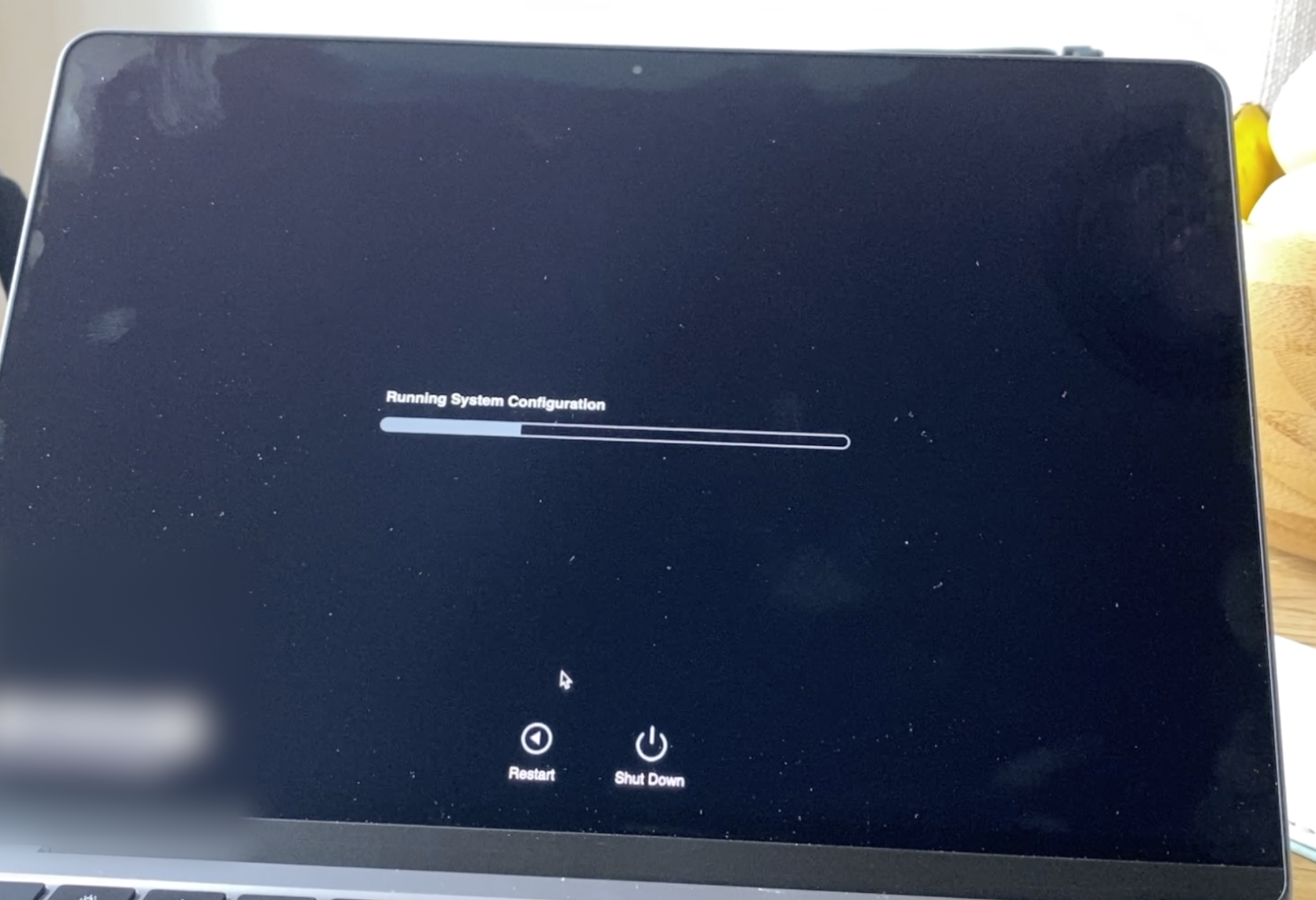

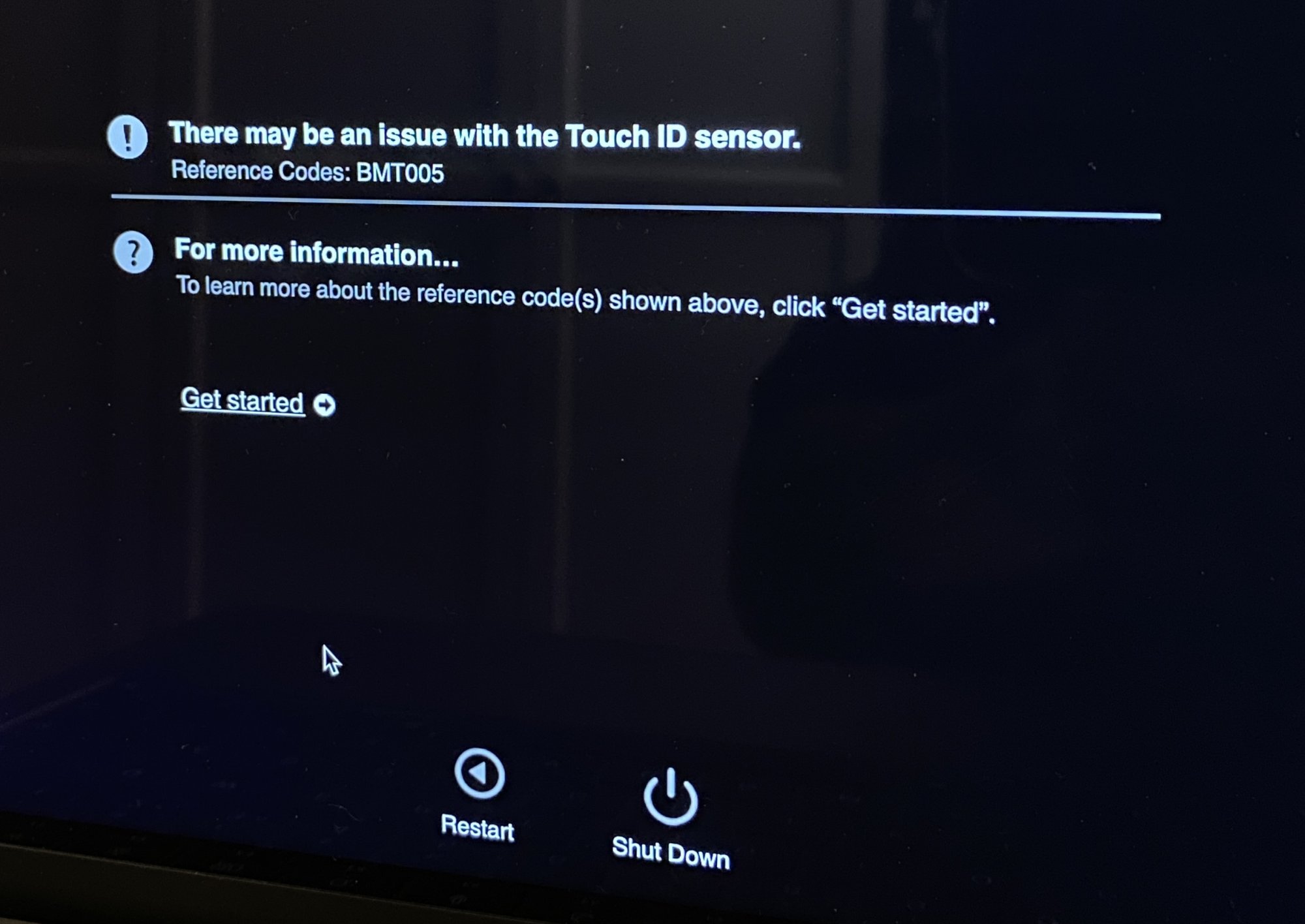

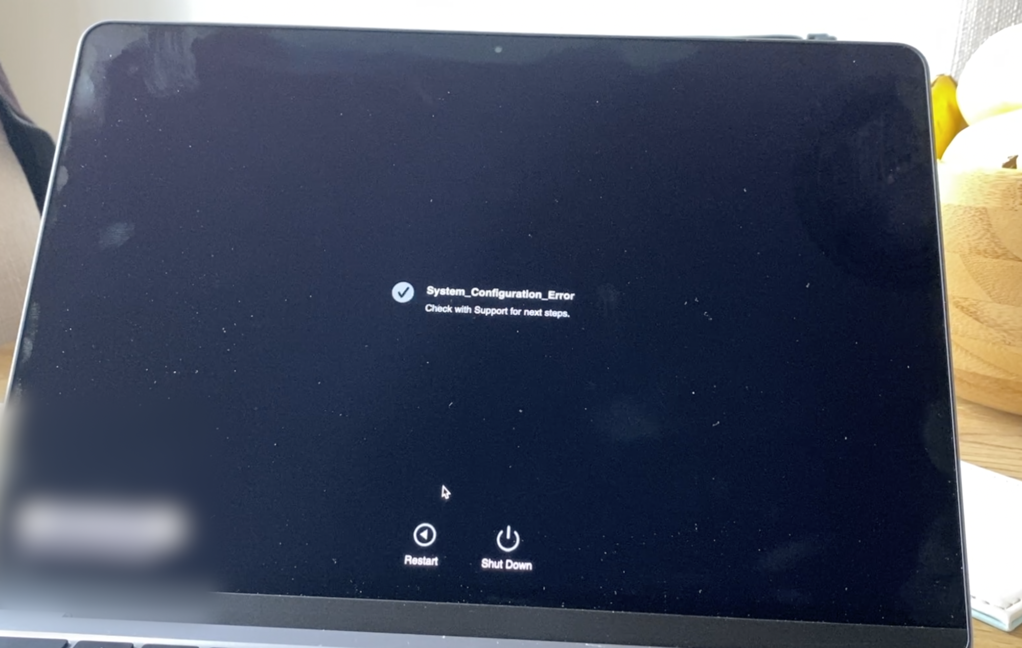

So, I ran diagnostics with the old original Touch ID still in the machine.
And yes—after agreeing to the terms and conditions on the diagnostics page, System Configuration started.
But... it was not successful.
The reason could very well be that they scan the serial number of the new Touch ID they dispatch, and the configurator only allows that specific Touch ID to be bound to the logic board.
Now, I just have to wait for it to arrive and install it.
Of course, I’ve used up my one-time access to System Configuration, so I’ll have to contact customer service to get it authorized again.
But it was worth the try! At least now I (we) know that this is a no-go.

After contacting the support team I was able to run the diagnostic / configuration again.
But even with the new touch ID the configuration still failed.

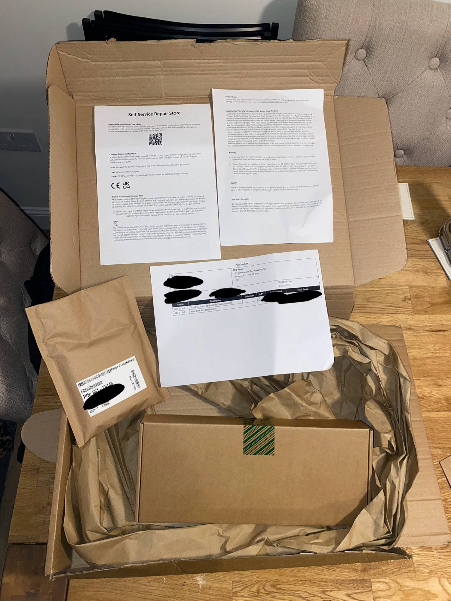

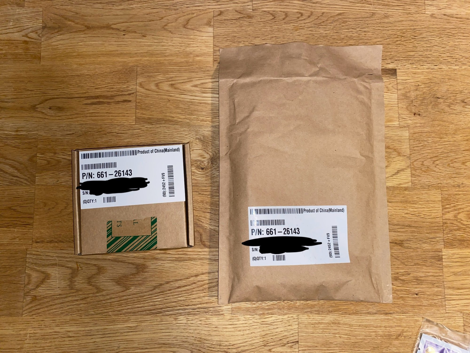

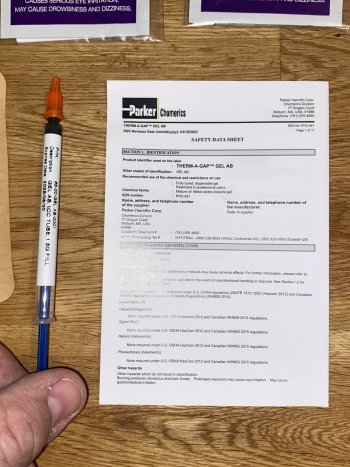

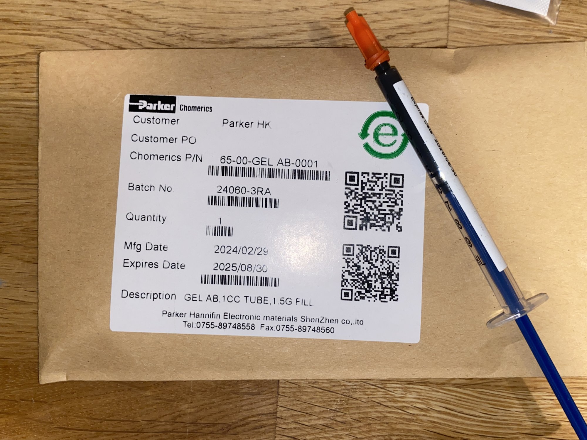

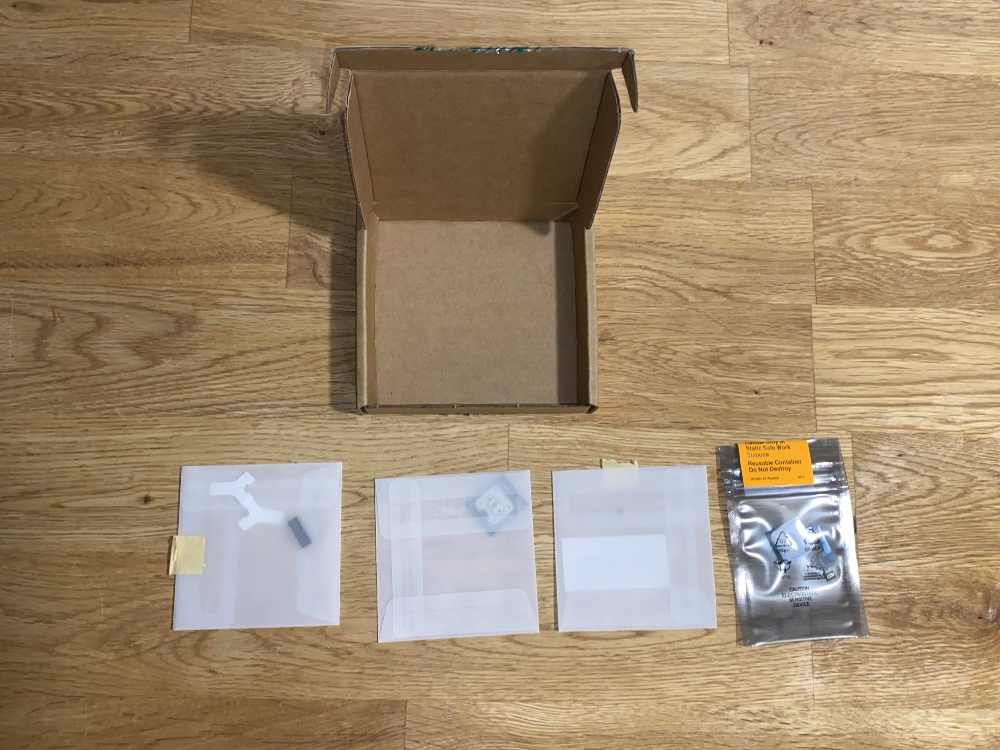

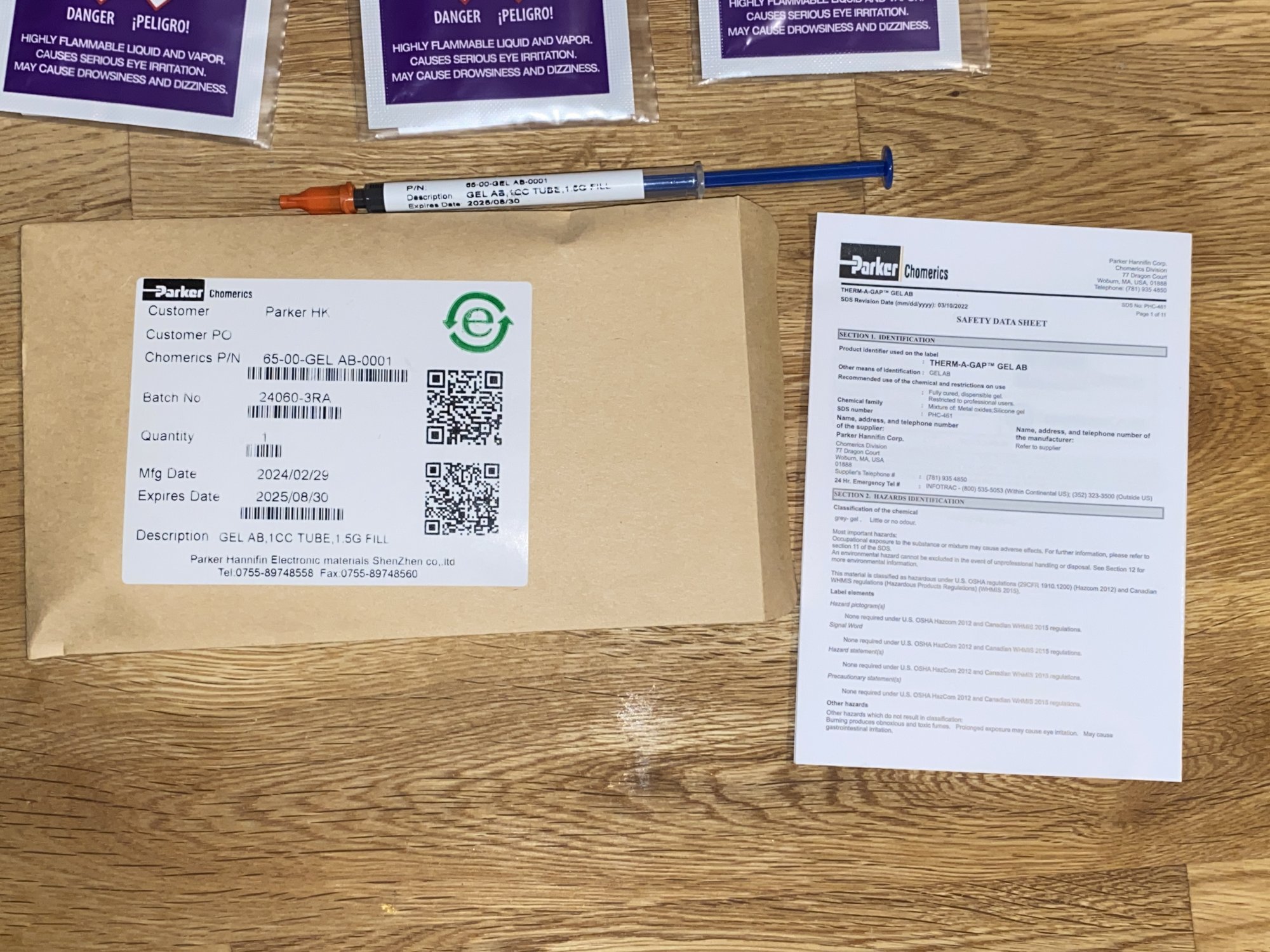

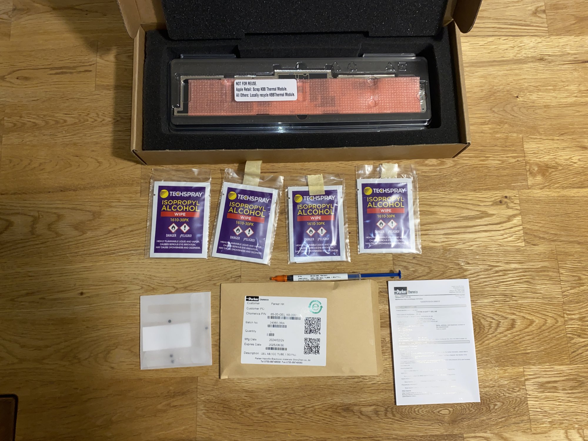

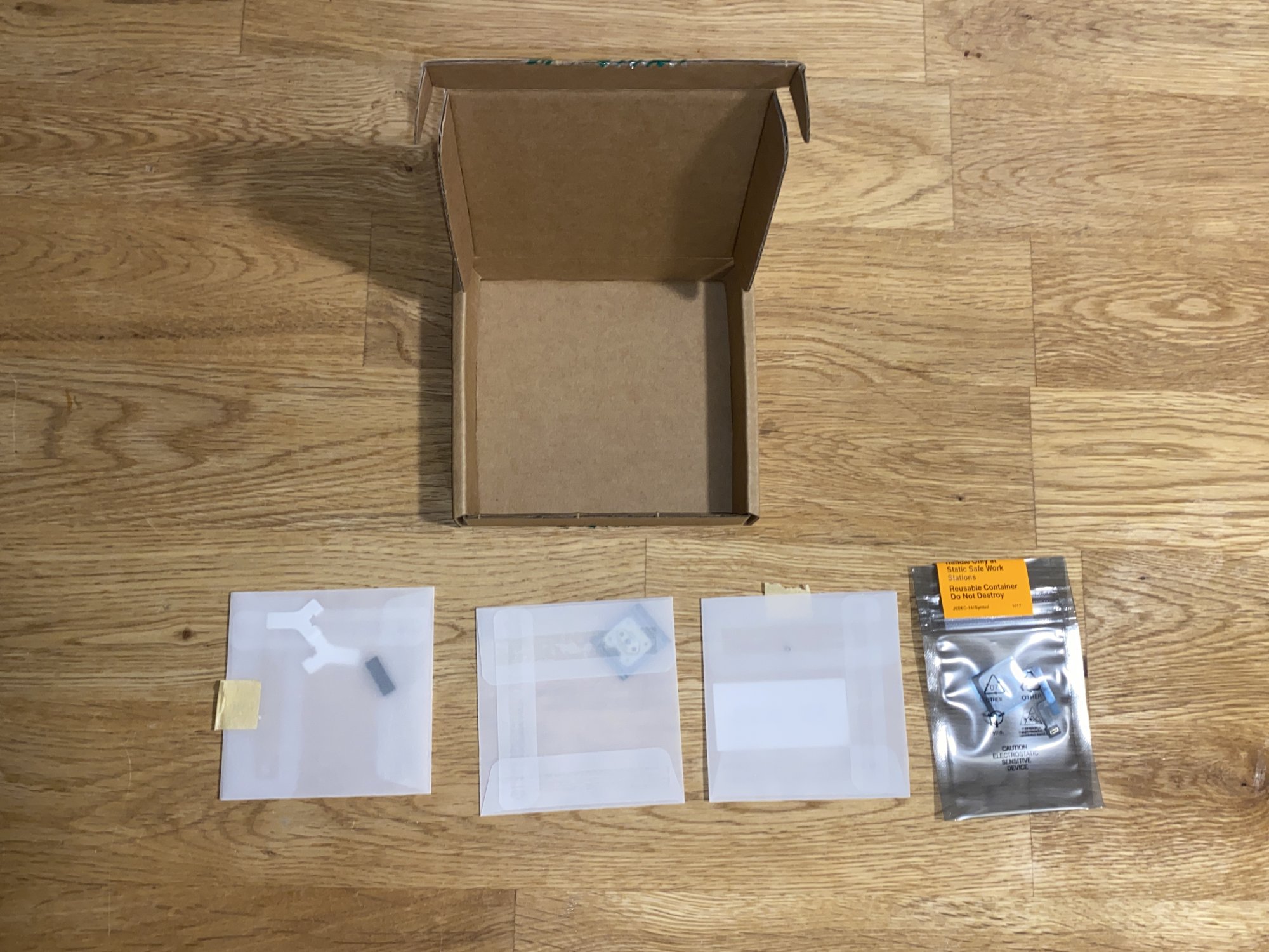

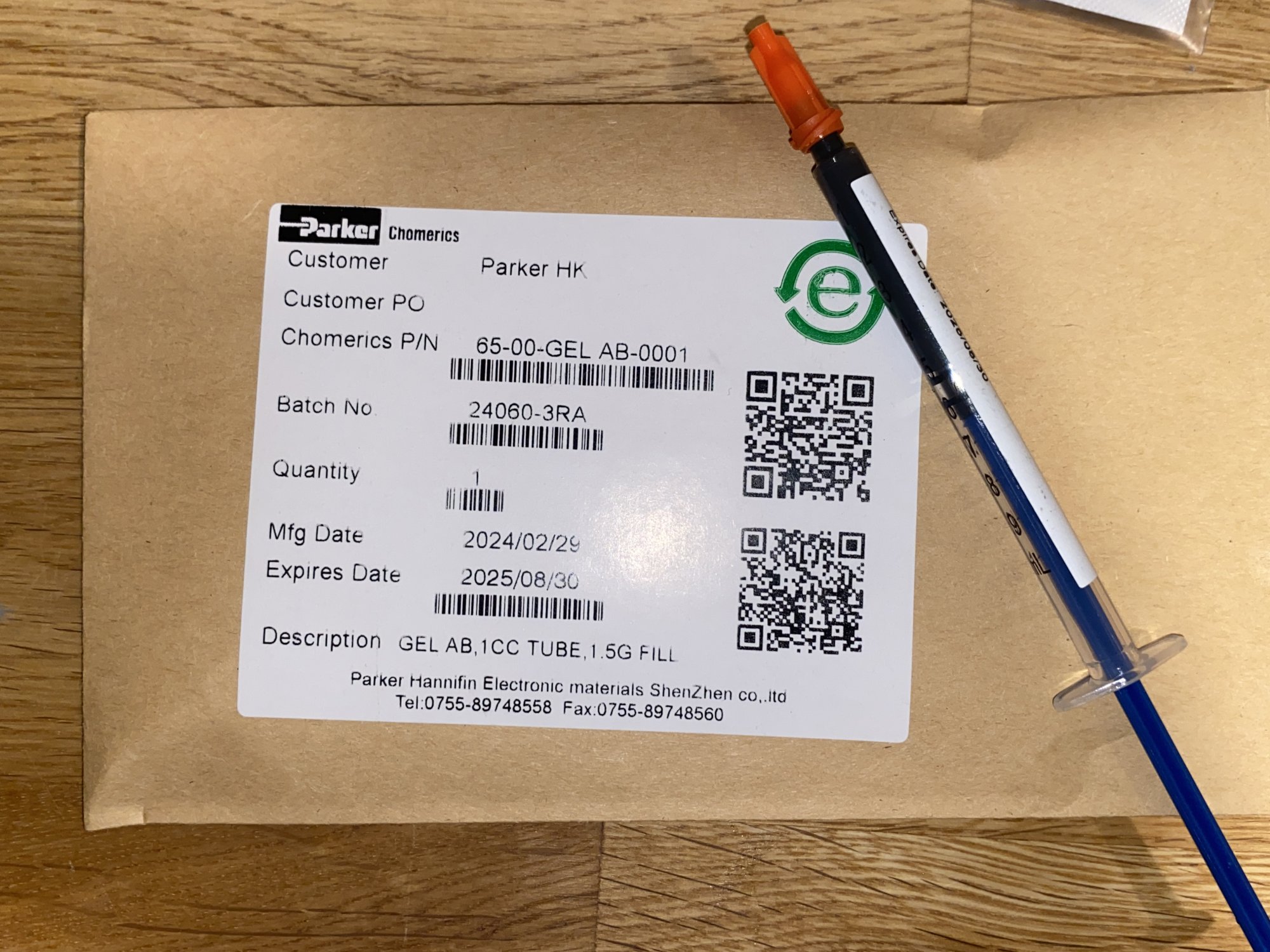

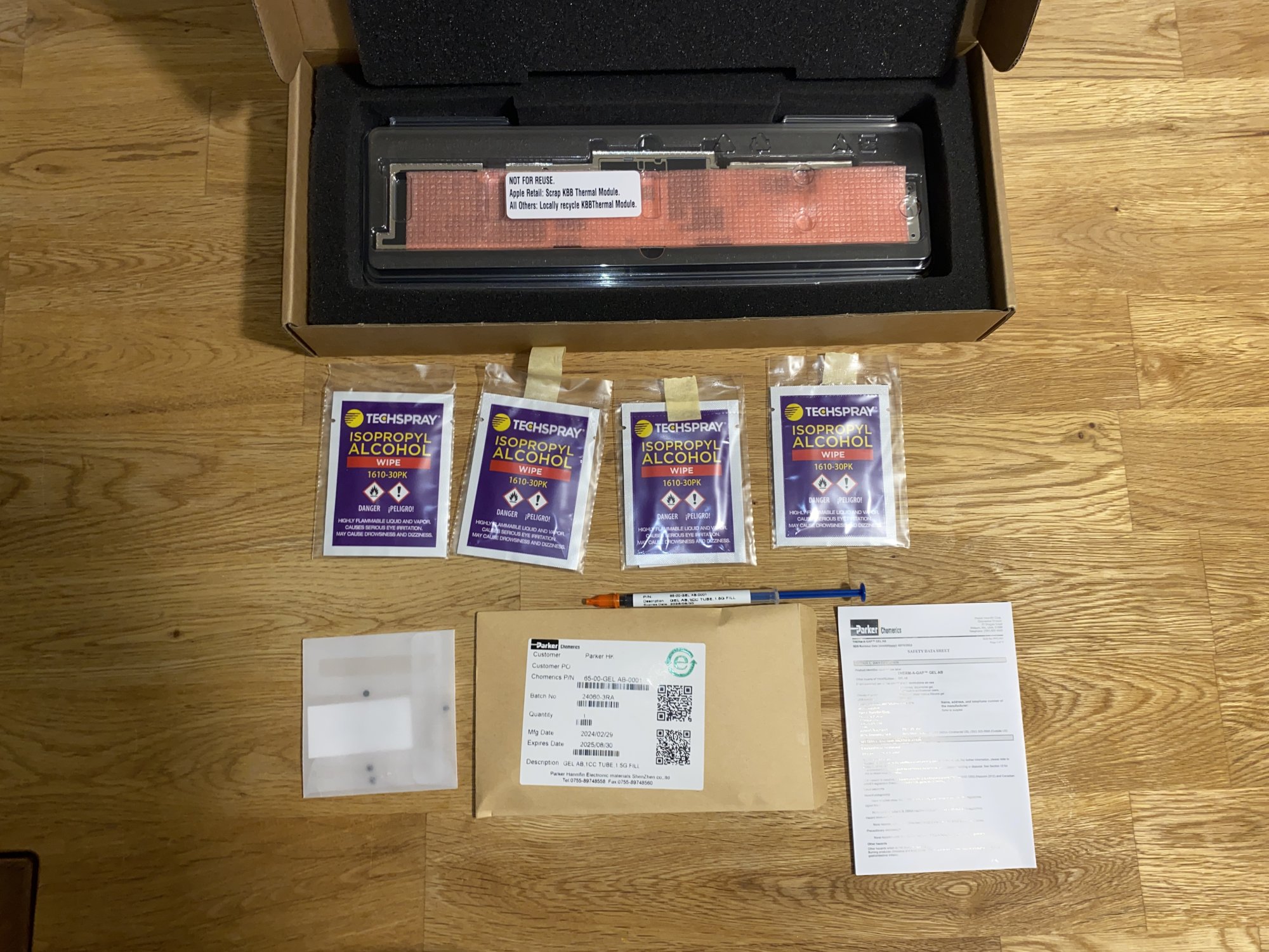

If anybody is interested what is in a touch ID repair kit from Self Service Repair Store here are some pics:
