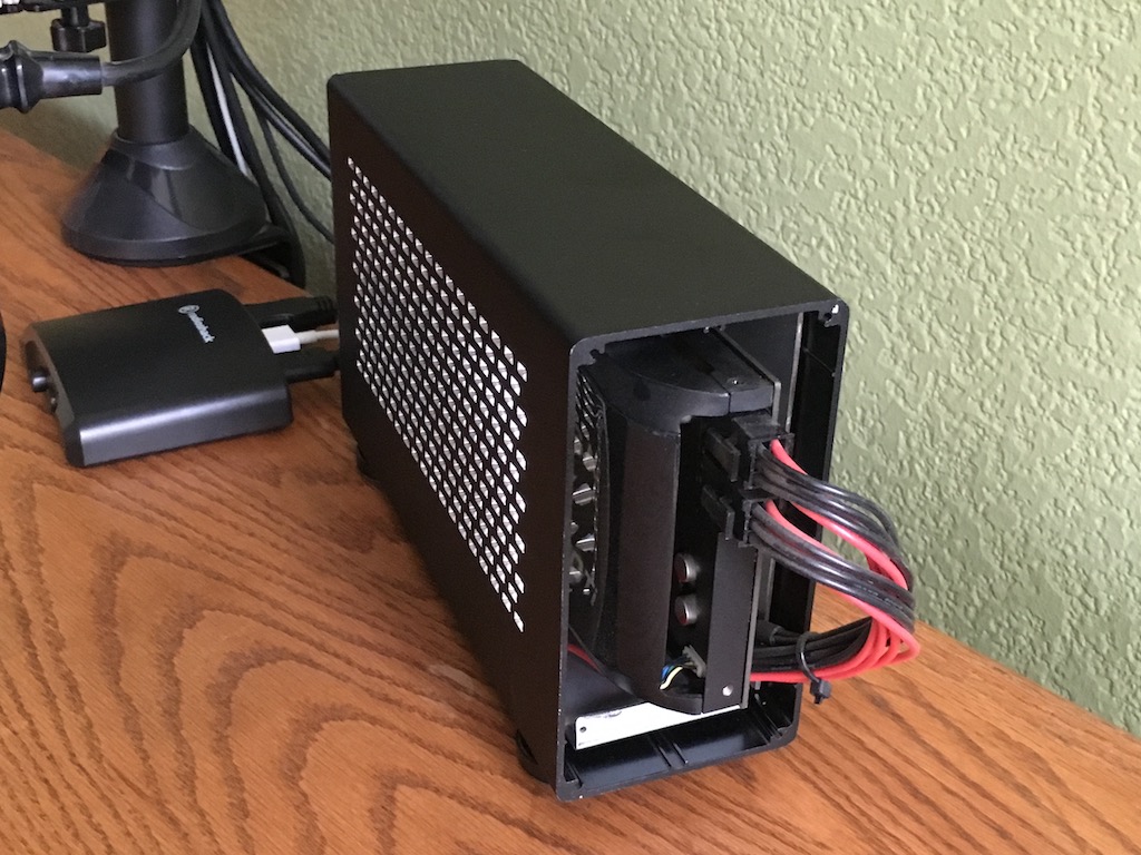

I picked up a secondhand BizonBox 2 on eBay. It came in conjunction with a GPU that I ended up being unable to use, but once I resold that, I think I ended up shelling out about $350 for the enclosure and 180W power supply. While this was a bit of cash, it's still a significant savings over the $600 that Bizon wants for their current Thunderbolt 2 enclosure. I was expecting a notch in the top of the enclosure for the power supply wires right behind the front cover (like I'd seen in pictures), but it turned out that this version had neither a notch nor a front cover, as it appears it was meant to accommodate full-length cards which stick out a little bit. The result is a rather unappealing look, but at least there appears to be plenty of air circulation.

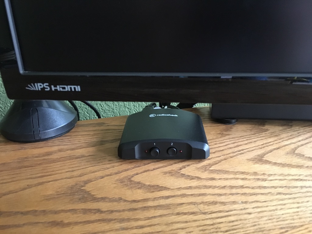

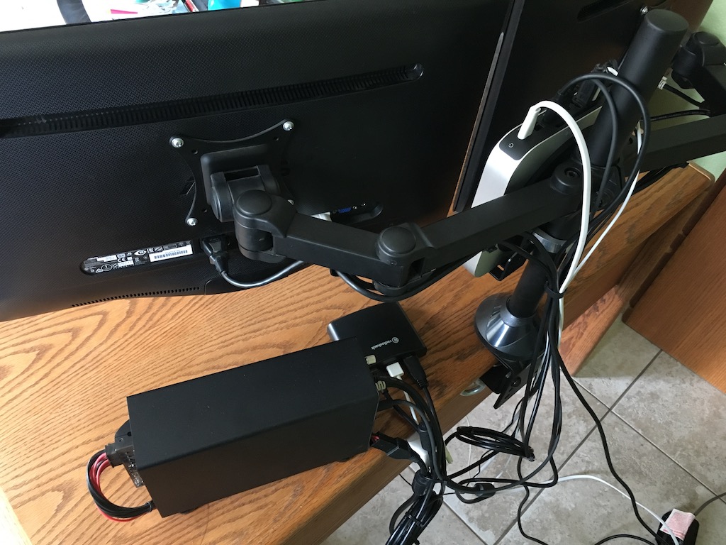

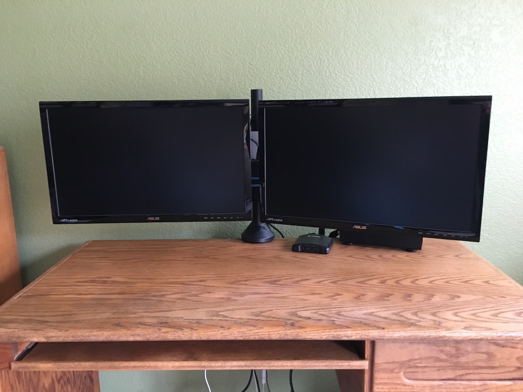

One of the issues with using an eGPU on macs is the lack of a boot screen (and the corresponding lack of FileVault support). It wasn't acceptable to me to abandon FileVault, so I needed another solution. The obvious solution is to plug your display(s) into your eGPU and then run a secondary connection between one display and your mac's built-in video output, so you get the boot screen/FileVault prompt through the built-in output and then it switches over to the eGPU. The issue with this is that your computer then may think you have three displays, depending on how it handles the two video cards and three display connections. On Windows, it's easy enough to disable the superfluous display, and I believe it isn't difficult on Linux either. However, on macOS, I was not able to find a solution that allowed me to fully disable the superfluous display. I tried SwitchResX as well as this tool but there were a lot of glitches, settings changing around by themselves, etc.
Ultimately, what I needed was something that would physically break the HDMI connection between my mac's built-in video output and the display. Ultimately, I went with this mechanical switch which appears to do just that. The options seem to be limited as far as switches go, which may be because such switches technically violate the HDMI spec (at least this is what people were saying on various forum posts on the topic). I run HDMI from my GPU to one of the switch inputs, and HDMI from my mac's built-in video output to the other switch input, and I run the switch output to the display. When I boot into Windows or Linux, I toggle the switch as soon as I select the OS I want with reFIND. When I boot into macOS, I wait until the system boots up completely, then toggle the switch.

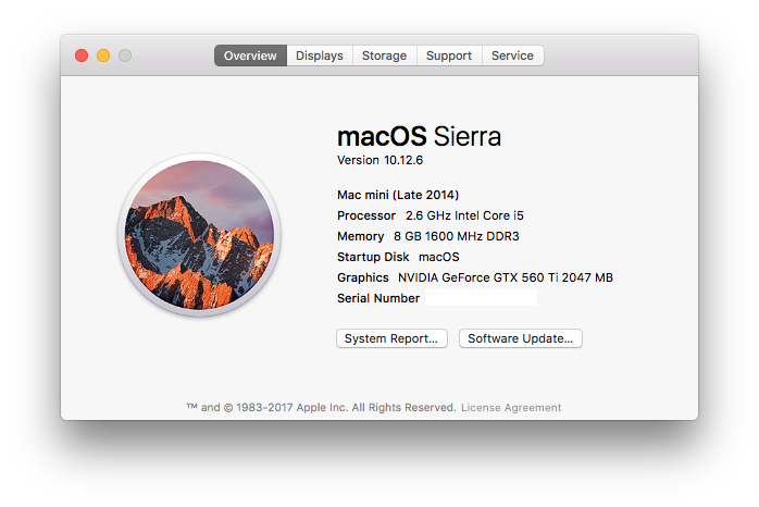

This is where I spend the majority of my time. Other than having to wait a few days to install a system update (so the NVIDIA drivers get updated as well), I really don't have any complaints as it's quite a stable system. Everything graphical is quite snappy, and gaming (what limited selection there is for macOS... bring me Overwatch, Blizzard!) is quite an improvement over the integrated graphics. All in all, I'm quite pleased with how everything is working.
