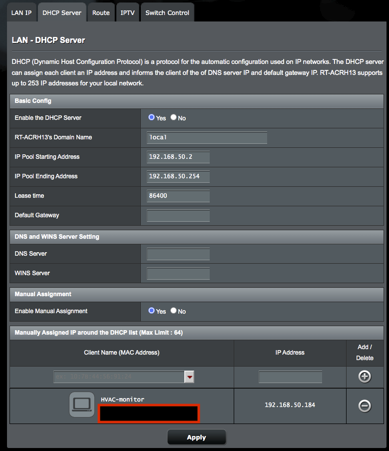

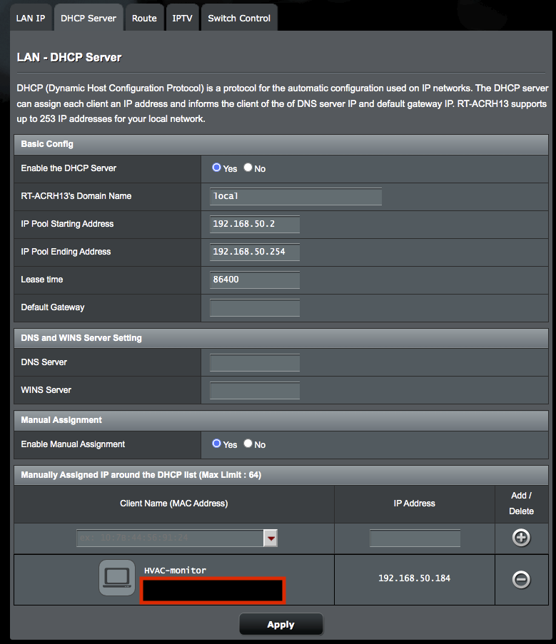

I went to AdvancedSettings->LAN->DHCPserver, where I did it, I believe. Here's a screenshot the screen (the hostname is actually HVAC-monitor, and I masked its MAC address). Oh, and you can see I assigned the domain name as 'local'. And I clicked "Apply" when done.
First, the static IP you've assigned "192.168.50.184" is in the range of dynamically assigned IP addresses (see your starting and ending pool IP addresses). This will definitely cause conflicts with other clients on your network. Recommend you set your pool starting IP address to "192.168.50.20" and use IP addresses between "192.168.50.2 > 192.168.50.19" for any manually assigned IPs.
Second, ".local" is reserved for mDNS (Bonjour or multi-cast DNS) and will create conflicts. Use "home.arpa" instead. It is the preferred internal home network domain name. So, if the feature works as we suspect, after the change to "home.arpa", you should be able to reach your system using "hvac-monitor.home.arpa".
