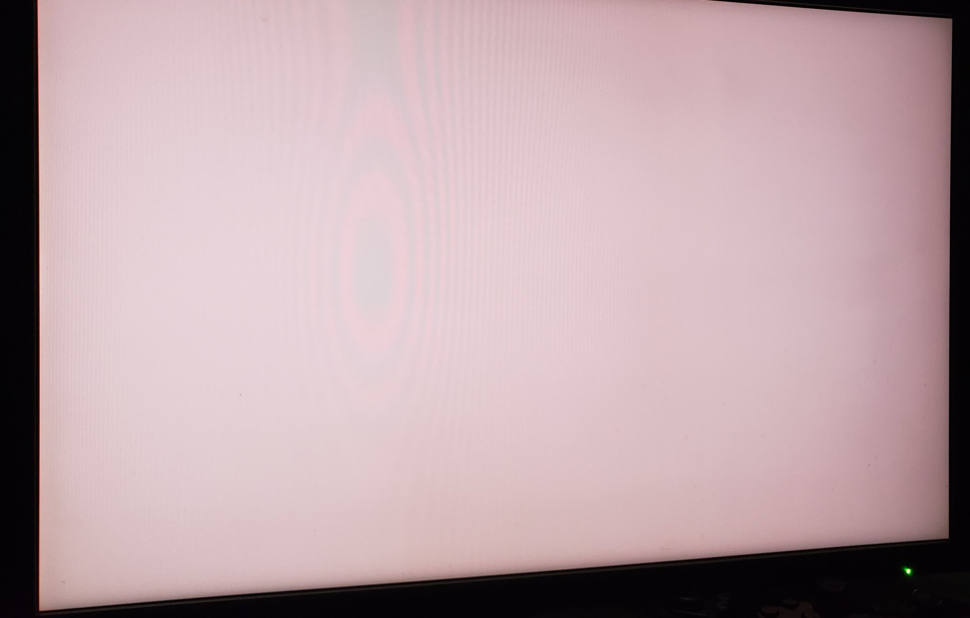

On top of that, when I hold option down when booting, I don't get any boot picker to choose the EFI. It's just a grey screen. And it will stay there until I hold the power button to reboot. It's been like this for a while, too.

grey screen when holding option when booting. It just stays here until I physically hold the power button to turn it off.

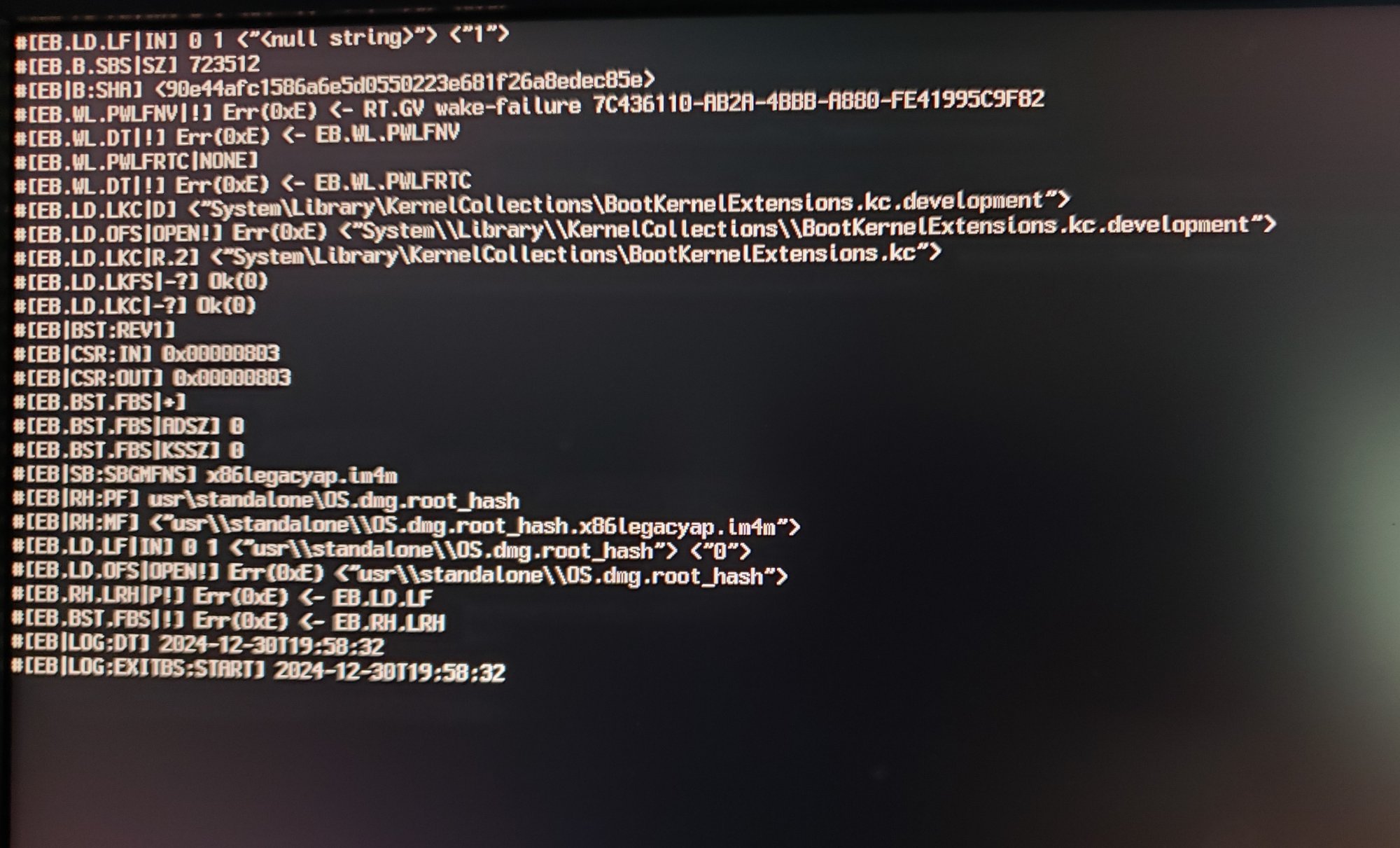

Sequoia installer and SSD with Sequoia originally installed on it hangs on Apple logo with no progress bar

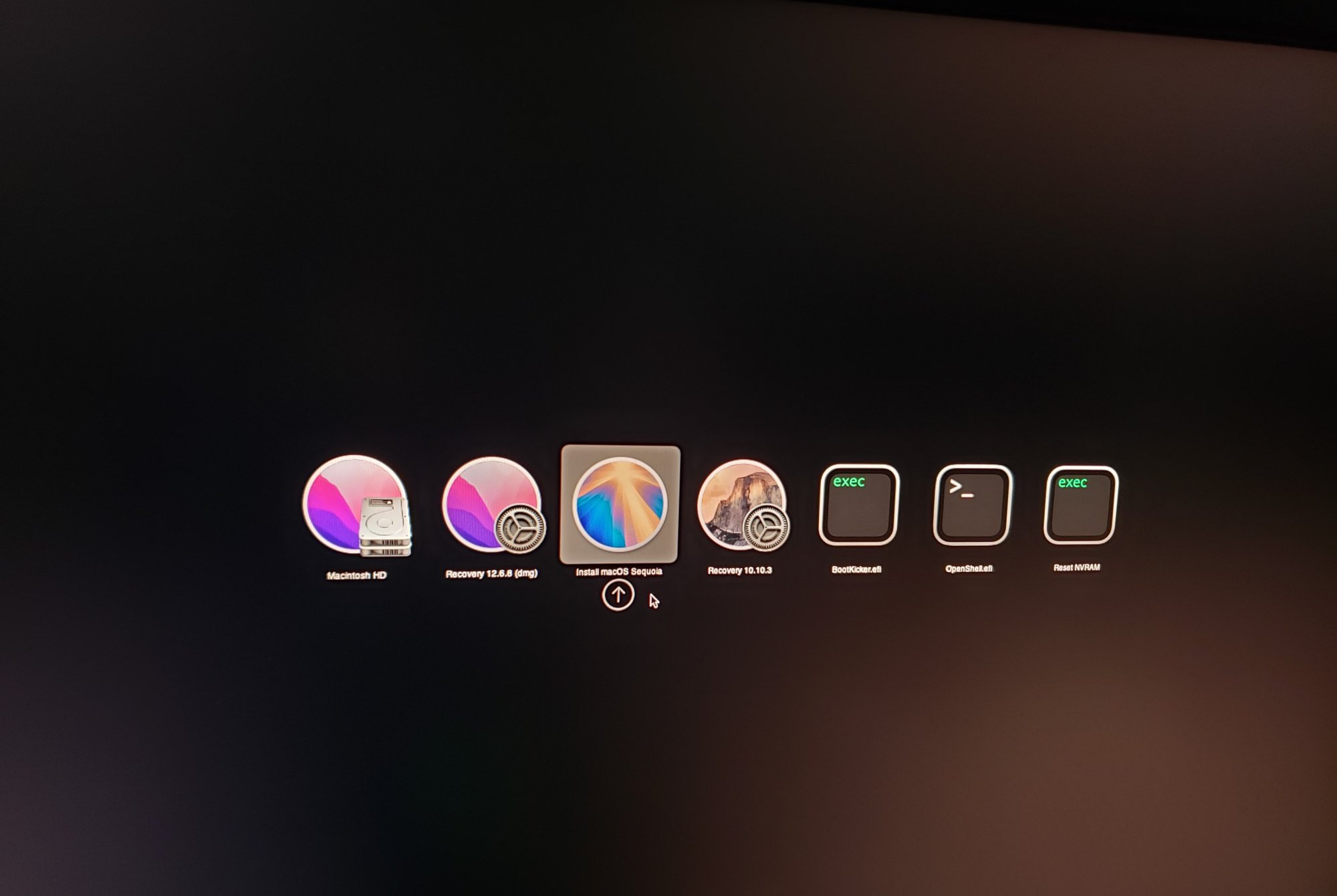

boot picker that comes up if I don't hold down option when booting. I hit spacebar before I took this image, so there's a lot more options than typical. Usually it's just the Macintosh HD and Install Sequoia options.

If that's the OCLP version that you are using, try booting to that installer. You need to hold Option to get the EFI choice, and, of course, followed by your Sequoia installer.
Do you get that choice for EFI, ever? Be sure to give it plenty of time, maybe 10 minutes should be enough.
I think if you never get the EFI choice, then something is wrong with your installer, and you should erase that and set it up again. Reinstall the OpenCore build on your installer drive, double check that it is version 2.2.0
Yeah, I'm on the most recent version. Both the Monterey drive and Sequoia installer are on 2.2.0. The EFI choices never come up when I hold option. It just stays at that grey screen and the only way out of it is to physically hold the power button and reboot.

What is that "BootKicker.efi" showing on your bootpicker screen?

Boot, holding Opt-Command-p-r, to get an NVRAM reset. Keep holding those 4 keys until you hear the boot chime 2 or 3 times, then release keys, except continue to hold Option. If your Sequoia installer is attached, do you now get the EFI drive icon? or the screen simply stays grey, and nothing else happens? Keep holding the Option key. I think you can decide that nothing else will happen after 5 minutes tops. You COULD try removing all storage devices from the 4 drive bays, just as a test to see if you can get your MPro to boot to only the NVMe card.

Not sure what BootKicker.efi is. I hit space bar before taking the pic thinking maybe I could change EFIs from it.
Tried resetting NVRAM till it chimes 3 times and it still just hits the grey screen with nothing when holding option.

i tried several times running recovery and mounting the EFI on the install drive, then using the bless command pointing to the EFI/System/Library/CoreServices/boot.efi file, but that hasn't worked and it still stalls at the apple logo with no progress bar. selected the install drive and held cmd+V to get verbose mode. Not sure if this helps, but this is all that appears.

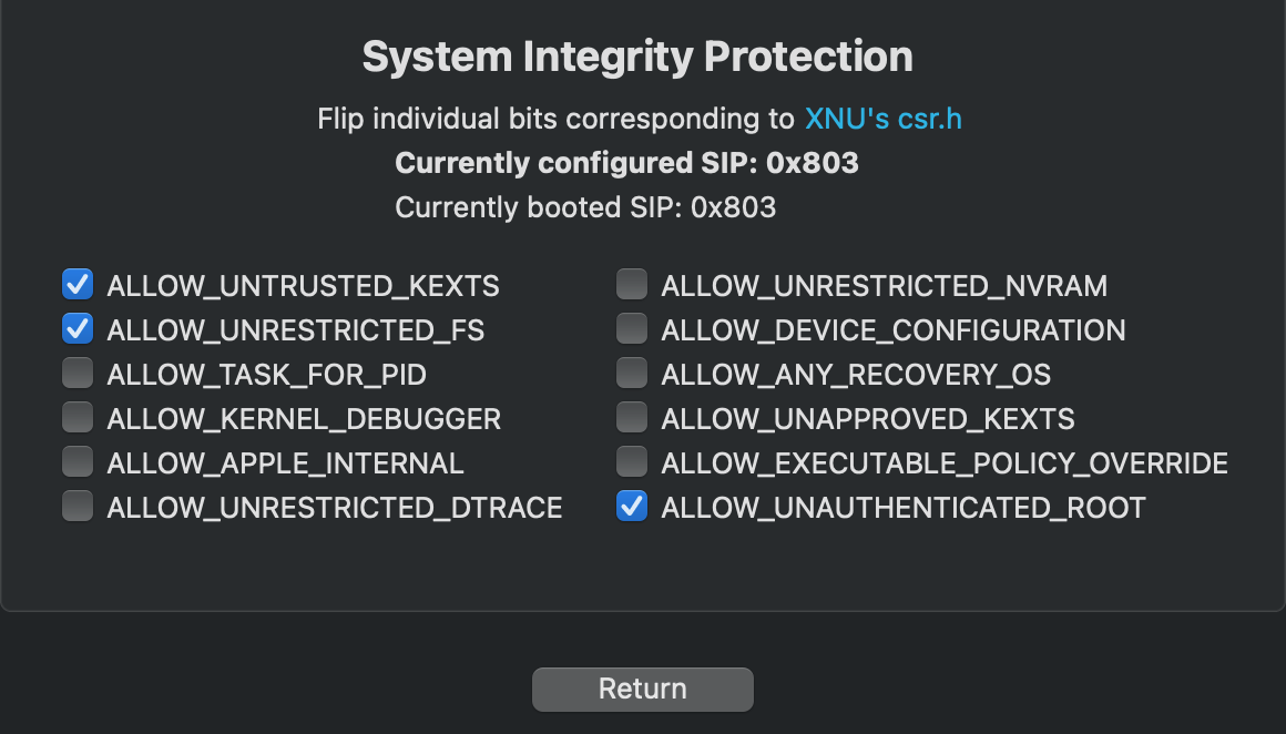

Could the issue be my SIP settings? Are there specific ones that need to be allowed to install Sequoia?
nah, OCLP set those details up, correctly.

Ventura - Same issue with Apple logo w/ no bar and stalls
Sonoma - Same issue with Apple logo w/ no bar and stalls
Sequoia - Same issue with Apple logo w/ no bar and stalls
I even took out all the other drives and only left the NVMe and USB install and tried switching to every USB port on the machine. I have a 4 port USB 3.0 card that's taking up a PCIe slot, so I tried all those, along with all the default (is that right word?) USB ports, and a USB 2.0 hub I had lying around. Still the same issue with Apple logo w/ no bar and stalls when trying to install anything above Monterey.
