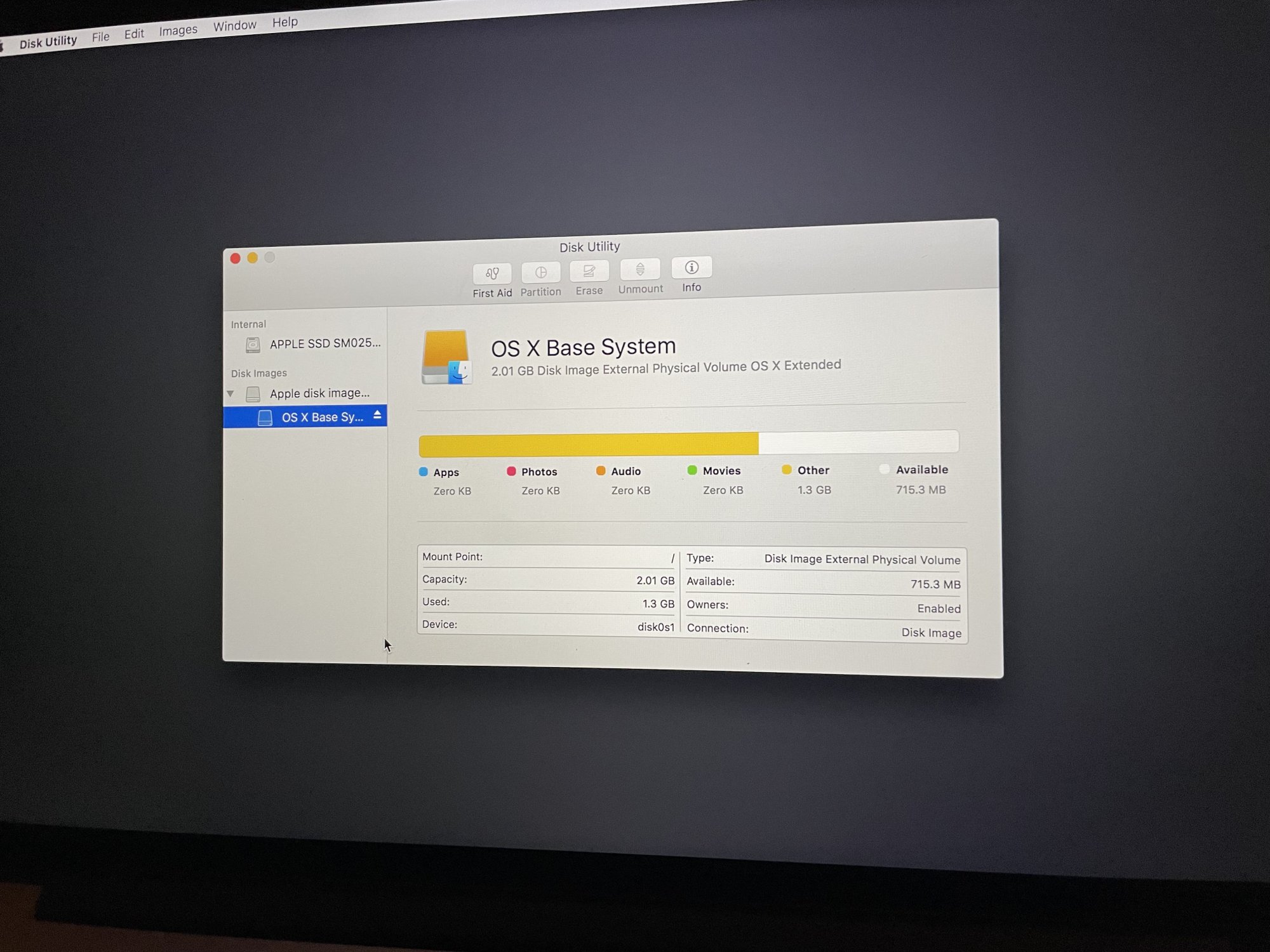

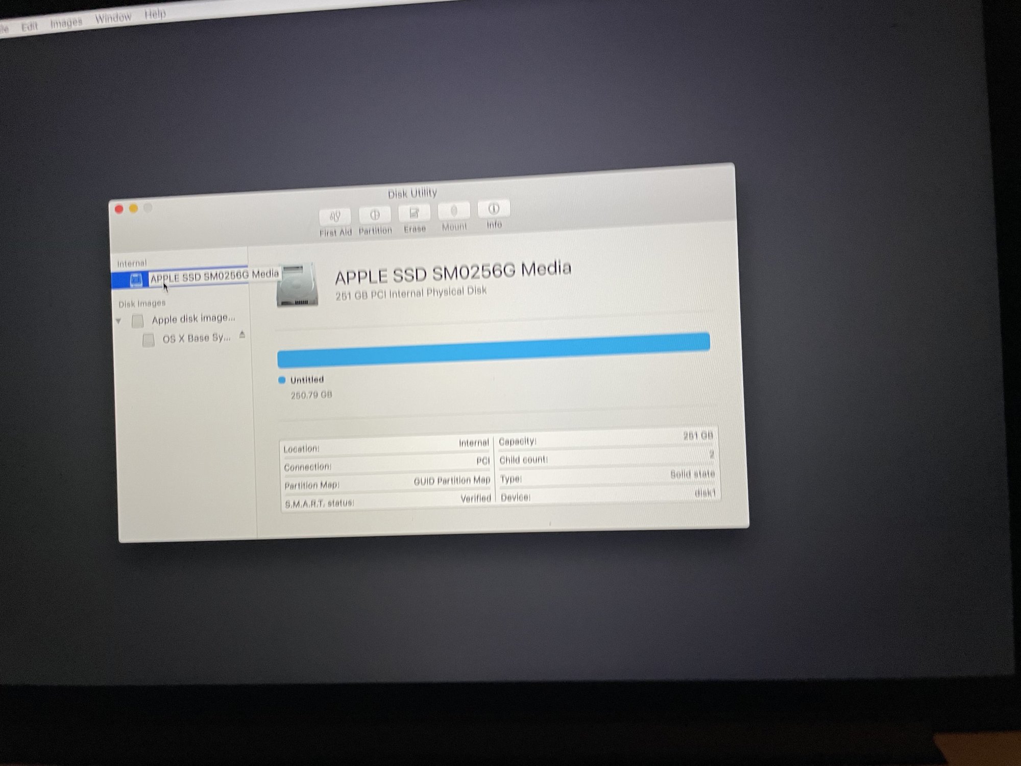

I've booted up into disk utility, and erased my drive successfully.

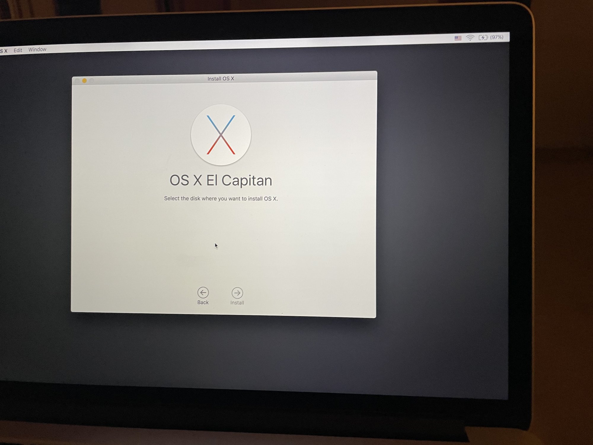

I then exited disk utility to reinstall High Sierra from a bootable USB I created years ago when I did a clean install. Unfortunately it says it can't do this because the install location is damaged. So I reboot and try to install via Apple's download and install process. It goes through a few steps from the OS Utilities page and wants to install OS X Catalina (I guess this must have been the OS that came with the computer when I bought it). However, it then asks me to choose the disk I want to install it on, but nothing is present for me to choose!
Now I'm stuck. What do I do from here?

So I managed to find a workaround, which was to partition the HD as I hadn't done that. This allowed me to install OS X. I've now updated (not clean installed) to Mojave and am creating a bootable drive for Big Sur. I'll follow the original process again to erase the disk and then install Big Sur, giving me a clean install.
