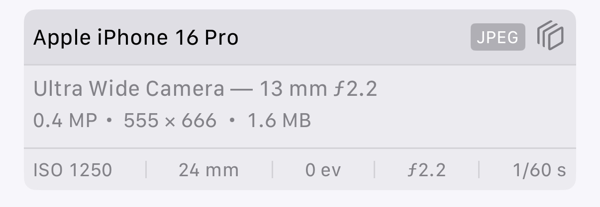

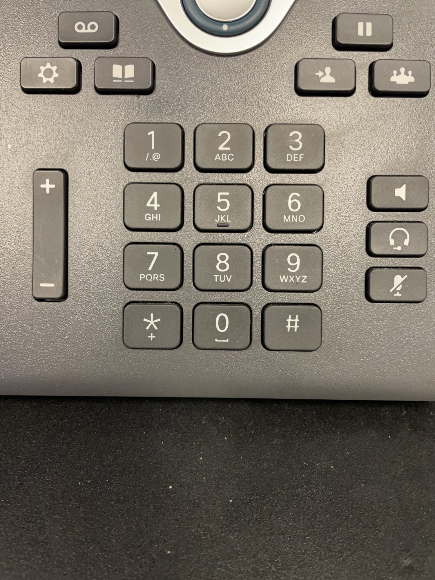

I haven’t been all that impressed with my iPhone 16 Pro camera since getting it. I’m hoping I just have some settings wrong. Skin always looks blurry, like clay if that makes sense. And the pics just don’t look as sharp as with my iPhone 13 Pro. So I did this test. Pictures taken of the same object, in the same room, with the same lighting. Phone in a holder and used the timer to eliminate any shake. Taken from the same distance.
iPhone 16 Pro
iPhone 12
At a glance, you can tell the iPhone 12 pic is sharper.

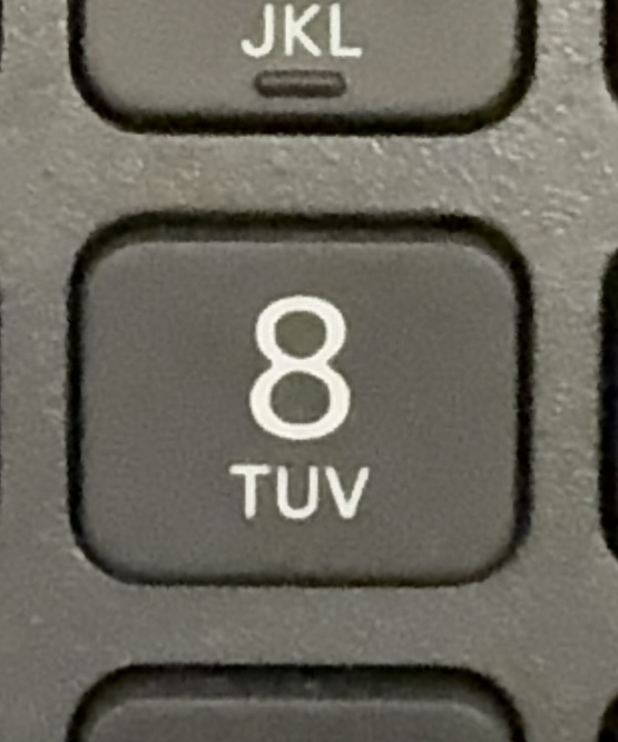

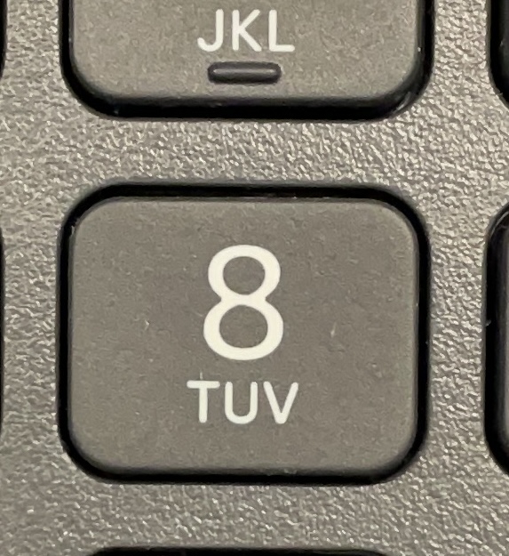

Cropping to a much closer view, you can really see the difference.
iPhone 16 Pro
iPhone 12

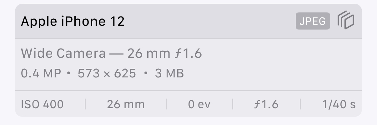

Stats after cropping:
The ISO is way higher with the 16. I don’t know why.
So is there a setting I’m missing somewhere? Do I maybe have a problem with my phone?
You are using Ultra-Wide camera (which is lower quality both lens and sensor) on the i16pro and main Wide sensor on the i12 - the main lens will always be better than either Ultra-Wide or Tele...
Because the aperture is significantly smaller on the ultra-wide (f/2.2) than on the 12's wide (f/1.6). Less light getting to the sensor means it needs to up the ISO significantly to prevent the photo from being under exposed. Higher ISO means more noise means more of the usual iPhone heavy-handed post-processing to try to remove noise, which also kills detail. The difference in your two photos is perfectly understandable given this. Add on top of it that the ultra wide in the 16 Pro crams 48MP into a tiny sensor means it's going to really struggle to perform without enough light.
So why is one on the wide lens and one the ultra-wide? You're getting too close to your subject so the 16 Pro is automatically jumping to macro mode which uses the ultra wide camera. Your iPhone 12 had no macro mode. Eventually, as you got closer to your subject, it would be unable to focus at all and the photo would go fully blurry, while the 16 Pro would still be able to focus as you got right up against your object. This is both a benefit, and something to be aware of: The focal distance of each physical camera (ultra-wide, wide, and telephoto) is going to be different, and different between each iPhone model. Focal distance is how the camera app determines which physical camera to use, a process that is (unfortunately) completely opaque. It's something you need to be aware of when framing a photo.
When you hit one of the magnifiers on the camera app (0.5x, 1x, 2x, and 5x) you're choosing a magnification relative to 100%, not necessarily the camera that the app will use to take the picture. The app chooses which camera to use based on focal length and available light.
Computational photography is magic, but physics is physics, and photography is about light.
