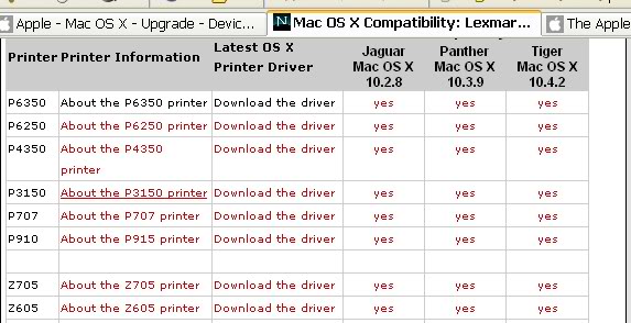

Here we go:
Whether that is the model that this Dell printer actually translates into, I don't know - Lexmark uses the same plastic body for at least 3 different lines - z6xx has a few models.
Don't know what the hardware difference is.
The Z605 and Z615 use the same driver. You may even be able to use the Lexmark driver with the Dell firmware, give it a go :)
Yes, now I'm confused...sorry... Have you actually tried that, Shrout? Just downloading the Lexmark driver and forcing it to use that driver?
I haven't given that a shot yet, and I guess there could be no harm done in that except that I've found a few posts which state that the Dell printer will not recognize the Lexmark drivers:
http://www.linuxprinting.org/pipermail/macosx-list/2004q4/001171.html
You'll see there that the user has tried that. I'll probably try it myself anyway.
