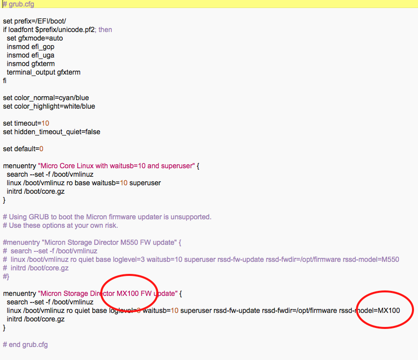

I used the download that alex0002 posted: grubefiusb-0.03.zip
You will need a text editor such as BBEdit or Text Wrangler to cange the grub.cfg because it is hard coded for the MX100.
I am a newbie for this kind of thing... Is there a text editor for Mac that would accomplish this task? Is it fairly easy to do for someone that has no programming skills? I am nervous that if I do something that is wrong while updating the firmware of the M500, that it may end up being a bad end result (maybe render the computer unusable)...

You can get Text Wrangler here; it's free and it's Mac software: http://www.barebones.com/products/textwrangler/download.html
You are only going to need to change the code in two places of the grub.cfg file (from MX100 to M500)

I did that with the MX200 files and Worked!!!!
In EFIBOOT usb:
* boot/core.gz
* boot/isolinux
* boot/vmlinuz
* cde
* EFI/boot/unicode.pf2
* EFI/boot/bootx64.efi
* EFI/boot/grub.cfg
I made changes in grub.cfg replacing M550 to MX200:
#menuentry "Micron Storage Director M550 FW update" {
# search --set -f /boot/vmlinuz
# linux /boot/vmlinuz ro quiet base loglevel=3 waitusb=10 superuser rssd-fw-update rssd-fwdir=/opt/firmware rssd-model=M550
# initrd /boot/core.gz
menuentry "Micron Storage Director MX200 FW update" {
linux /boot/vmlinuz ro quiet base loglevel=3 waitusb=10 superuser rssd-fw-update rssd-fwdir=/opt/firmware rssd-model=MX200
Thank you!!!

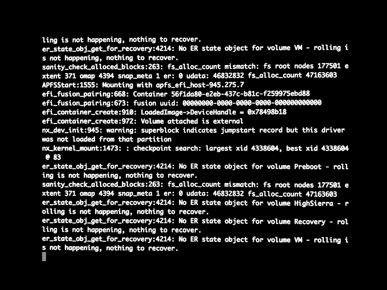

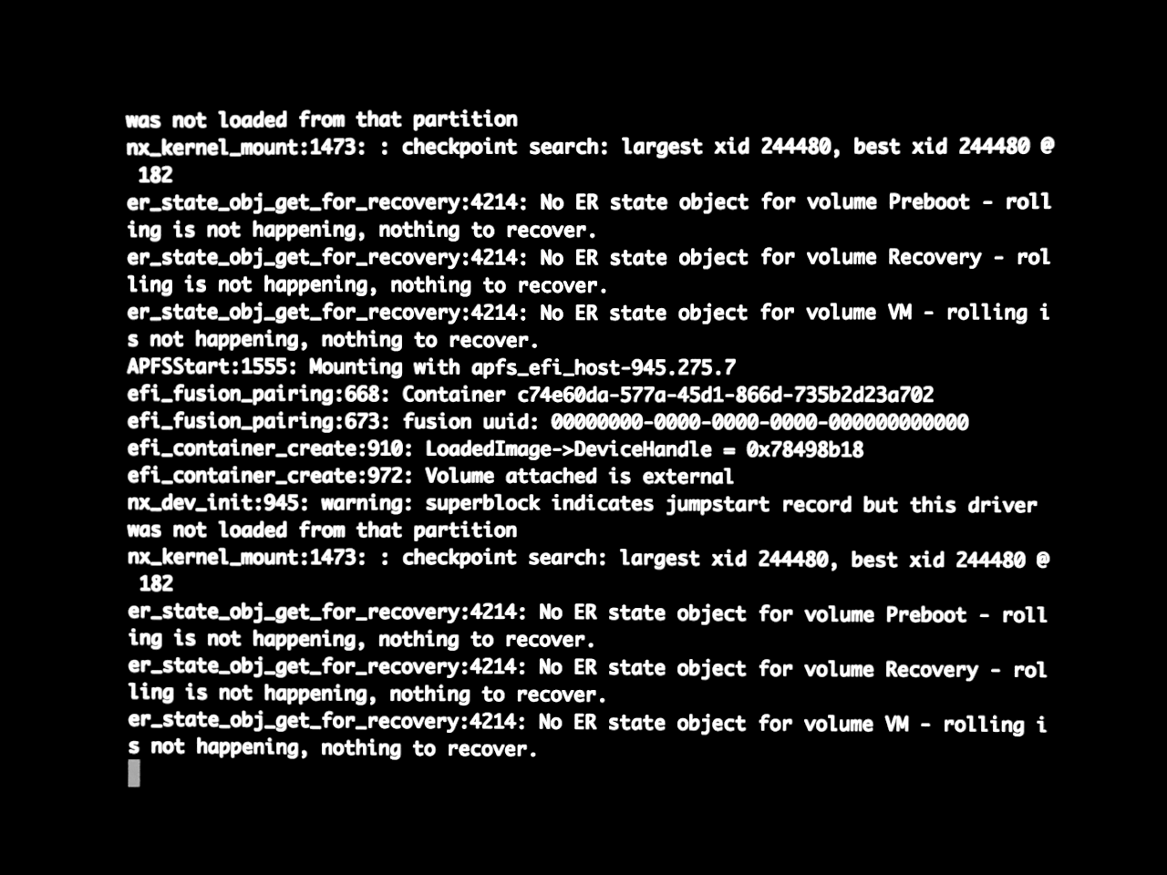

…And here we are, in August 2019. Does the method described here work with newer Macs that include the T2 security chip? My efforts over the course of several hours (!) with my 2018 Mac Mini have been unsuccessful; attempting to boot from the flash drive prepared per the instructions posted here fails, with a rather lengthy error message being presented in plain text, terminal-style, which includes this warning: "superblock indicates jumpstart record but this driver was not loaded from that partition".
Here are photos I took of the entire error text that appeared on my screen, on each of two different attempts:
(example #1)
(example #2)
