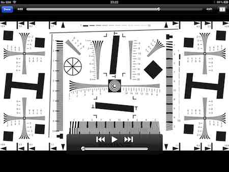

Here's a 16:9 movie (my well-known resolution chart video available for download HERE) not filling in the (much taller) screen vertically in the built-in stock Videos app:
(as with all the other screenshots in this article, click for the original!)

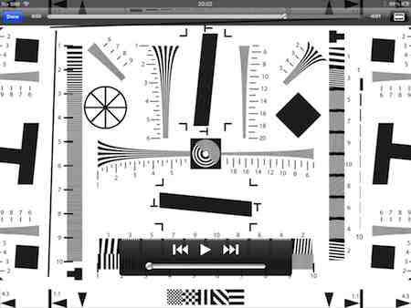

The Videos app can't stretch. When you tap the zoom icon in it, all it does is zooming in. This, while does keep the original aspect ratio (and, consequently, doesn't distort the picture), chops off the left and right part of the video as is shown in the next screenshot:

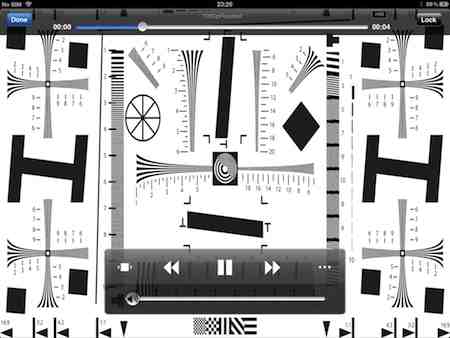

Now, let's take a look at how for example MoliPlayer Pro (one of the many apps capable of true stretching) does this; now, with stretching enabled:
(Also note that the playback is utilizing the hardware acceleration hence the HW icon in the upper right part of the screen. Unfortunately, as opposed to MoliPlayer, some players while providing stretching capabilities in software-decoding mode, fail to do the same in hardware accelerated mode. More on this later.)

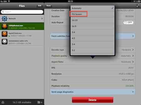

The current version (3.8.1) available in AppStore, unfortunately, doesn't support stretching. However, the developers have already implemented filling in their closed beta version. Let me present you two screenshots of the (internal) version already supporting screen fill:
(it's here (see the annotation by a red rectangle) that you'll need to activate fill. Note that this option is still not present the official version.)

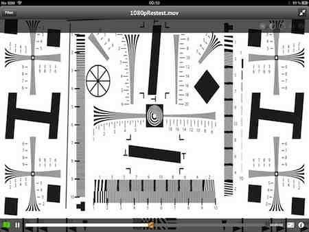

(and the results are properly stretched vertically)
