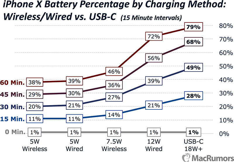

#1 - Historically, there has only been a minimal difference between the 12w & 18w adapters in charging speeds. See this report that was done by MacRumors with the iPhone X. Starting from 0%, the 12w charger achieved a 72% charge after 60 minutes. The 18w charger achieved a 79% charge after 60 minutes. That's a pretty negligible difference as far as I'm concerned. For comparison, the 5w adapter only achieved a 39% charge after 60 minutes. Link: https://www.macrumors.com/guide/iphone-x-fast-charging-speeds-compared/
Bingo, it's not going to be a huge difference, and it will be blunted since the battery capacities have grown in the new Pro models, at least unofficially. (11 = negligible difference, 11 Pro = +20%, 11 Pro Max = +10%)

No risk to other Apple devices at all. For a comparison of charging speeds, take a look at this MR article and the two graphics
posted from it below: https://www.macrumors.com/guide/iphone-x-fast-charging-speeds-compared/
