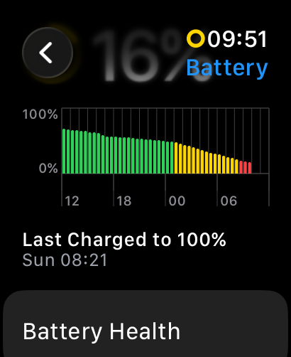

Ultra 2 left unused on a drawer drains way more battery than normal? After the first time few days ago I gave it another try. Next 3/4 nights were pretty normal but here we go again. You may ask why I didn’t put it on a charger. Well. I am not a fan of charging it to 100% if I don’t have to. Beside I can take my watch for a weekend without any charger and I don’t want to see dead battery at the morning.
I’ve never experienced that before watchOS 26 update.

View attachment 2561331Ultra 2 left unused on a drawer drains way more battery than normal? After the first time few days ago I gave it another try. Next 3/4 nights were pretty normal but here we go again. You may ask why I didn’t put it on a charger. Well. I am not a fan of charging it to 100% if I don’t have to. Beside I can take my watch for a weekend without any charger and I don’t want to see dead battery at the morning.

iPhone 16 Pro with iOS 26 is pretty ok. I didn’t see any draining. I performed hard reset on iPhone but not on Apple Watch. I gave it a chance to index everything. I thought it was enough when next 3/4 night were fine. Unfortunately I was wrong. Today I hard reset AW and we will see.
Most app have background activity turned off. Not all of them but nothing has changed since previous watchOS. I don’t add any app etc.

Here we go again. Latest watchOS. Performed hard reset. And again 2/3 night with regular 7/8% drainage and then boom nearly 30% the next day. I will call Apple because something is off and now idea what it can be

Two days ago I saw that after a shower my watch lost 4-5%. So again something was wrong. I turned off wifi and it worked. But I wasn't sure if it was a wifi or just taping my watch. I made a phone call with Apple yesterday and they saw that something is off with battery. It looks like device is trying to sync something but they don't what. Maybe they need logs for that. Anyway they suggested to change region to US and back to native one.On iPhone and watch. Assistant said that it resets most stuck processes in the background. After that I left Ultra 2 for a night and it was fine but it's too soon judge

anyway. It looks like a tip from technician helped. I didn’t see any extended draining.
