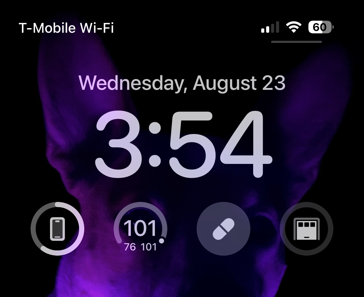

I use the action button to open/close my garage door when I'm riding my motorcycle. I wrote a shortcut to control the opener in the Home app.
Now that’s cool! Does your watch have an app that controls the garage door, or are you somehow triggering something on your phone that does the communication, or … ? Also … will it still open the door even if you’re miles away? That might make me nervous … an accidental press somewhere and you don’t even realize that the door is open …

It works from anywhere through the internet.
Modern Chamberlain/Liftmaster garage openers are internet-connected with their MyQ tech. My Liftmaster opener is older without that built in, so I bought their wall button panel and home bridge to MyQ-ify my opener. That works both with the Chamberlain MyQ app for iPhone and Apple Watch, and also lets you integrate it into Apple HomeKit.
The shortcut goes: action button -> shortcut -> HomeKit -> internet -> HomePod -> Chamberlain bridge (callback to the Chamberlain cloud APIs too) -> Chamberlain wall panel to trigger the opener. It works with Siri too, and I could theoretically set up automated scenes, like flipping on lights and setting the thermostat. HomeKit sends me notifications whenever the door is opened or closed (configurable to turn that off).
The Chamberlain cloud servers also can trigger notifications that go to iPhones via the MyQ app if the door is open for too long. In my case, I live in a 3 unit building, and have my neighbors on the app too, so we all get a notification for the door being opened for too long.

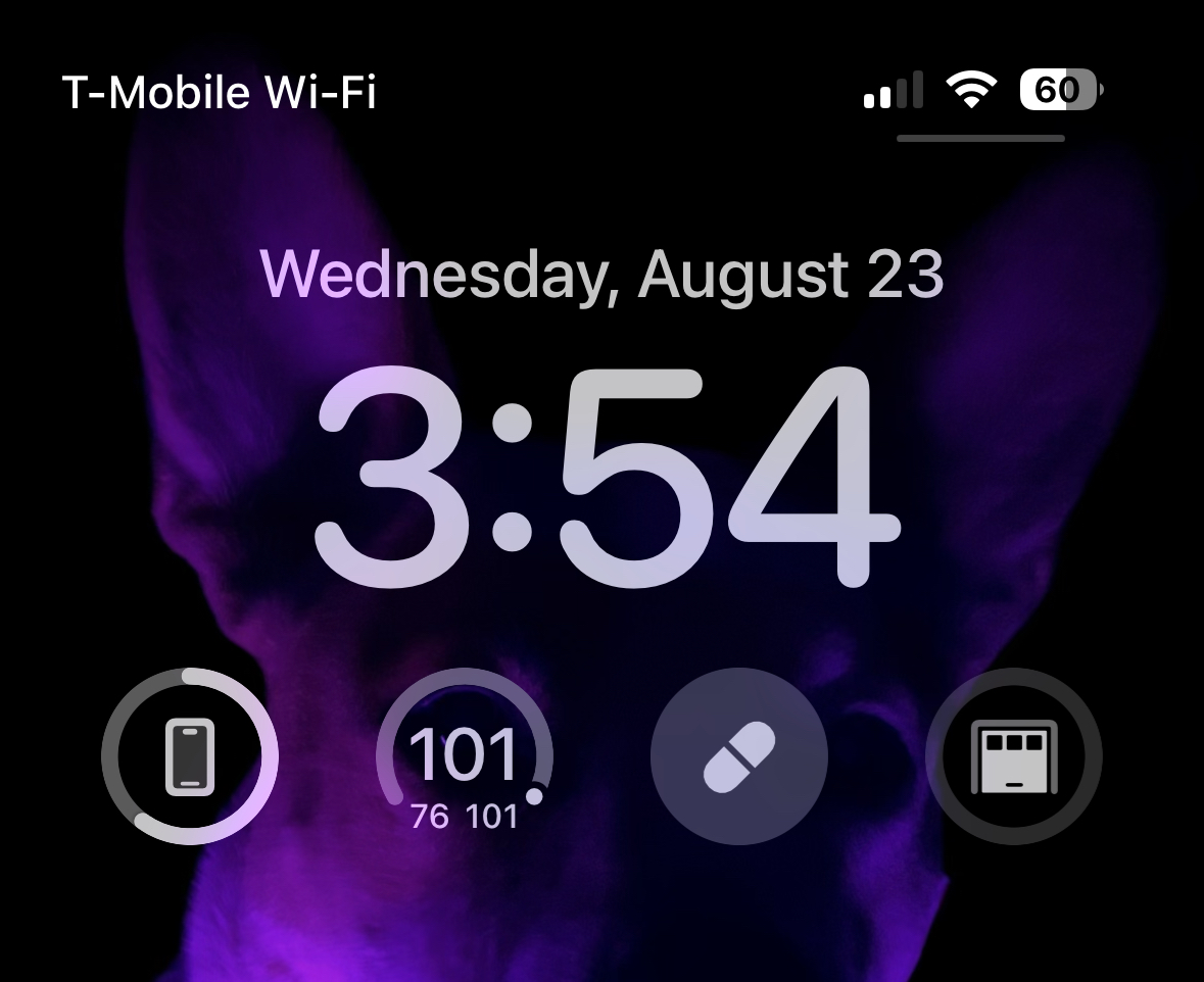

One last bonus feature with the MyQ app is the lock screen widget for door open/close state (the fourth icon in this image).
