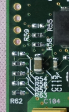

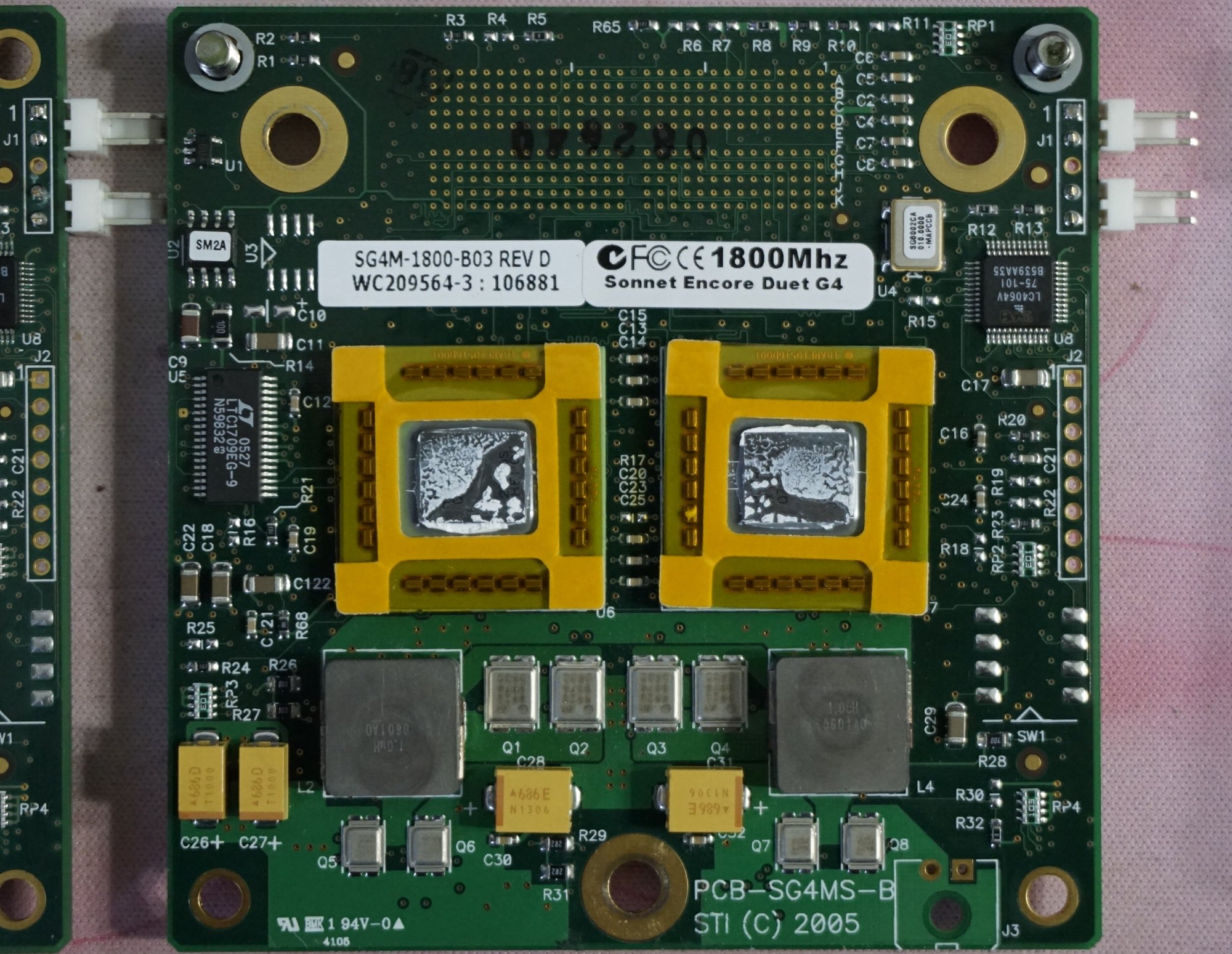

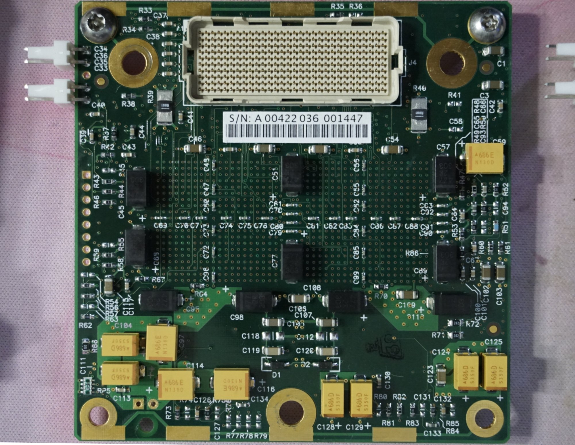

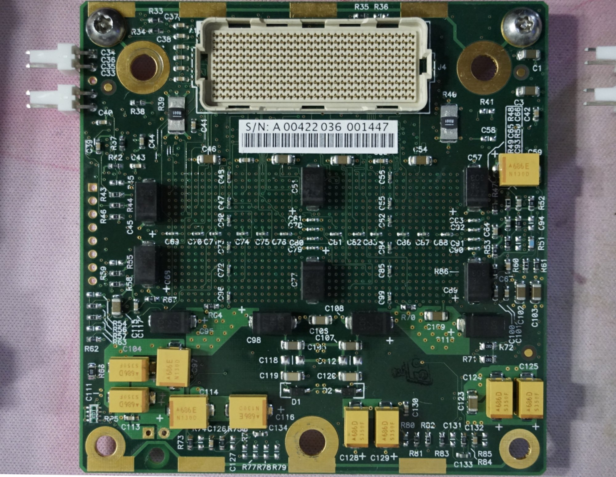

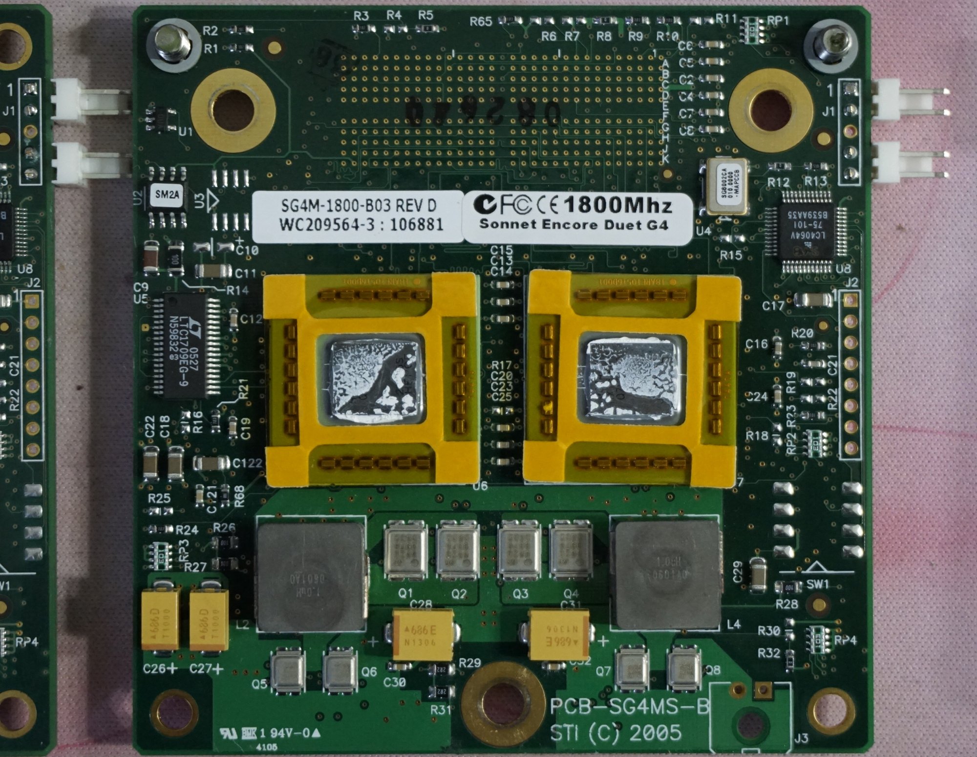

I was able to both underclock and overclock by changing specific resistors, so I'll dump that information here. There's probably more configurations but I'm not skilled enough nor do want to push my luck :p Here are some high res pics of both sides on the working Duet, as well.
Sonnet Encore Duet 1.81.41.51.8 (original)2.0
R55-
R56----
R57----
R58--
R59---
I'm not sure how relevant R56 or R57 is, my machine refused to start with either of those changed.

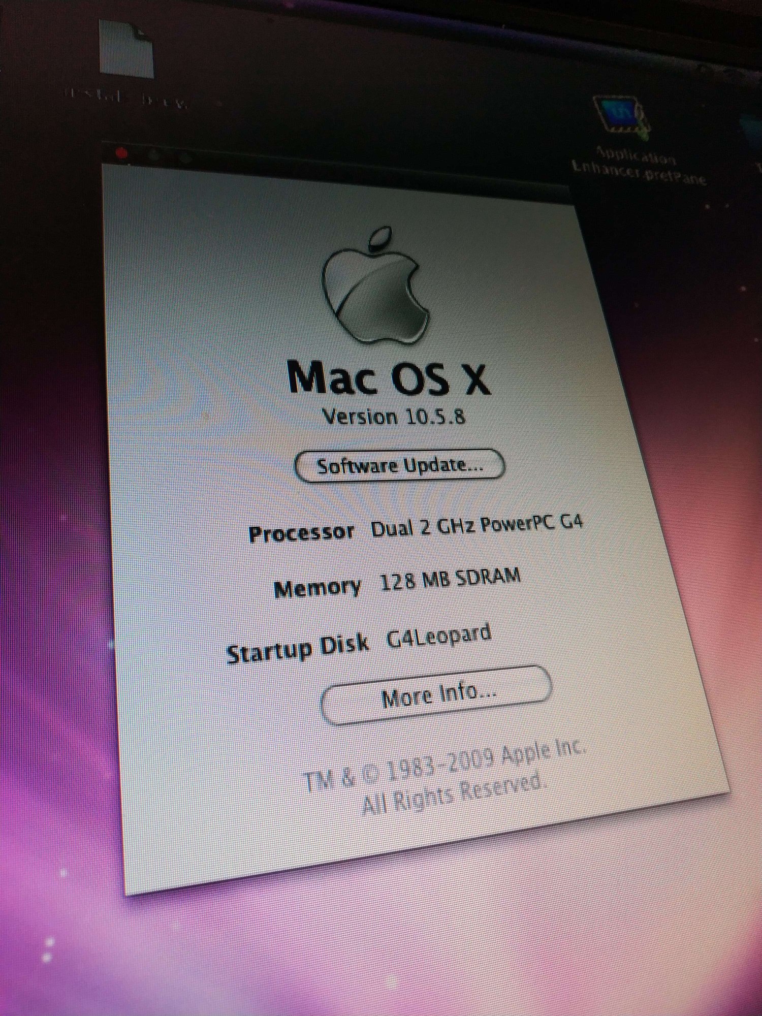

In the end, underclocking the broken Duet didn't fix the memory errors, but it did delay the error from appearing. The problem seems beyond what I'm able to fix... so instead, I felt gutsy enough to try and overclock my working Duet. To my surprise, it started without issues and gave me the sweet number 2.

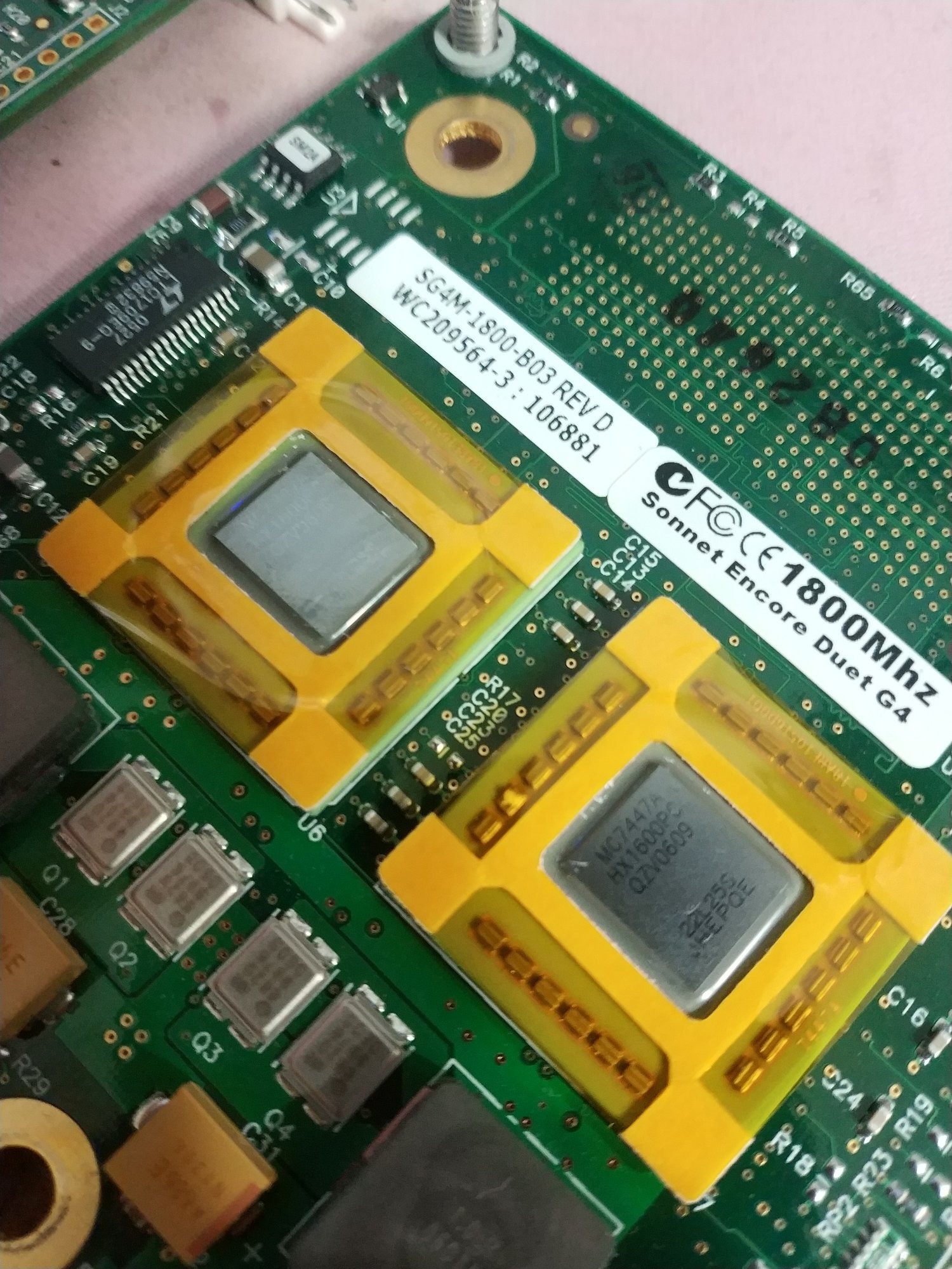

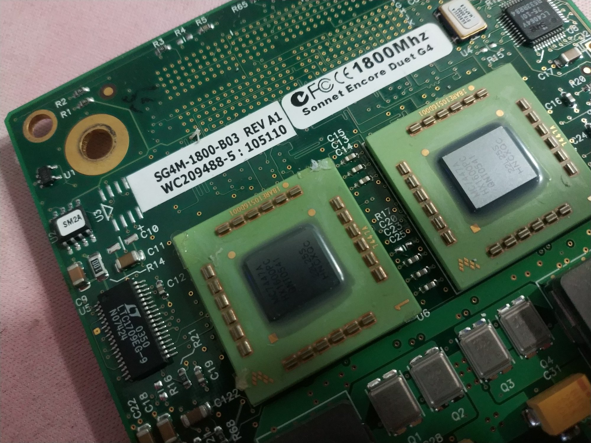

Additional notes.
Both of the Duet's were of different revisions, as indicated by the stamp on the copper heatsink. My working one is revision C, while the broken one (given by a friend) is revision A. There is only one difference (that I could see) between the two revisions: the resistor R60 (righthand on the connector side) is bridged on rev C but not A. I bridged it on A and it didn't break or affect anything. Given that it's under the voltage regulator (i think that's what it's called) it probably does something related to it.

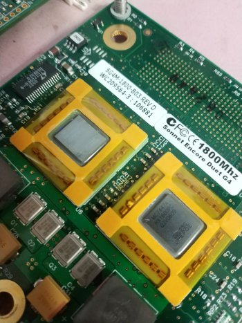

Thank you for sharing your results, pictures, and linking that other thread! Did you happen to note the markings on the CPU chips? I think most of the sonnet upgrades are overclocked based on the motorola markings.
On your broken upgrade card, what happens if you disable one of the CPUs?
Thankfully, I took pictures after cleaning off the paste. I'll embed them here. Looks like my working one is "MC7447A HX1600PC QZV0609" and the broken one "MC7447A HX1600PC GNT0541".
As for disabling a CPU, how could I do that?
Easiest way is in open firmware:
Code:
setenv boot-args cpus=1
Or same thing from a command line. To clear it, something like:
Code:
sudo nvram boot-args=""
I think you could also do it with the CHUD processor preferences pane.
If that fixes the problem, then I'd say that the second CPU chip has a defect of some sort.
Reactions: Amethyst1
Welp, I guess the story is cut short (heh) here. I was about to try, but the cpu board accidentally made contact with the main logic board and got fried :/ at least it died an honorable death...
