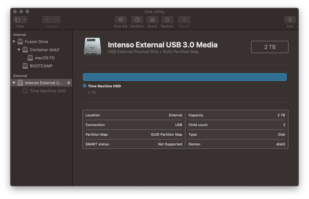

Until today, I used 10.14.5 and Time Machine worked. Then, I installed 10.14.6 (due to macOS's annoying "reminders") and now Time Machine doesn't work anymore. To be more precise, the Time Machine drive doesn't mount. The drive does appear in Disk Utility (see attached screenshot) and First Aid shows no errors.
I also tried several USB ports and reset the PRAM without result.
Did/does anybody have the same problem? How can I solve this?

I called Apple support. After an SMC reset, trying Recovery Mode, Safe Boot mode and several other things, the employee gave up and said I should reformat the HDD. I did that and now my first Time Machine backup failed after reaching 99% with the message "Unable to complete backup. An error occurred while creating the backup folder."

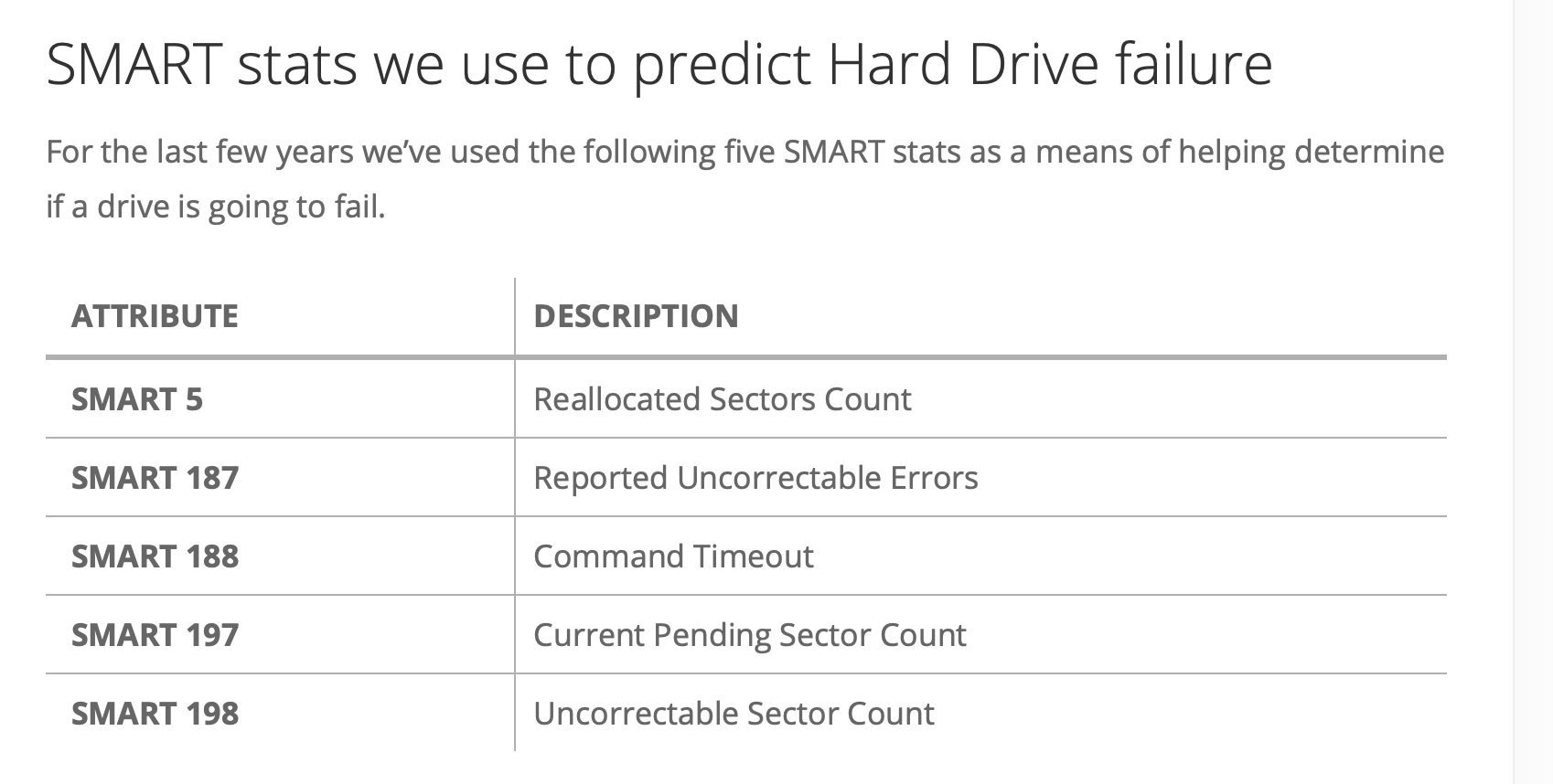

There are some third party utilities like this:
Thanks again for your help. According to DriveDX, the external hard drive which didn't mount for a while and which I suspected to be damaged, is in perfect health (100% for all indicators). If that is true, then I wonder why macOS couldn't mount it and, when it was finally mounted, couldn't unmount it. Seems like a macOS bug.
