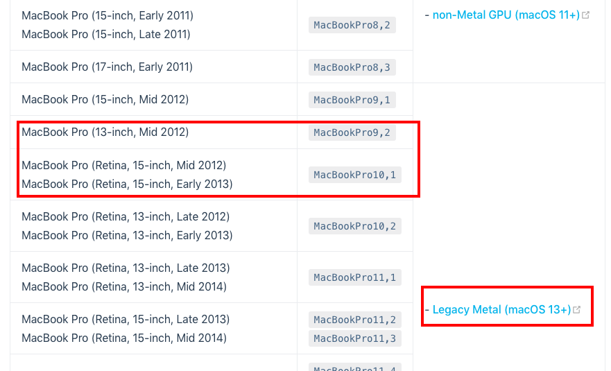

The safest way to do this is to download the Ventura OCLP, and create a bootable USB following the instructions on their site. Then do the install from there by clicking on the patched installer.
If you don't use the Ventura patcher and instead do an in-place upgrade, you will likely have extremely slow performance due to the lack of proper graphics support ("legacy Metal") and hardware acceleration.
Legacy Metal Graphics Support and macOS Ventura - Sonoma #1008
Download and build macOS Installers

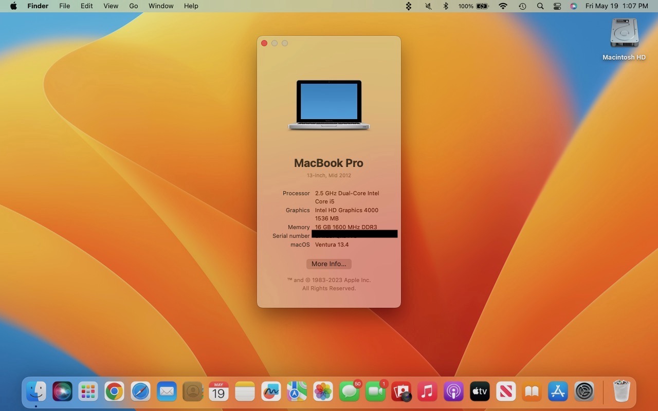

I cannot answer if "all" apps work, but all the ones I use work on my 2012 MD101LL/A (last one with upgradable RAM and DVD burner). I did this back in May hence the old screenshot.
If you're not sure, it might be better to install it to an external SSD or hard drive to test everything after installing.
