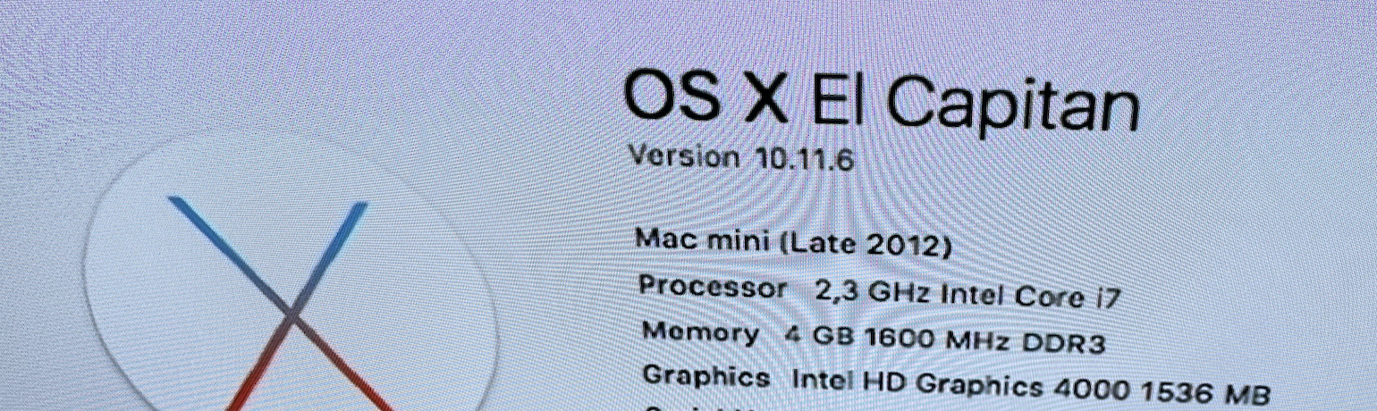

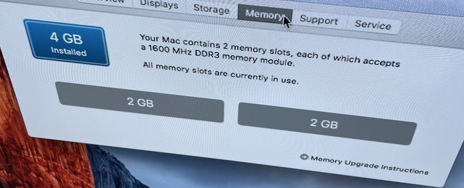

I recently purchased a 2nd hand Mac Mini late 2012. I am thinking about upgrading some of its parts, but would like to hear your thoughts and suggestions. Thanks a lot in advance!
1) Memory: It has 2x2GB = 4GB of 1600 MHz DDR3 memory at the moment. I'd like to increase this to 2x 8GB = 16GB of memory, but where can I buy these memory blocks? Are they still being sold? Any suggestions would be greatly appreciated!
2) OS: The Mac Mini is currently running OS X El Capitan version 10.11.6. Do you recommend that I upgrade the OS to, say, Catalina?

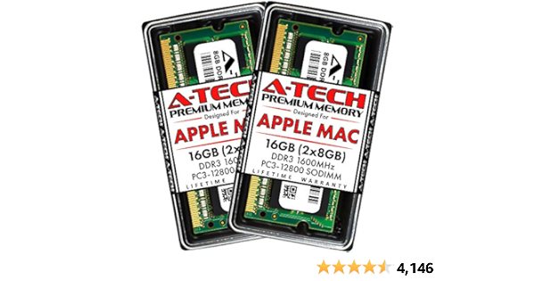

memory at Amazon. cheap. easy return policy.

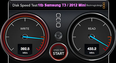

For comparison, my 2012 has an original Apple internal SSD and this is what I get
Here's the 1tb Samsung T3 external SSD. From a user perspective, the external SSD really "feels" just as fast. The only difference I noticed was that it takes longer to boot. But there's no "installation", just plug it in. :)

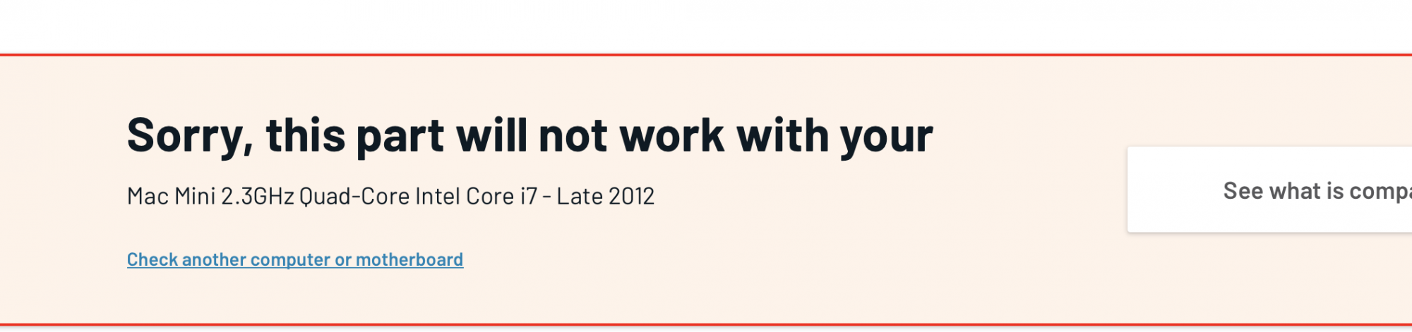

Thanks for all the input. I'm going through them all right now, starting with finding new RAM sticks.

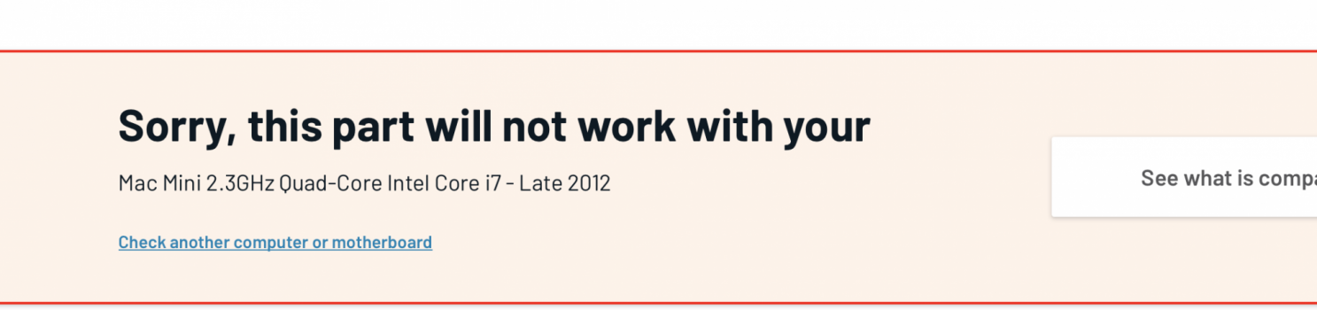

I found these (CT2KIT102464BF160B) by Crucial. On Amazon many customers say that they have successfully installed it in their Mac Mini late 2012, yet on Crucial's on site it says the RAM is not compatible with that model.
Do you know why that is the case and if they do/don't fit?
I don't live in the US, so buying OWC from their website is unfortunately not an option.

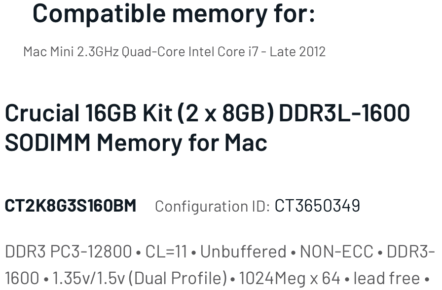

Crucial should allow you the option to scan your Mac and suggest the appropriate hardware.
I have entered the details manually and this is what it suggested:
However there are others that are equally compatible so I wouldn’t know about the ones you suggested.

8GB RAM is a minimum recommended IMO. I have one 2012 with 10GB (8+2) and one with 16GB.
