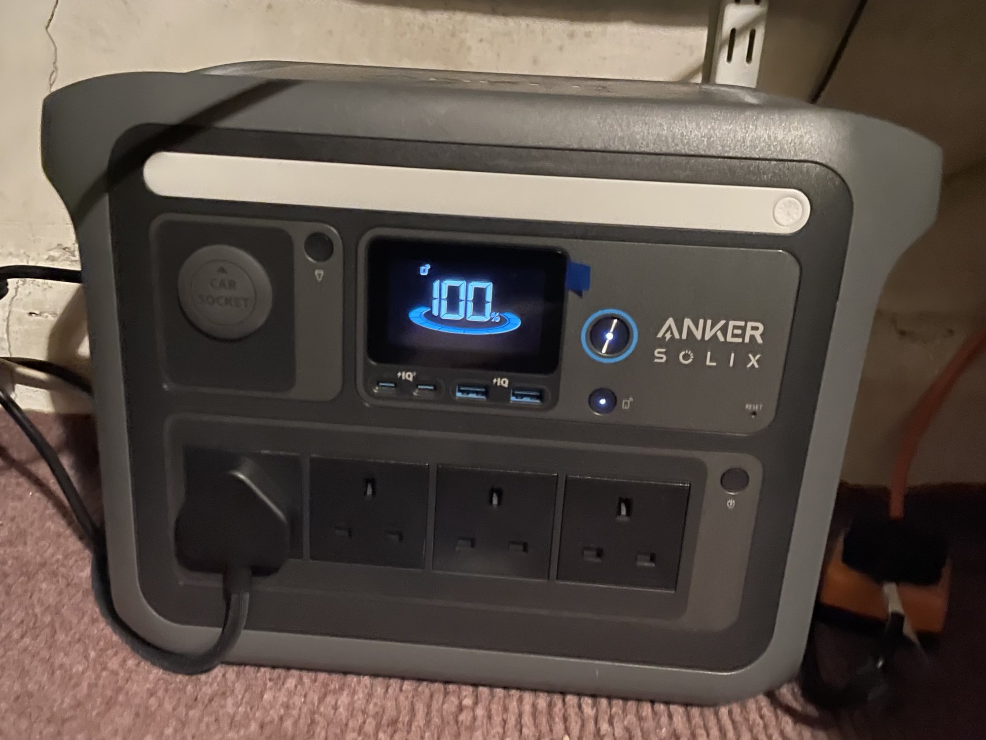

I’m aiming to do some LLM fine-tuning with my Mac Studio, which will likely require it to run 24/7 for several days. So I thought it’d be wise to look into getting a UPS.
I used UPSes many years back, but got disillusioned when the batteries died within 2-3 years without ever requiring them to fulfil their purpose.
Good to read that battery tech has improved since, and I ultimately decided on one of these:
The Anker Solix C1000.
Received it yesterday and tried it out last night. Works fine.
And it doubles as a battery backup in case we really have a power failure and desperately need to power something up.
These can be pretty pricey, but I don’t think they ever sell at the RRP (£999). The price seems to swing between £699 and £499. With 5% off for signing up, that made it £474. If it lasts the 10-years they claim, that makes it very affordable (about 91p/week).
I’m interested in what other people use, and what prompted you to want/need a UPS.

These things are supposed to last 3,000 cycles. Yes, it’ll be plugged into the mains when the Mac is in use.
The monitors are not plugged into the Anker, but I have a 16” USB monitor plugged into the Mac for use when I just want to monitor its progress.
I think the technology in LiFePO4 batteries is pretty good for this kind of thing.

The Anker doesn’t have a means to tell the Mac/PC to shut down when the battery is low, so that’s certainly something to be aware of for anyone who needs that facility. You can monitor it via its app, though.
Also, Anker only states “<20ms” for UPS use - which is fine for modern stuff like the Mac, but a true UPS (like yours, undoubtedly) will quote <10ms.
I also have a “backup” backup method in place. When I’m fine-tuning the LLM, the script saves the checkpoints every 30 mins so, should the Anker fail, or it’s just used for too long for the battery capacity, I should only lose 30 minutes of work. For anything else, like you, I frequently save everything (and important stuff goes either to the cloud, or GitHub).
It's been interesting to watch the AC output on the Anker app. When the Mac Studio is just doing "normal stuff", it takes around 25W but, as soon as you get it working hard, it ramps up to 140-150W (StableDiffusion image generation) and 120-130W (LM Studio). That probably explains why my MacBook Pro's battery doesn't last long when I'm using it for LLMs.
