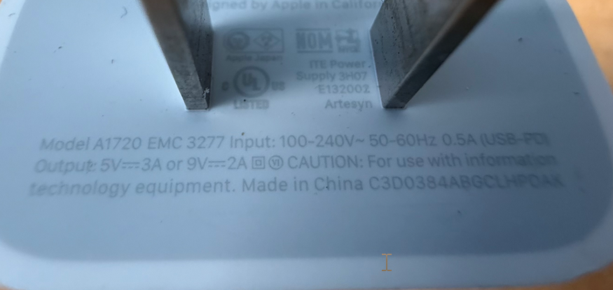

You can also use an outlet adapter, you can buy these at many travel stores, they simply convert from the UK plug to the US plug and work with whatever you have, but with the caveat that the adapter has to support the input voltage which is 230 volts. Most power bricks do have different voltage support, however, the Apple adapters do, just do a safety check by reading its label or manufacturer documentation.

The vast majority of consumer electronics, just about anything with a power brick, can handle any line voltage from 100 to 240, covering both North American and everywhere-else standards including the UK. (North American standard household voltage is 120v and most of the rest of the world is 230v). If in doubt read the very fine print on your power bricks, it will tell you the voltage range it can handle. If it goes to 230 or 240 you're good.
