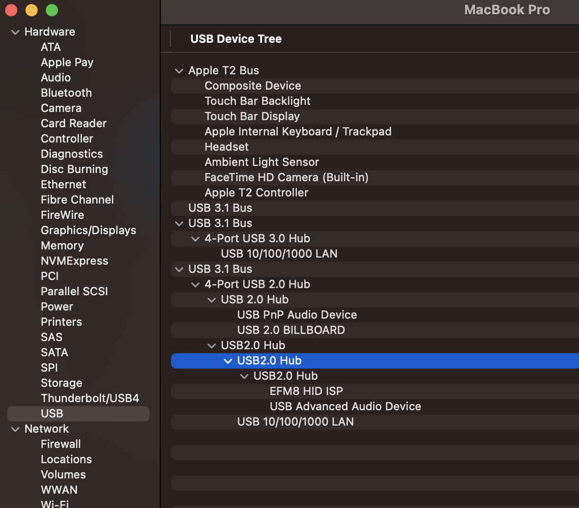

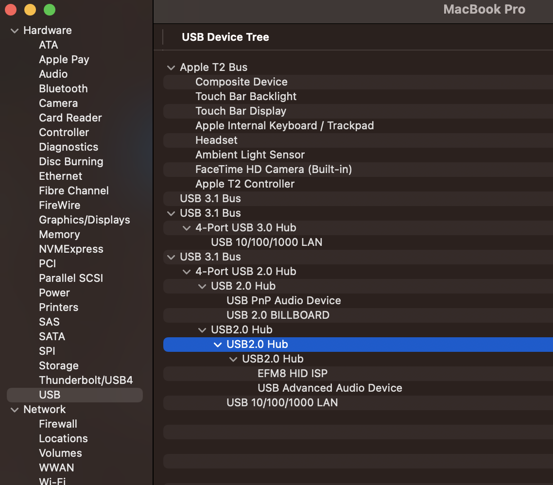

Now here is the strangest thing:
I found a USB-A to USB-C cable, so I connected it to an old Windows laptop (USB-A port on the computer to USB-C port on the "computer" port of the Icy Box dock. Now the dock works, but of course only with limited functionality, since USB-A does not support alt-mode and thus no display output and also no charging. Therefore it is not an option for the Macbook, but confirm that the data part of the dock works.
I then connected my older I-tec C31NANODOCKLANPD USB-C dock in the following way:
Macbook Pro -> I-tec dock -> USB-A to USB-C cable -> computer port on Icy Box dock
(No this is not pretty.)
Then the following showed up:
This shows the gigabit ethernet and the audio device from the Icy Box dock (below the selected line, while the ones above are from the I-tec dock). There is also an EFM8 HID ISP which after some searching online seems to be an 8-bit microcontroller, but how it is used in the dock is beyond me.
This means the dock works with Mac OS, just not using the three USB-C cables that I have.
Maybe it is indeed worth looking for a new cable, but again, can the cable specifications actually be confirmed before buying it? It is not often shown in specs, and some may even be mislabeled, in particular cheaper ones from less well-known brands.
(On a final note I believe that the fact that all the devices from the dock are listed as USB 2.0 devices (max 480 Mbps) is because my USB-A to USB-C cable is most likely limited to USB 2.0 speeds.)
