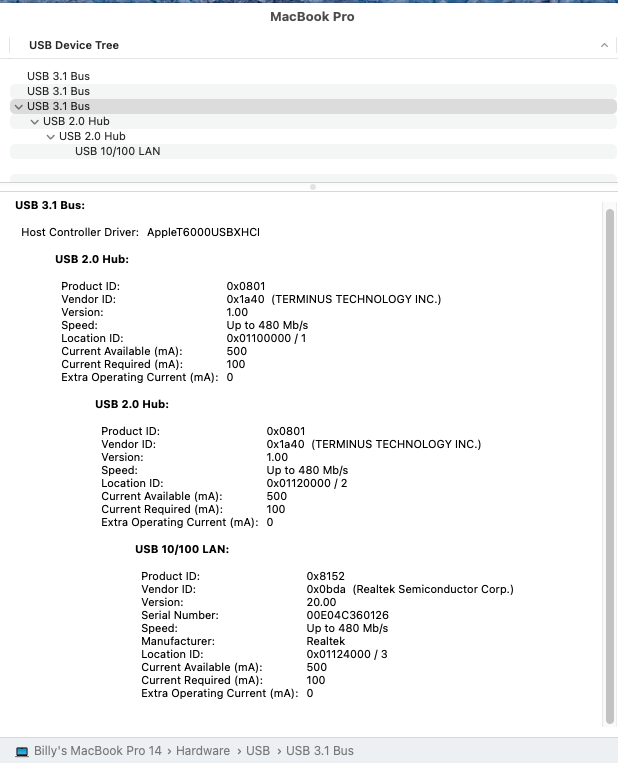

I've been struggling with the speed of my external hard drives (max 30mb write speeds!) ever since I upgraded to a macbook with only thunderbolt ports, and I think I've just found out why. The usb-c to usb 3.0 hub that I bought, despite being very clearly advertised as supporting Super Speed 5gbps USB 3.0, is only being recognised as USB 2.0 by OSX. I've seen another couple of threads on here from a while back with people having similar problems, but no good explanation or fix.
To clarify, I have a 14" macbook pro with M1 Pro chip and OS Monterey. The hub is an OEM device off ebay, identical to this one: https://www.ebay.co.uk/itm/184984909798
When connected, even with no drives or devices connected to the hub drawing power, it shows up as this in System Report:
When connecting a USB 3.0 drive using a proper cable, it shows as this:
So it recognises that the drive is USB 3.0, but still shows its speed as 480mb/s as it's connected via what it says is a USB 2.0 hub.
My first thought is that the manufacturer of the hub is just a dodgy dealer and has cheated me, but some of the other posts about this issue suggest that even when buying more expensive, branded products like the similar Anker hub, the same problem occurs.
