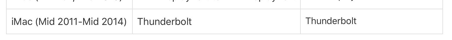

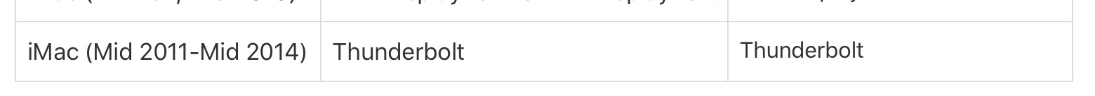

I believe the support page does include the 2013 iMac. The range of "iMac (Mid 2011-Mid 2014)" reads to me as iMac (Mid 2011 to Mid 2014) which would include 2013.

You're right...I misread that.
