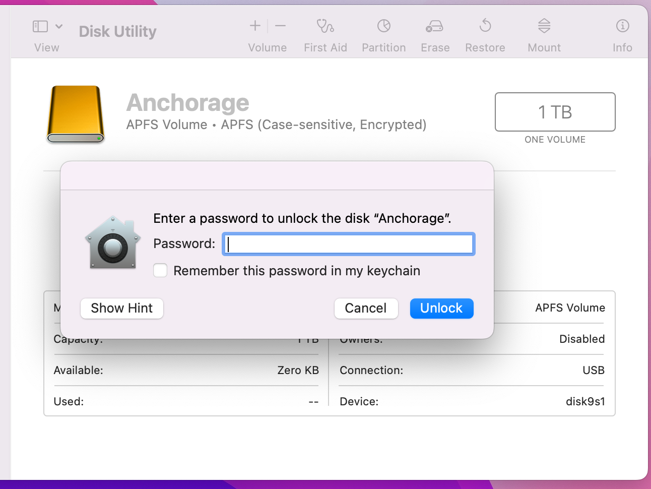

I have an external, non-bootable drive that is Firevault encrypted. My password doesn't seem to be working.
I have a number of possible recovery keys to try, but none of them work when just trying to mount the drive to the desktop, or when trying to mount the disk using Disk Utility. They may not be the right key, but I maybe I am doing something wrong.
With respect to my specific situation, an external, non-bootable drive, when and where are you supposed to be able to use a valid recover key?

  • Should it work when turning on the drive and it tries to mount it?
  • Within Disk utility?
  • Reboot into recovery mode and try it there?
I really think one of these keys should work. But then, I although really think my password should work too.

"I have an external, non-bootable drive that is Firevault encrypted. My password doesn't seem to be working."
Filevault-encrypted?
And... the password you have won't work?
Then... forget about it.
You're not getting that data back.
I could be wrong, but that's pretty much "the end of the story".
This is why I DO NOT USE Filevault.

Total non-answer to my question.
"Total non-answer to my question"
Look at your original post.
I see a dialog that is requesting entry of a password to unlock the drive in question.
If the password you have won't work -- if it won't unlock the drive -- then you're out of luck.
Without the correct password, I believe the correct answer is:
NOTHING will make that drive readable again.
Where, specifically, was I wrong?
(others please jump in and correct me)
@Fishrrman is correct: you're out of luck.
First, it's an external drive, so not FileVault encrypted, just "plain" encrypted, so recovery keys do not apply in this case. And since you don't know the password, did not save it in Keychain, there is no option to reset the password without wiping the drive.

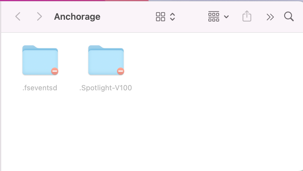

Well, not so much. I correctly guessed my password. However, there is nothing on the drive.

I THOUGHT all of my backups were on this drive. But it's empty. So that leaves the question, where are all my backups?

Well, mystery solved.
Long story short, I kinda randomly discovered that 2 years ago, I ordered an 8TB drive from Amazon. I found the drive in my vault room. I have not turned it on yet (another long story), but it is labeled "Master Archives 02/18/2021".
I totally do not remember ordering this drive, or doing the work - but apparently - two years ago I decided to consolidate all of my various "micro-sized" drives with backups everywhere into a single large drive. I must have erased the "source drive" Anchorage in the process, since I had everything off it.
