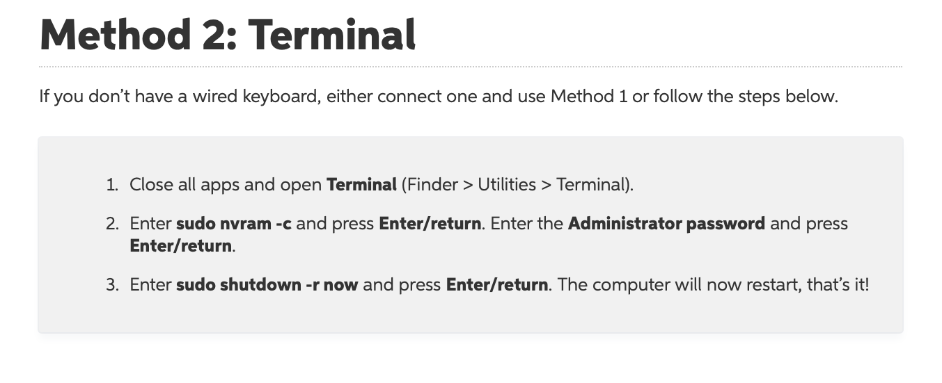

Hello everyone,
I have a 2020 27" iMac with the T2 chip running 11.1. I cannot reset the PRAM/NVRAM using the keyboard no matter what I try. I've read that you can reset it in Terminal. However, I'm concerned about doing it until I can confirm that these are the correct sudo commands. Can someone let me know if they are? Thanks.

Always a great idea to keep a wired kb and mouse on hand for installations etc. That looks correct, have a read of this on the subject:-

Edit: I tried it and received the following error:
nvram: Error clearing firmware variable fmm-mobileme-token-FMM: (iokit/common) not permitted

Do you have a firmware password and/or is the computer signed in to Find My Mac?
If so, the NVRAM reset won't work with a firmware password, and FMM above refers to Find My Mac.
