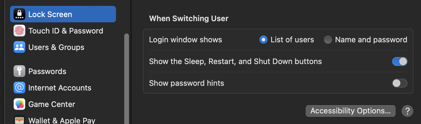

I can't figure out how to keep my 'User Name' saved on the lock screen. When I reboot computer I have to type in the user name with correct capitalization, and password? I don't remember ever having to type in the user name on previous OS's. I tried the settings in Users and Groups. Is it because I have FileVault on? Thanks!
It was set to list of users originally. I tried switching it to Name and password and nothing changed. I just changed it to list of users, again just now, and it started working correctly!!! I was on the Ventura betas and maybe it was a bug that just stuck around. Thanks for the help, as this did make it work!!!
Reactions: BigBlur

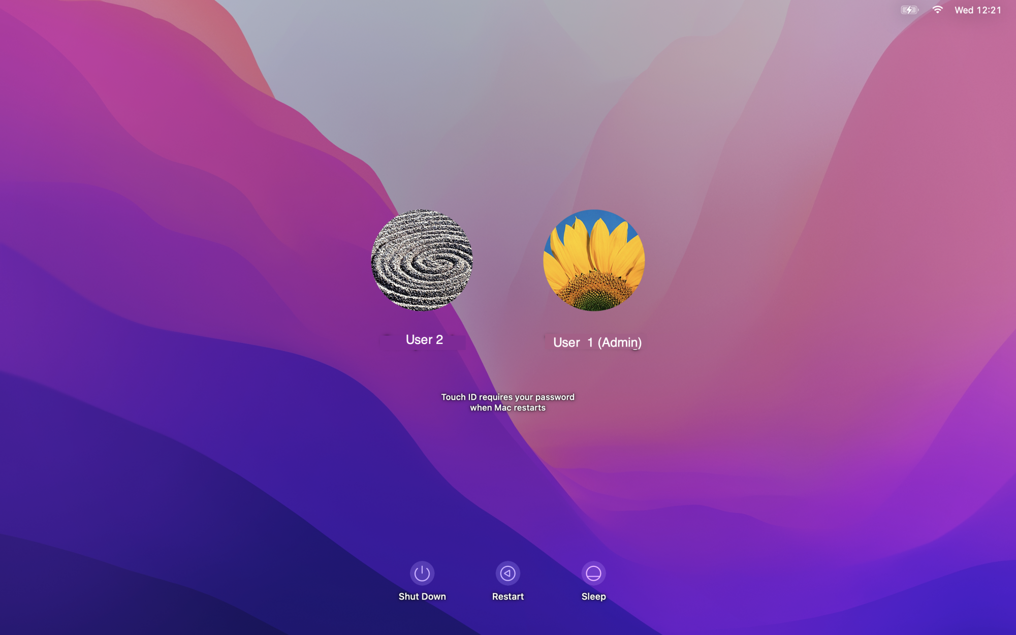

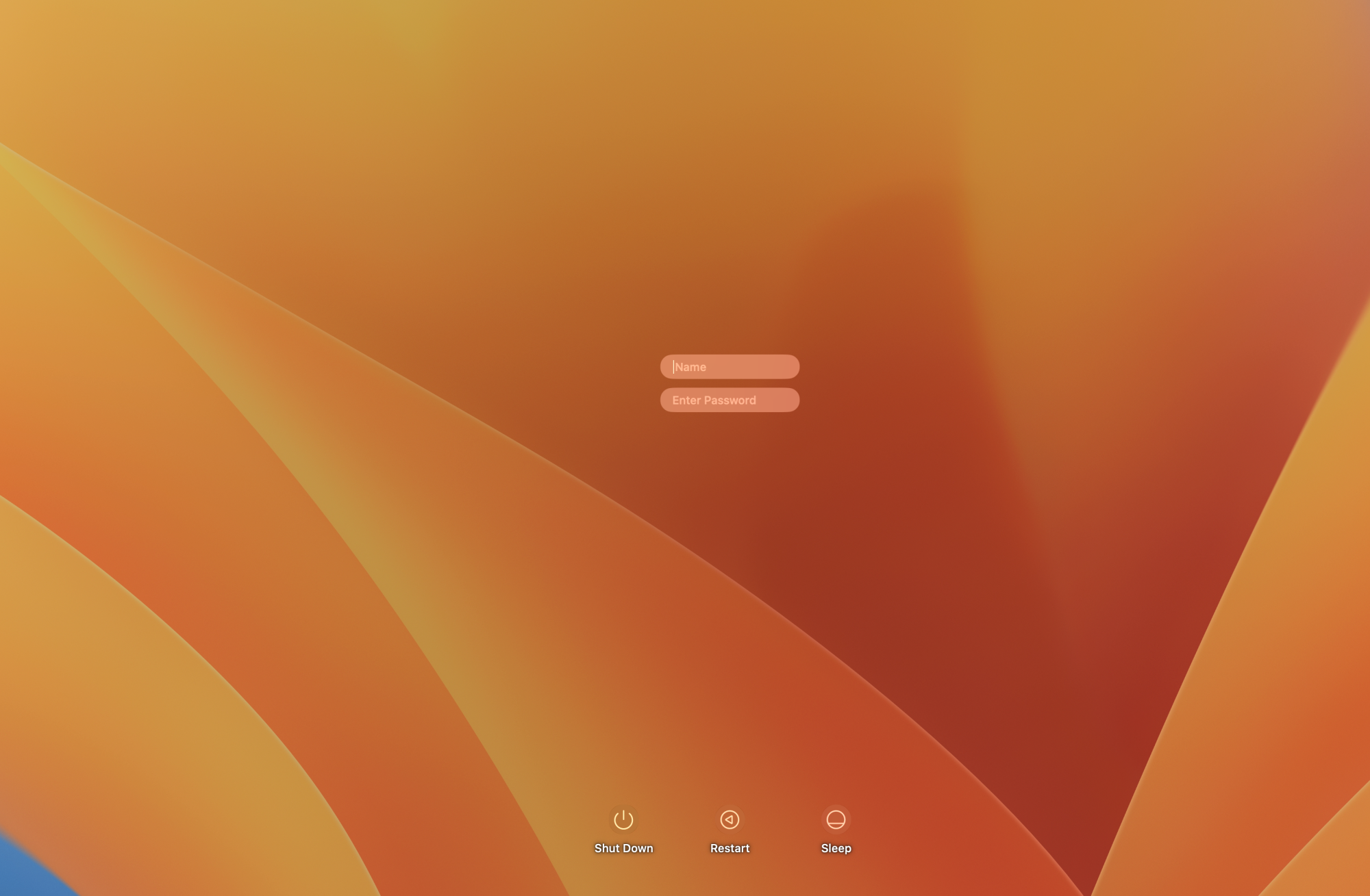

I seem to have the same problem as the first post in this thread – or even worse. Under Ventura the LockScreen looks exactly the same as in the first post. On my previous MacBook under Monterey it looked as shown in the attached screenshot. In System Settings the LockScreen option is set to List of Users. I have tried to follow the above advices without success.
With this setting I can start as either user but it is impossible to switch between users.
