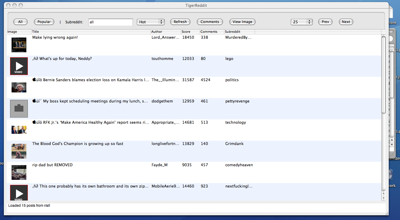

I had a bit of free time and wanted to see if I could make a reddit viewer for MacOS Tiger. I mainly know web development, so I basically just used Claude to make this, but was still fun trying to make it work. There are quite a few bugs currently, like you can't view comments if a post has more than about 20 comments and you can't open articles. If your screen size is small, you also may not be able to click the Previous and next buttons; I'll have to work on a fix for this.
However, you can navigate most subreddits, download full sized pictures and videos! If you get any crashes let me know and I'll try and look into it.
If you know Objective-C code better than I do and want to make some changes feel free to make some pull-requests on github or fork it.
The code is public here: https://github.com/harryfornasier/TigerReddit
MacintoshGarden link: https://macintoshgarden.org/apps/tigerreddit

I have seen a few weeks ago someone shared a CLI Reddit client in Python (which presumably should work on ppc) on r/commandline, but Cocoa is more fun.
BTW, would we get improvement building against 10.5 SDK?
Tested and working (apart from the off screen buttons) on my 12" Powerbook - well done.

Yeah was interesting to try and build something in Cocoa. No I don't think there would be any improvement.
