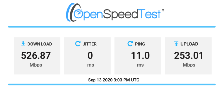

I'm in a rural location and DSL (that maxxed out at about 0.6 mbit) was all I could get for the first 12 years in my home. Then an army of Verizon installers descended on my little town and suddenly I had 150/150 mbit service (the fastest they offered at the time). I was uploading 1gb videos to vimeo.com in about 1 minute.
Last winter I upgraded to 400/400 mbit FIOS which didn't cost any more. Recently, they gave me an unsolicited free trial of gigabit FIOS but I didn't feel the increase was worth the additional $20/month. Anyway, there are lots of different ways to check speed, but just for fun I used OpenSpeedTest and got the following from my 2018 Mini with hardwired gigabit ethernet

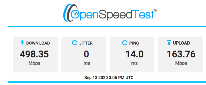

And this is what I got on my 2013 MacBook Air connected to an Airport Time Capsule with 802.11ac wifi
As they say, "your mileage may vary" but I'm convinced that a hard-wired ethernet connection is better. Also makes a big difference copying files between network drives on my LAN. Of course, the OP has not given us enough details about his setup to know whether it would help in his case.

First, some nice upload speeds. So wish we had fiber instead of a copper cable.
Also agree about ethernet. When I run Time Machine (writes to NAS) and the backup size is much over a Gigabyte I plug my ethernet adapter and cable into my MBP.

Testing with a server on the local LAN will show a difference vs going over the internet
The results I posted were done over the internet using the MCI Communications Services (Verizon Business) server in Philadelphia, which was the default for that speed test. I get about 800 Mbps accessing a 2012 Mini Server over my LAN, but that is something completely different.
